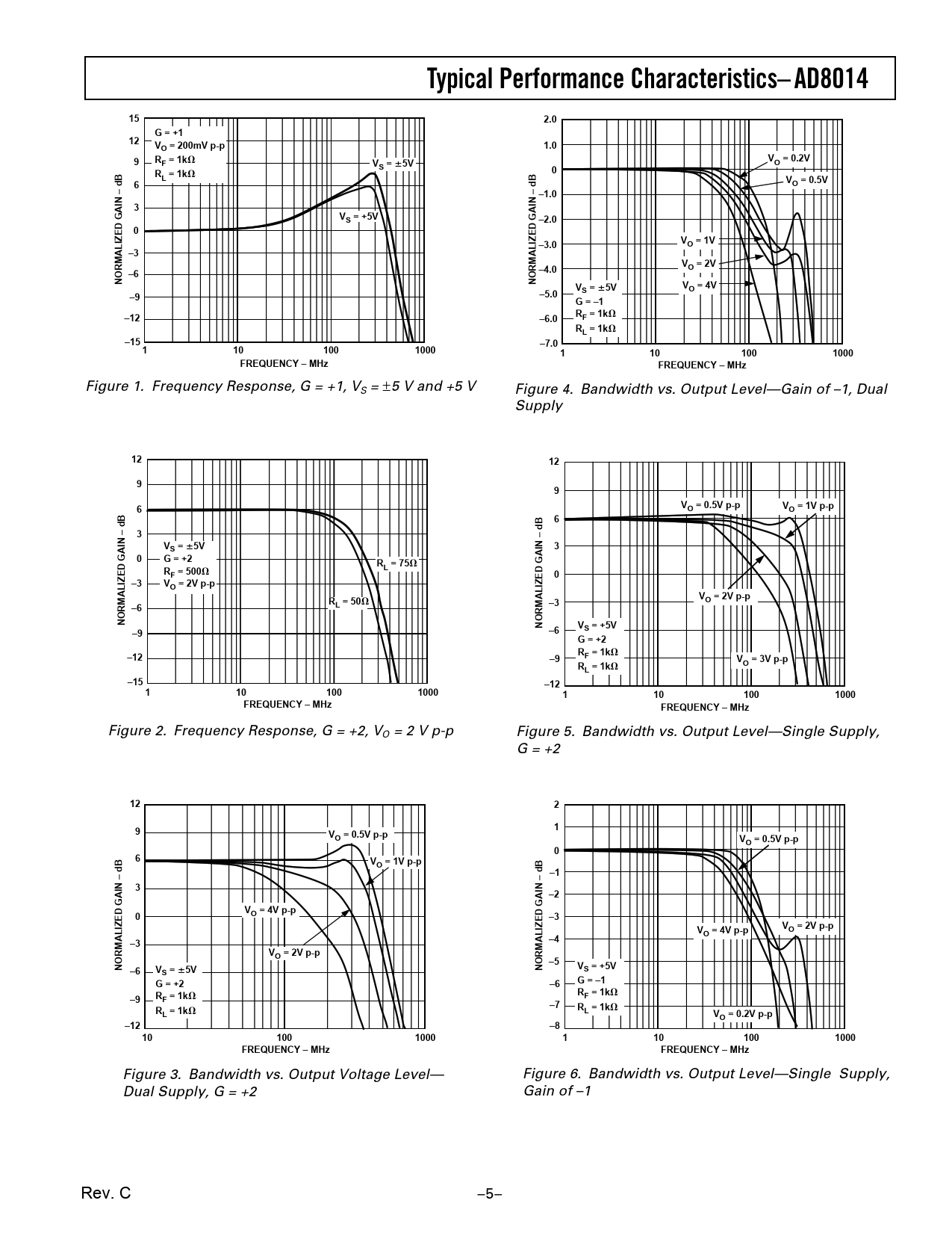

Typical Performance Characteristics– AD8014. 2.0. G = +1. VO = 200mV p-p. 1.0. RF = 1k. S =. O = 0.2V. L = 1k. VO = 0.5V. –1.0. VS = +5V. –2.0
Typical Performance Characteristics– AD8014 2.0 G = +1 VO = 200mV p-p 1.0 RF = 1k S = O = 0.2V L = 1k VO = 0.5V –1.0 VS = +5V –2.0
Typical Performance Characteristics– AD8014 15 2.0 G = +1 12 VO = 200mV p-p 1.0 9 RF = 1k
V
V V S =
6
5V O = 0.2V R 0 L = 1k
V
6 VO = 0.5V –1.0 3 VS = +5V –2.0 0 –3.0 VO = 1V –3 VO = 2V –6 –4.0 NORMALIZED GAIN – dB NORMALIZED GAIN – dB VS =
6
5V VO = 4V –9 –5.0 G = –1 –12 –6.0 RF = 1k
V
RL = 1k
V
–15 –7.0 1 10 100 1000 1 10 100 1000 FREQUENCY – MHz FREQUENCY – MHz
Figure 1. Frequency Response, G = +1, VS = ±5 V and +5 V Figure 4. Bandwidth vs. Output Level—Gain of –1, Dual Supply
12 12 9 9 6 VO = 0.5V p-p VO = 1V p-p 6 3 VS =
6
5V 3 0 G = +2 R R L = 75
V
F = 500
V
0 –3 VO = 2V p-p R VO = 2V p-p –6 L = 50
V
–3 NORMALIZED GAIN – dB NORMALIZED GAIN – dB V –9 –6 S = +5V G = +2 –12 R –9 F = 1k
V
V R O = 3V p-p L = 1k
V
–15 –12 1 10 100 1000 1 10 100 1000 FREQUENCY – MHz FREQUENCY – MHz
Figure 2. Frequency Response, G = +2, VO = 2 V p-p Figure 5. Bandwidth vs. Output Level—Single Supply, G = +2
12 2 9 1 VO = 0.5V p-p VO = 0.5V p-p 0 6 VO = 1V p-p –1 3 –2 V 0 O = 4V p-p –3 V V O = 2V p-p O = 4V p-p –3 –4 VO = 2V p-p NORMALIZED GAIN – dB –5 –6 VS =
6
5V NORMALIZED GAIN – dB VS = +5V G = +2 –6 G = –1 R R –9 F = 1k
V
F = 1k
V
R –7 R L = 1k
V
L = 1k
V
VO = 0.2V p-p –12 –8 10 100 1000 1 10 100 1000 FREQUENCY – MHz FREQUENCY – MHz
Figure 3. Bandwidth vs. Output Voltage Level— Figure 6. Bandwidth vs. Output Level—Single Supply, Dual Supply, G = +2 Gain of –1 Rev. C –5–
