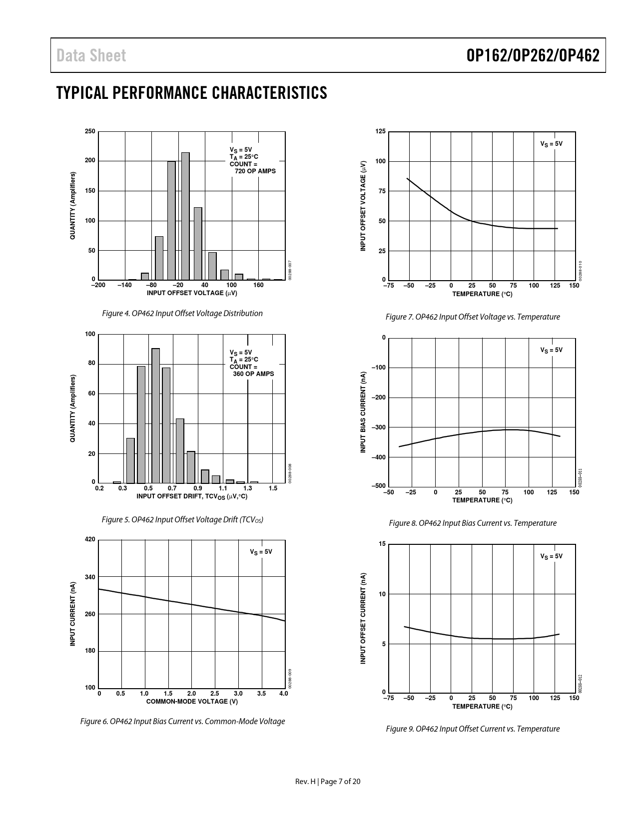

Data Sheet. OP162/OP262/OP462. TYPICAL PERFORMANCE CHARACTERISTICS. 250. 125. VS = 5V. VS = 5V TA = 25. 200. COUNT =. 100. 720 OP AMPS. 150
Data Sheet OP162/OP262/OP462 TYPICAL PERFORMANCE CHARACTERISTICS 250 125 VS = 5V VS = 5V TA = 25
C 200 COUNT = 100
µ
V) 720 OP AMPS 150 75 100 50 QUANTITY (Amplifiers) 50 INPUT OFFSET VOLTAGE ( 25 0
00288-007
0
00288-010
–200 –140 –80 –20 40 100 160 –75 –50 –25 0 25 50 75 100 125 150 INPUT OFFSET VOLTAGE (
µ
V) TEMPERATURE (
C)
Figure 4. OP462 Input Offset Voltage Distribution Figure 7. OP462 Input Offset Voltage vs. Temperature
100 0 V V S = 5V S = 5V TA = 25
C 80 COUNT = –100 360 OP AMPS 60 –200 40 –300 QUANTITY (Amplifiers) 20 INPUT BIAS CURRENT (nA) –400 0
00288-008 00288−011
0.2 0.3 0.5 0.7 0.9 1.1 1.3 1.5 –500 –50 –25 0 25 50 75 100 125 150 INPUT OFFSET DRIFT, TCVOS (
µ
V,
C) TEMPERATURE (
C)
Figure 5. OP462 Input Offset Voltage Drift (TCVOS) Figure 8. OP462 Input Bias Current vs. Temperature
420 15 VS = 5V VS = 5V 340 10 260 INPUT CURRENT (nA) 5 180 INPUT OFFSET CURRENT (nA) 100
00288-009
0 0.5 1.0 1.5 2.0 2.5 3.0 3.5 4.0 0
00288−012
–75 –50 –25 0 25 50 75 100 125 150 COMMON-MODE VOLTAGE (V) TEMPERATURE (
C)
Figure 6. OP462 Input Bias Current vs. Common-Mode Voltage Figure 9. OP462 Input Offset Current vs. Temperature Rev. H | Page 7 of 20 Document Outline Features Applications General Description Pin Configurations Revision History Specifications Absolute Maximum Ratings ESD Caution Typical Performance Characteristics Applications Functional Description Offset Adjustment Rail-to-Rail Output Output Short-Circuit Protection Input Overvoltage Protection Output Phase Reversal Power Dissipation Unused Amplifiers Power-On Settling Time Capacitive Load Drive Total Harmonic Distortion and Crosstalk PCB Layout Considerations Applications Circuits Single-Supply Stereo Headphone Driver Instrumentation Amplifier Direct Access Arrangement Outline Dimensions Ordering Guide
