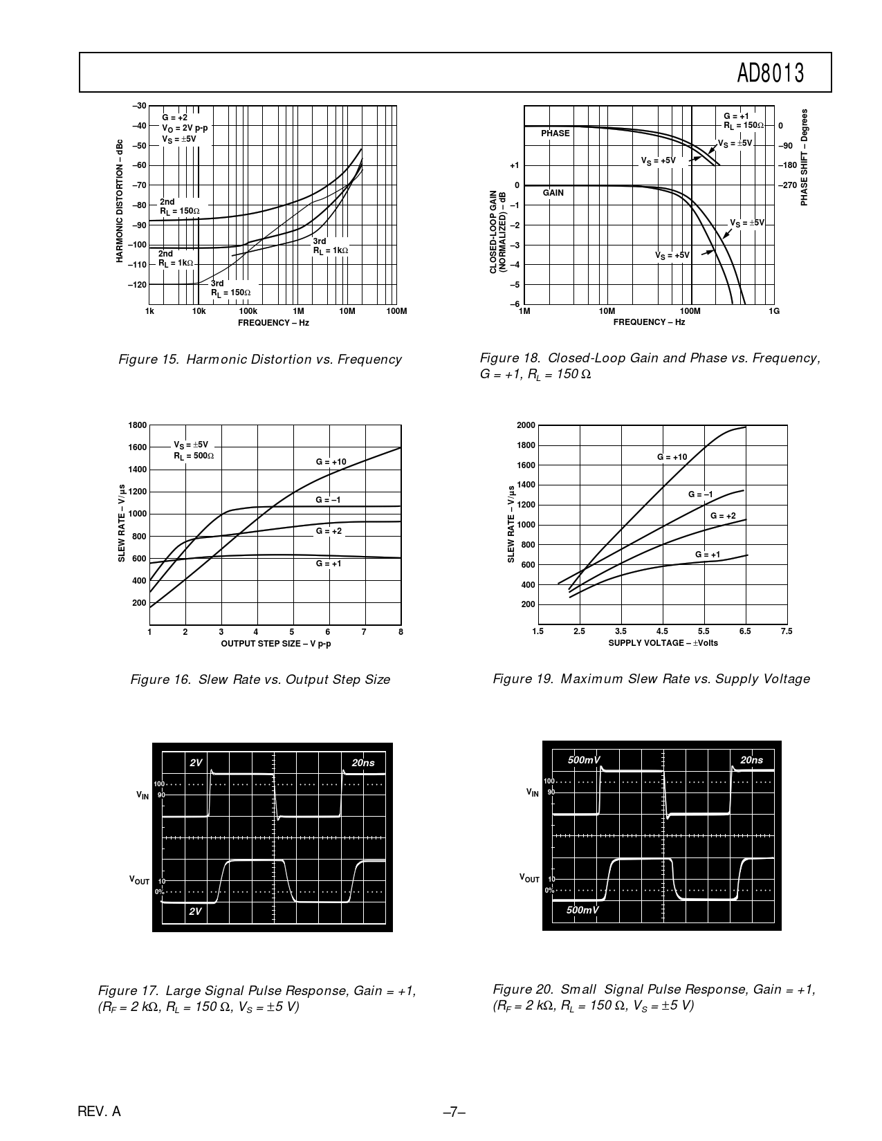

AD8013. –30. G = +2. G = +1. –40. O = 2V p-p. L = 150. PHASE. VS =. –50. –90. –60. S = +5V. –180. –70. –270. GAIN. –80. 2nd. PHASE SHIFT – Degrees. RL = 150
AD8013 –30 G = +2 G = +1 –40 V R 0 O = 2V p-p L = 150
Ω
PHASE VS =
5V –50 VS =
5V –90 V –60 +1 S = +5V –180 –70 0 –270 GAIN –80 2nd –1 PHASE SHIFT – Degrees RL = 150
Ω
–90 –2 VS =
5V –100 3rd –3 2nd RL = 1k
Ω
V HARMONIC DISTORTION – dBc S = +5V –110 RL = 1k
Ω
–4 CLOSED-LOOP GAIN (NORMALIZED) – dB –120 3rd –5 RL = 150
Ω
–6 1k 10k 100k 1M 10M 100M 1M 10M 100M 1G FREQUENCY – Hz FREQUENCY – Hz
Figure 15. Harmonic Distortion vs. Frequency Figure 18. Closed-Loop Gain and Phase vs. Frequency, G = +1, RL = 150 Ω
1800 2000 1600 VS =
5V 1800 RL = 500
Ω
G = +10 G = +10 1600 1400 1400 1200 G = –1 V/µs G = –1 V/µs 1200 1000 G = +2 1000 G = +2 800 800 G = +1 SLEW RATE – 600 G = +1 SLEW RATE – 600 400 400 200 200 1 2 3 4 5 6 7 8 1.5 2.5 3.5 4.5 5.5 6.5 7.5 OUTPUT STEP SIZE – V p-p SUPPLY VOLTAGE –
Volts
Figure 16. Slew Rate vs. Output Step Size Figure 19. Maximum Slew Rate vs. Supply Voltage
2V 20ns 500mV 20ns 100 100 V 90 V 90 IN IN V V OUT 10 OUT 10 0% 0% 2V 500mV
Figure 17. Large Signal Pulse Response, Gain = +1, Figure 20. Small Signal Pulse Response, Gain = +1, (R (R F = 2 kΩ, RL = 150 Ω, VS = ±5 V) F = 2 kΩ, RL = 150 Ω, VS = ±5 V) REV. A –7–
