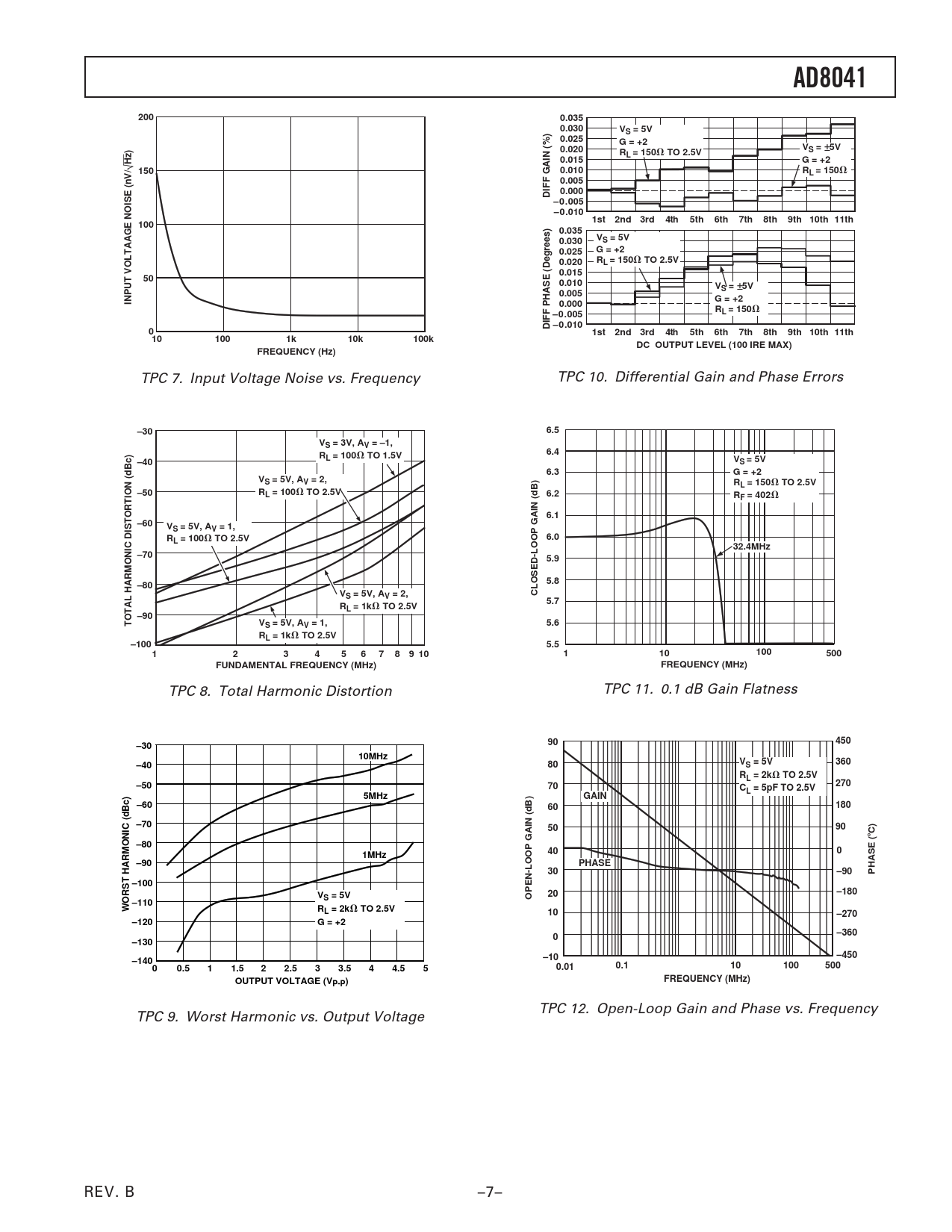

AD8041. 200. 0.035 0.030. VS = 5V. 0.025. G = +2. 0.020. S = 5V. L = 150. TO 2.5V. Hz). 0.015. 150. 0.010. RL = 150. 0.005. DIFF GAIN (%). 0.000
AD8041 200 0.035 0.030 VS = 5V 0.025 G = +2 0.020 V R S = 5V L = 150
TO 2.5V Hz) 0.015 G = +2 150 0.010 RL = 150
0.005 DIFF GAIN (%) 0.000 –0.005 –0.010 1st 2nd 3rd 4th 5th 6th 7th 8th 9th 10th 11th 100 0.035 0.030 VS = 5V 0.025 G = +2 0.020 RL = 150
TO 2.5V 0.015 50 0.010 VS = 5V 0.005 INPUT VOLTAAGE NOISE (nV/ G = +2 0.000 R –0.005 L = 150
DIFF PHASE (Degrees) –0.010 0 1st 2nd 3rd 4th 5th 6th 7th 8th 9th 10th 11th 10 100 1k 10k 100k DC OUTPUT LEVEL (100 IRE MAX) FREQUENCY (Hz)
TPC 7. Input Voltage Noise vs. Frequency TPC 10. Differential Gain and Phase Errors
–30 6.5 VS = 3V, AV = –1, R 6.4 –40 L = 100
TO 1.5V VS = 5V 6.3 G = +2 VS = 5V, AV = 2, RL = 150
TO 2.5V –50 RL = 100
TO 2.5V 6.2 RF = 402
6.1 –60 VS = 5V, AV = 1, R 6.0 L = 100
TO 2.5V 32.4MHz –70 5.9 5.8 –80 VS = 5V, AV = 2, CLOSED-LOOP GAIN (dB) 5.7 RL = 1k
TO 2.5V –90 TOTAL HARMONIC DISTORTION (dBc) VS = 5V, AV = 1, 5.6 RL = 1k
TO 2.5V –100 5.5 1 2 3 4 5 6 7 8 9 10 1 10 100 500 FUNDAMENTAL FREQUENCY (MHz) FREQUENCY (MHz)
TPC 8. Total Harmonic Distortion TPC 11. 0.1 dB Gain Flatness
450 –30 90 10MHz –40 80 V 360 S = 5V RL = 2k
TO 2.5V –50 70 270 CL = 5pF TO 2.5V 5MHz GAIN –60 60 180 –70 50 90
ⴗ
C) –80 0 1MHz 40 –90 PHASE 30 –90 PHASE ( –100 V 20 –180 S = 5V OPEN-LOOP GAIN (dB) –110 WORST HARMONIC (dBc) RL = 2k
TO 2.5V 10 –270 –120 G = +2 0 –360 –130 –450 –140 –10 0 0.5 1 1.5 2 2.5 3 3.5 4 4.5 5 0.01 0.1 10 100 500 OUTPUT VOLTAGE (V FREQUENCY (MHz) P-P)
TPC 12. Open-Loop Gain and Phase vs. Frequency TPC 9. Worst Harmonic vs. Output Voltage REV. B –7– Document Outline FEATURES APPLICATIONS PRODUCT DESCRIPTION CONNECTION DIAGRAM SPECIFICATIONS ABSOLUTE MAXIMUM RATINGS MAXIMUM POWER DISSIPATION ORDERING GUIDE Typical Performance Characteristics Overdrive Recovery Circuit Description Output Impedance Disable Operation Single-Supply A/D Conversion APPLICATIONS RGB Buffer Single-Supply Composite Video Line Driver Sync Stripper Layout Considerations OUTLINE DIMENSIONS Revision History
