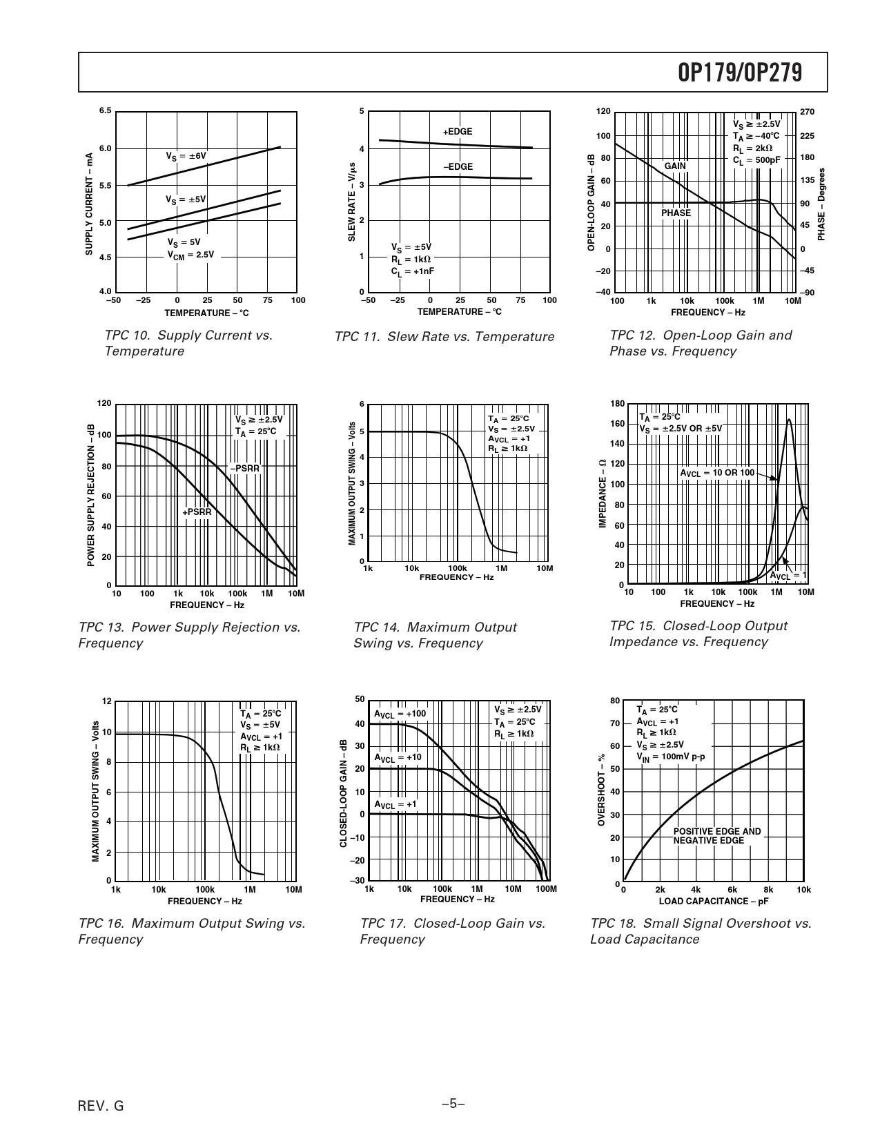

Datasheet OP179, OP279 (Analog Devices) - 5
| Description | Rail-to-Rail High Output Current Operational Amplifier |
| Pages / Page | 16 / 5 — OP179/OP279. 6.5. 120. 270. 2.5V. +EDGE. 100. 225. –40. 6.0. 180. GAIN. … |
| Revision | G |
| File Format / Size | PDF / 260 Kb |

TPC 10. Supply Current vs. TPC 11. Slew Rate vs. Temperature TPC 12. Open-Loop Gain and Temperature Phase vs. Frequency

TPC 13. Power Supply Rejection vs. TPC 14. Maximum Output TPC 15. Closed-Loop Output Frequency Swing vs. Frequency Impedance vs. Frequency

+1 0 30 4 OVERSHOOT POSITIVE EDGE AND –10 20 CLOSED-LOOP GAIN NEGATIVE EDGE 2 MAXIMUM OUTPUT SWING –20 10 0 –30 0 1k 10k 100k 1M 10M 1k 10k 100k 1M 10M 100M 0 2k 4k 6k 8k 10k FREQUENCY – Hz FREQUENCY – Hz LOAD CAPACITANCE – pF
TPC 16. Maximum Output Swing vs. TPC 17. Closed-Loop Gain vs. TPC 18. Small Signal Overshoot vs. Frequency Frequency Load Capacitance REV. G –5–
