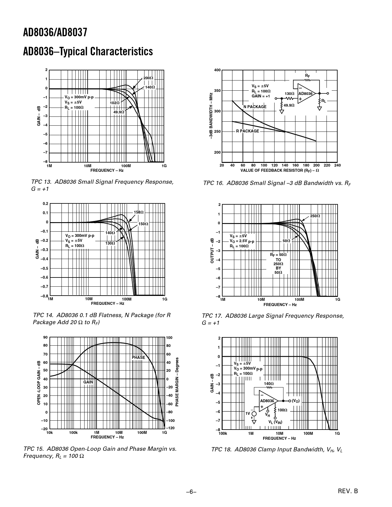

AD8036/AD8037. AD8036–Typical Characteristics. 400. 200. 140. S =. 350. RL = 100. 130. AD8036. GAIN = +1. O = 300mV p-p. MHz. 102. 49.9. N PACKAGE
AD8036/AD8037 AD8036–Typical Characteristics 2 400 R 200 F 1 140 V 0 S = 5V 350 RL = 100 130 AD8036 –1 V GAIN = +1 O = 300mV p-p MHz V RL S = 5V 102 – –2 49.9 R N PACKAGE L = 100 dB 49.9 300 – –3 GAIN –4 250 R PACKAGE –5 3dB BANDWIDTH – –6 –7 200 –8 1M 10M 100M 1G 20 40 60 80 100 120 140 160 180 200 220 240 FREQUENCY – Hz VALUE OF FEEDBACK RESISTOR (RF) –
TPC 13. AD8036 Small Signal Frequency Response, TPC 16. AD8036 Small Signal –3 dB Bandwidth vs. RF G = +1
0.2 2 0.1 158 1 250 0 150 0 –0.1 140 –1 VO = 300mV p-p VS = 5V –0.2 VS = 5V –2 V 50 O = 2.5V p-p dB dB – – RL = 100 130 RL = 100 –0.3 –3 RF = 50 GAIN –0.4 –4 TO OUTPUT 250 –0.5 –5 BY 50 –0.6 –6 –0.7 –7 –0.8 –8 1M 10M 100M 1G 1M 10M 100M 1G FREQUENCY – Hz FREQUENCY – Hz
TPC 14. AD8036 0.1 dB Flatness, N Package (for R TPC 17. AD8036 Large Signal Frequency Response, Package Add 20 Ω to RF) G = +1
90 100 2 80 80 1 70 60 PHASE 0 60 40 rees V dB S = 5V –1 – g V 50 20 O = 300mV p-p De – R –2 L = 100 40 0 dB GAIN – –3 140 30 –20 GAIN –4 20 –40 AD8036 (VO) OPEN -LOOP GAIN 10 –60 –5 PHASE MARGIN 100 0 –80 –6 1V VH –10 –100 –7 VL (VIN) –120 –20 –8 10k 100k 1M 10M 100M 1G 100k 1M 10M 100M 1G FREQUENCY – Hz FREQUENCY – Hz
TPC 15. AD8036 Open-Loop Gain and Phase Margin vs. TPC 18. AD8036 Clamp Input Bandwidth, VH, VL Frequency, RL = 100 Ω –6– REV. B
