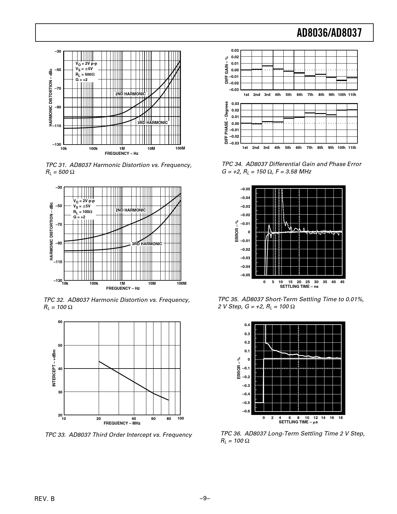

AD8036/AD8037. –30. 0.03. 0.02. O = 2V p-p. 0.01. –50. VS =. 0.00. dBc. RL = 500. –0.01. G = +2. DIFF GAIN –0.02. –70. –0.03. 2ND HARMONIC. 1st. 2nd. 3rd. 4th
AD8036/AD8037 –30 0.03 0.02 % V – O = 2V p-p 0.01 –50 VS = 5V 0.00 dBc RL = 500 – –0.01 G = +2 DIFF GAIN –0.02 –70 –0.03 2ND HARMONIC 1st 2nd 3rd 4th 5th 6th 7th 8th 9th 10th 11th 0.03 –90 0.02 Degrees 0.01 – 3RD HARMONIC 0.00 HARMONIC DISTORTION –110 –0.01 –0.02 –130 DIFF PHASE –0.03 10k 100k 1M 10M 100M 1st 2nd 3rd 4th 5th 6th 7th 8th 9th 10th 11th FREQUENCY – Hz
TPC 31. AD8037 Harmonic Distortion vs. Frequency, TPC 34. AD8037 Differential Gain and Phase Error R G = +2, R L = 500 Ω L = 150 Ω, F = 3.58 MHz
–30 –0.05 –0.04 VO = 2V p-p –50 V –0.03 dBc S = 5V – R 2ND HARMONIC L = 100 –0.02 G = +2 –70 % –0.01 – 0 ERROR –0.01 –90 3RD HARMONIC –0.02 HARMONIC DISTORTION –0.03 –110 –0.04 –0.05 –13010k 100k 1M 10M 100M 0 5 10 15 20 25 30 35 40 45 SETTLING TIME – ns FREQUENCY – Hz
TPC 32. AD8037 Harmonic Distortion vs. Frequency, TPC 35. AD8037 Short-Term Settling Time to 0.01%, R 2 V Step, G = +2, R L = 100 Ω L = 100 Ω
60 0.4 0.3 0.2 50 0.1 +dBm % 0 – – 40 –0.1 ERROR –0.2 INTERCEPT –0.3 30 –0.4 –0.5 –0.6 2010 20 40 60 80 100 0 2 4 6 8 10 12 14 16 18 FREQUENCY – MHz SETTLING TIME – s
TPC 33. AD8037 Third Order Intercept vs. Frequency TPC 36. AD8037 Long-Term Settling Time 2 V Step, RL = 100 Ω REV. B –9–
