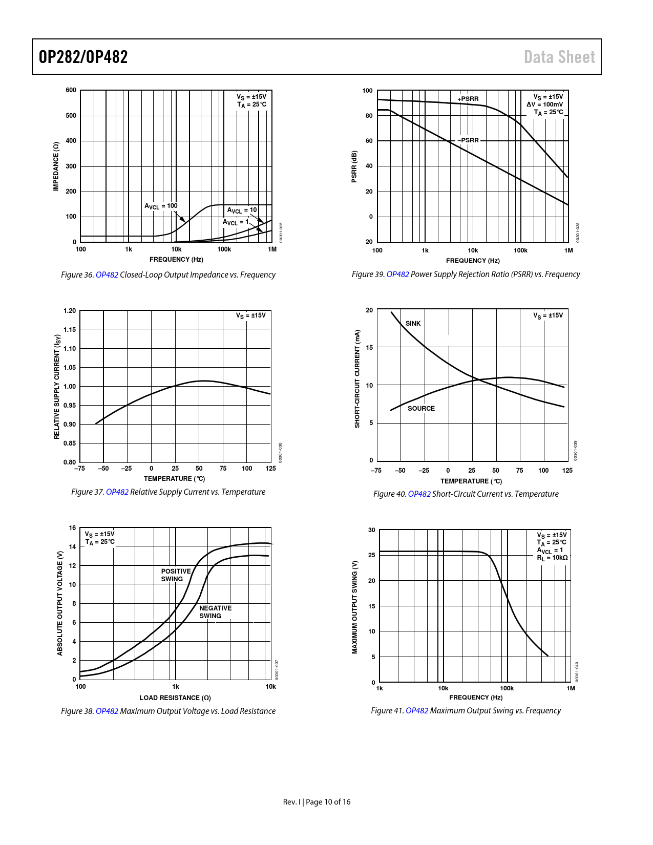

OP282/OP482. Data Sheet. 600. 100. VS = ±15V. +PSRR. TA = 25°C. ΔV = 100mV. 500. A = 25°C. 400. –PSRR. Ω (. B) d. 300. DANCE. RR (. 200. AVCL = 100
OP282/OP482 Data Sheet 600 100 VS = ±15V +PSRR VS = ±15V TA = 25°C ΔV = 100mV T 500 80 A = 25°C ) 400 60 –PSRR Ω ( B) d 300 40 DANCE RR ( E S P P IM 200 20 AVCL = 100 AVCL = 10 100 0 AVCL = 1

100 1k 10k 100k 1M 100 1k 10k 100k 1M FREQUENCY (Hz) FREQUENCY (Hz)
Figure 36. OP482 Closed-Loop Output Impedance vs. Frequency Figure 39. OP482 Power Supply Rejection Ratio (PSRR) vs. Frequency
1.20 20 VS = ±15V VS = ±15V SINK 1.15 ) mA) I SY ( ( 1.10 15 NT NT 1.05 CURRE CURRE T Y L 1.00 10 PP RCUI 0.95 -CI T SOURCE R IVE SU T HO A 0.90 5 L S RE 0.85

Figure 37. OP482 Relative Supply Current vs. Temperature Figure 40. OP482 Short-Circuit Current vs. Temperature
16 30 VS = ±15V VS = ±15V TA = 25°C T 14 A = 25°C AVCL = 1 25 RL = 10kΩ E (V) G 12 (V) A POSITIVE G LT SWING IN 20 O 10 T V SW U T 8 TP PU NEGATIVE 15 T U OU SWING 6 TE M O 10 MU OLU 4 S XI B A MA 5 2

100 1k 10k 1k 10k 100k 1M LOAD RESISTANCE (Ω) FREQUENCY (Hz)
Figure 38. OP482 Maximum Output Voltage vs. Load Resistance Figure 41. OP482 Maximum Output Swing vs. Frequency Rev. I | Page 10 of 16 Document Outline Features Applications General Description Pin Connections Table of Contents Revision History Specifications Electrical Characteristics Absolute Maximum Ratings Thermal Resistance ESD Caution Typical Performance Characteristics Applications Information High-Side Signal Conditioning Phase Inversion Active Filters Programmable State Variable Filter Outline Dimensions Ordering Guide
