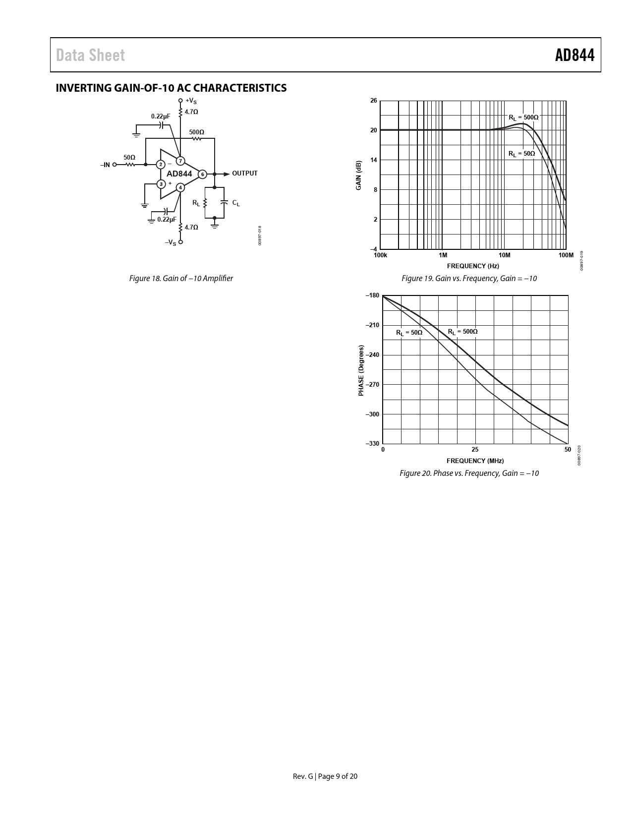

Data Sheet. AD844. INVERTING GAIN-OF-10 AC CHARACTERISTICS. +VS. 4.7Ω. 0.22µF. RL = 500Ω. 500Ω. 50Ω. L = 50Ω. –IN. B d. OUTPUT. ( IN. A G. –4100k. 10M
Data Sheet AD844 INVERTING GAIN-OF-10 AC CHARACTERISTICS +VS 4.7Ω 0.22µF RL = 500Ω 500Ω 50Ω L = 50Ω –IN B d OUTPUT ( IN A G –4100k 10M
Data Sheet AD844 INVERTING GAIN-OF-10 AC CHARACTERISTICS +VS 26 4.7Ω 0.22µF RL = 500Ω 500Ω 20 R 50Ω L = 50Ω – ) 14 –IN B d AD844 OUTPUT ( IN + A G 8 R C L L 0.22µF 2 4.7Ω

–4100k 1M 10M 100M
9 1 0 7-
FREQUENCY (Hz)
89 00 Figure 18. Gain of −10 Amplifier Figure 19. Gain vs. Frequency, Gain = −10
–180 –210 R R L = 50Ω L = 500Ω –240 rees) eg D ( E S A –270 H P –300 –330 0 25 50
20 0 7-
FREQUENCY (MHz)
