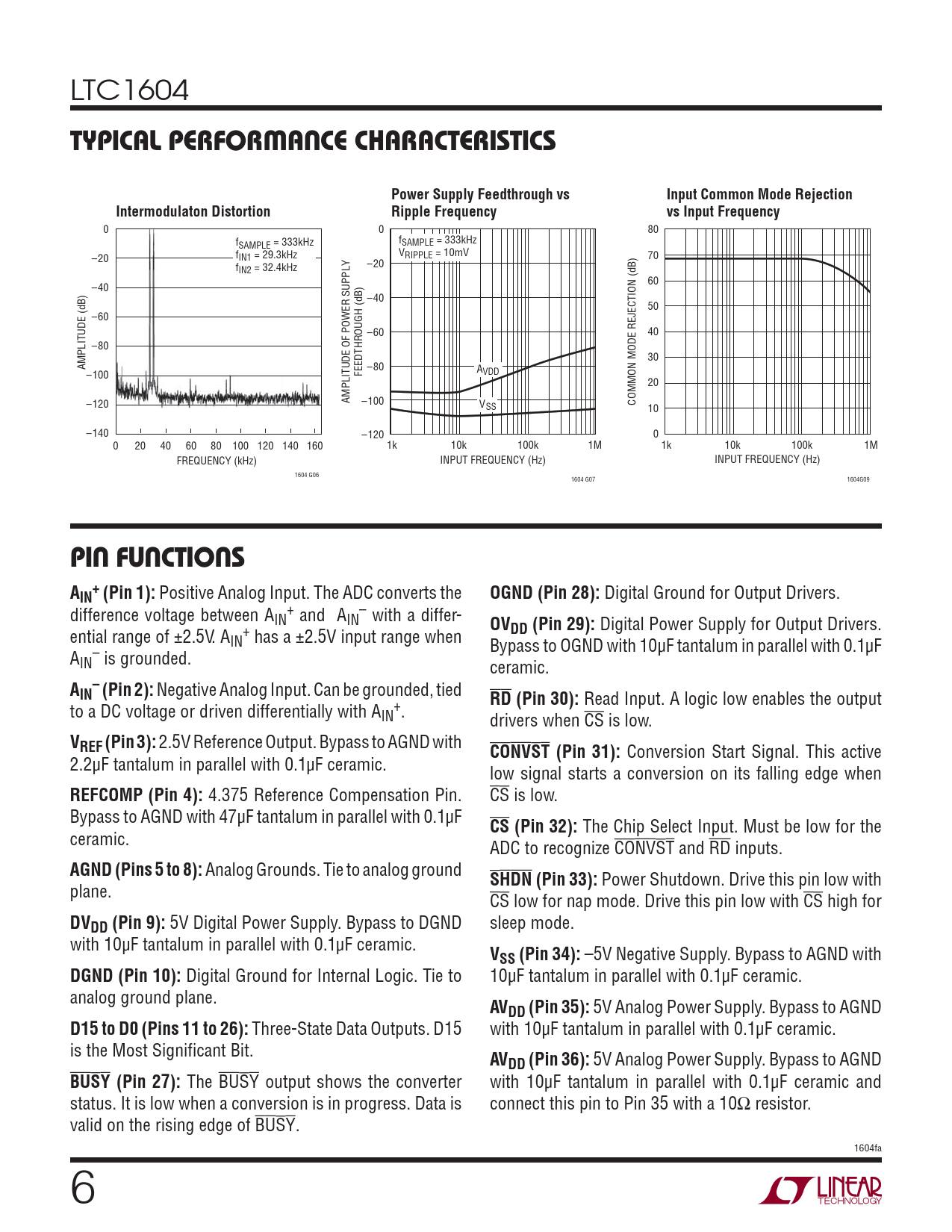

TYPICAL PERFORMANCE CHARACTERISTICS. Power Supply Feedthrough vs. Input Common Mode Rejection. Intermodulaton Distortion
TYPICAL PERFORMANCE CHARACTERISTICS Power Supply Feedthrough vs Input Common Mode Rejection Intermodulaton Distortion
LTC1604
TYPICAL PERFORMANCE CHARACTERISTICS Power Supply Feedthrough vs Input Common Mode Rejection Intermodulaton Distortion Ripple Frequency vs Input Frequency
0 0 80 f f SAMPLE = 333kHz SAMPLE = 333kHz V –20 fIN1 = 29.3kHz RIPPLE = 10mV 70 f –20 IN2 = 32.4kHz 60 –40 –40 50 –60 –60 40 –80 30 AMPLITUDE (dB) –80 A –100 FEEDTHROUGH (dB) VDD 20 –120 AMPLITUDE OF POWER SUPPLY –100 V COMMON MODE REJECTION (dB) SS 10 –140 –120 0 0 20 40 60 80 100 120 140 160 1k 10k 100k 1M 1k 10k 100k 1M FREQUENCY (kHz) INPUT FREQUENCY (Hz) INPUT FREQUENCY (Hz) 1604 G06 1604 G07 1604G09
PIN FUNCTIONS A + IN (Pin 1):
Positive Analog Input. The ADC converts the
OGND (Pin 28):
Digital Ground for Output Drivers. difference voltage between A + – IN and AIN with a differ-
OV
ential range of ±2.5V. A +
DD (Pin 29):
Digital Power Supply for Output Drivers. IN has a ±2.5V input range when Bypass to OGND with 10μF tantalum in parallel with 0.1μF A – IN is grounded. ceramic.
A – IN (Pin 2):
Negative Analog Input. Can be grounded, tied
RD (Pin 30):
Read Input. A logic low enables the output to a DC voltage or driven differentially with A + IN . drivers when CS is low.
VREF (Pin 3):
2.5V Reference Output. Bypass to AGND with
CONVST (Pin 31):
Conversion Start Signal. This active 2.2μF tantalum in parallel with 0.1μF ceramic. low signal starts a conversion on its falling edge when
REFCOMP (Pin 4):
4.375 Reference Compensation Pin. CS is low. Bypass to AGND with 47μF tantalum in parallel with 0.1μF
CS (Pin 32):
The Chip Select Input. Must be low for the ceramic. ADC to recognize CONVST and RD inputs.
AGND (Pins 5 to 8):
Analog Grounds. Tie to analog ground
SHDN (Pin 33):
Power Shutdown. Drive this pin low with plane. CS low for nap mode. Drive this pin low with CS high for
DVDD (Pin 9):
5V Digital Power Supply. Bypass to DGND sleep mode. with 10μF tantalum in parallel with 0.1μF ceramic.
VSS (Pin 34):
–5V Negative Supply. Bypass to AGND with
DGND (Pin 10):
Digital Ground for Internal Logic. Tie to 10μF tantalum in parallel with 0.1μF ceramic. analog ground plane.
AVDD (Pin 35):
5V Analog Power Supply. Bypass to AGND
D15 to D0 (Pins 11 to 26):
Three-State Data Outputs. D15 with 10μF tantalum in parallel with 0.1μF ceramic. is the Most Significant Bit.
AVDD (Pin 36):
BUSY (Pin 27):
The BUSY output shows the converter with 10μF tantalum in parallel with 0.1μF ceramic and status. It is low when a conversion is in progress. Data is connect this pin to Pin 35 with a 10Ω resistor. valid on the rising edge of BUSY. 1604fa 6
