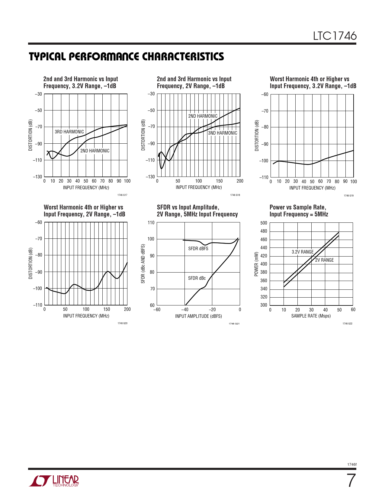

TYPICAL PERFOR A CE CHARACTERISTICS. 2nd and 3rd Harmonic vs Input. Worst Harmonic 4th or Higher vs
LTC1746
W U TYPICAL PERFOR A CE CHARACTERISTICS 2nd and 3rd Harmonic vs Input 2nd and 3rd Harmonic vs Input Worst Harmonic 4th or Higher vs Frequency, 3.2V Range, –1dB Frequency, 2V Range, –1dB Input Frequency, 3.2V Range, –1dB
–30 –30 –60 –50 –50 –70 2ND HARMONIC –70 –70 –80 3RD HARMONIC 3ND HARMONIC –90 –90 –90 DISTORTION (dB) 2ND HARMONIC DISTORTION (dB) DISTORTION (dB) –110 –110 –100 –130 –130 –110 0 10 20 30 40 50 60 70 80 90 100 0 50 100 150 200 0 10 20 30 40 50 60 70 80 90 100 INPUT FREQUENCY (MHz) INPUT FREQUENCY (MHz) INPUT FREQUENCY (MHz) 1746 G17 1746 G18 1746 G19
Worst Harmonic 4th or Higher vs SFDR vs Input Amplitude, Power vs Sample Rate, Input Frequency, 2V Range, –1dB 2V Range, 5MHz Input Frequency Input Frequency = 5MHz
–60 110 500 480 –70 100 460 SFDR dBFS 440 3.2V RANGE –80 90 420 2V RANGE 400 –90 80 380 POWER (mW) DISTORTION (dB) SFDR dBc SFDR (dBc AND dBFS) 360 –100 70 340 320 –110 60 300 0 50 100 150 200 –60 –40 –20 0 0 10 20 30 40 50 60 INPUT FREQUENCY (MHz) INPUT AMPLITUDE (dBFS) SAMPLE RATE (Msps) 1746 G20 1746 G21 1746 G22 1746f 7
