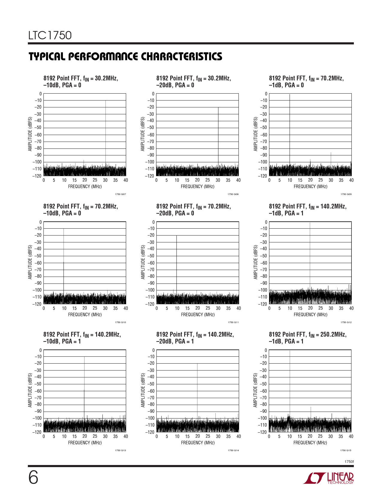

TYPICAL PERFOR A CE CHARACTERISTICS. 8192 Point FFT, fIN = 30.2MHz,. 8192 Point FFT, fIN = 70.2MHz,. –10dB, PGA = 0
LTC1750
W U TYPICAL PERFOR A CE CHARACTERISTICS 8192 Point FFT, fIN = 30.2MHz, 8192 Point FFT, fIN = 30.2MHz, 8192 Point FFT, fIN = 70.2MHz, –10dB, PGA = 0 –20dB, PGA = 0 –1dB, PGA = 0
0 0 0 –10 –10 –10 –20 –20 –20 –30 –30 –30 –40 –40 –40 –50 –50 –50 –60 –60 –60 –70 –70 –70 AMPLITUDE (dBFS) –80 AMPLITUDE (dBFS) –80 AMPLITUDE (dBFS) –80 –90 –90 –90 –100 –100 –100 –110 –110 –110 –120 –120 –120 0 5 10 15 20 25 30 35 40 0 5 10 15 20 25 30 35 40 0 5 10 15 20 25 30 35 40 FREQUENCY (MHz) FREQUENCY (MHz) FREQUENCY (MHz) 1750 G07 1750 G08 1750 G09
8192 Point FFT, fIN = 70.2MHz, 8192 Point FFT, fIN = 70.2MHz, 8192 Point FFT, fIN = 140.2MHz, –10dB, PGA = 0 –20dB, PGA = 0 –1dB, PGA = 1
0 0 0 –10 –10 –10 –20 –20 –20 –30 –30 –30 –40 –40 –40 –50 –50 –50 –60 –60 –60 –70 –70 –70 AMPLITUDE (dBFS) –80 AMPLITUDE (dBFS) –80 AMPLITUDE (dBFS) –80 –90 –90 –90 –100 –100 –100 –110 –110 –110 –120 –120 –120 0 5 10 15 20 25 30 35 40 0 5 10 15 20 25 30 35 40 0 5 10 15 20 25 30 35 40 FREQUENCY (MHz) FREQUENCY (MHz) FREQUENCY (MHz) 1750 G10 1750 G11 1750 G12
8192 Point FFT, fIN = 140.2MHz, 8192 Point FFT, fIN = 140.2MHz, 8192 Point FFT, fIN = 250.2MHz, –10dB, PGA = 1 –20dB, PGA = 1 –1dB, PGA = 1
0 0 0 –10 –10 –10 –20 –20 –20 –30 –30 –30 –40 –40 –40 –50 –50 –50 –60 –60 –60 –70 –70 –70 AMPLITUDE (dBFS) –80 AMPLITUDE (dBFS) –80 AMPLITUDE (dBFS) –80 –90 –90 –90 –100 –100 –100 –110 –110 –110 –120 –120 –120 0 5 10 15 20 25 30 35 40 0 5 10 15 20 25 30 35 40 0 5 10 15 20 25 30 35 40 FREQUENCY (MHz) FREQUENCY (MHz) FREQUENCY (MHz) 1750 G13 1750 G14 1750 G15 1750f 6
