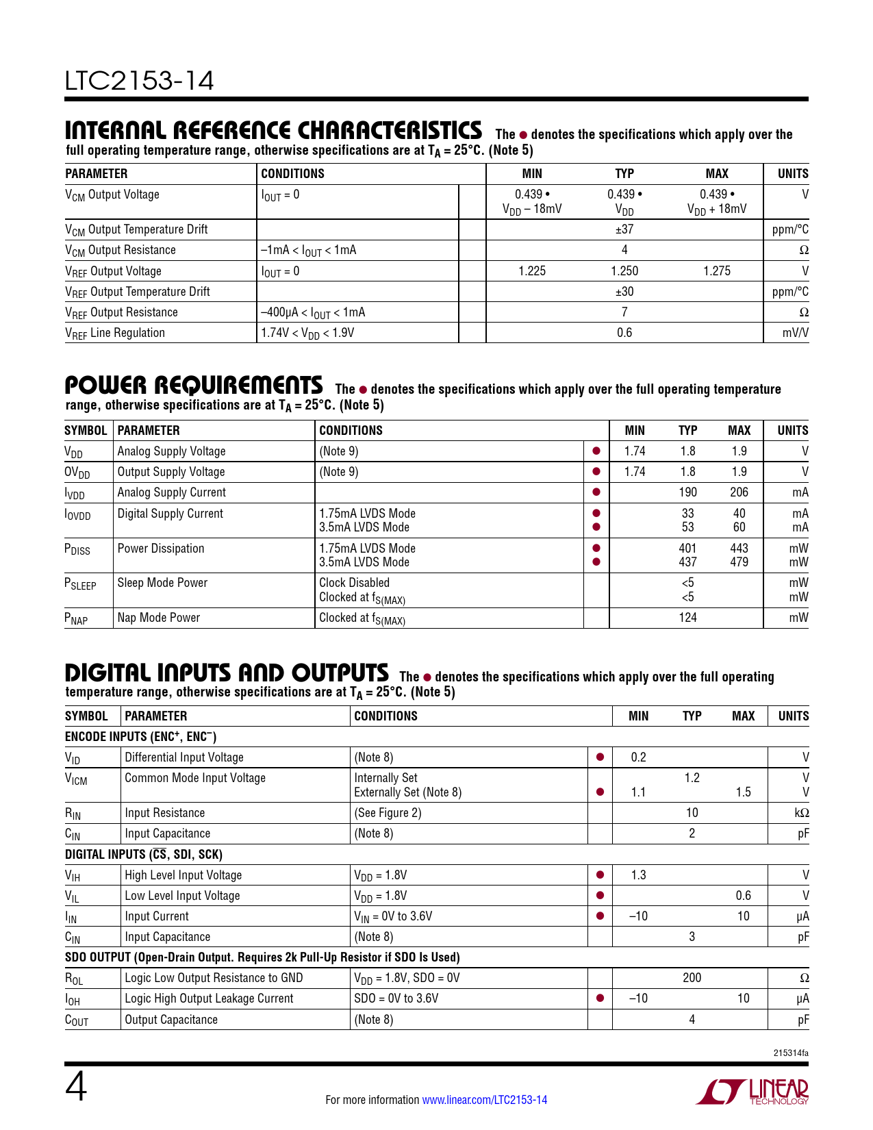

i nTernal reFerence characTerisTics The. denotes the specifications which apply over the
i nTernal reFerence characTerisTics The denotes the specifications which apply over the
LTC2153-14
l
denotes the specifications which apply over the full operating temperature range, otherwise specifications are at TA = 25°C. (Note 5) PARAMETER CONDITIONS MIN TYP MAX UNITS
VCM Output Voltage IOUT = 0 0.439 • 0.439 • 0.439 • V VDD – 18mV VDD VDD + 18mV VCM Output Temperature Drift ±37 ppm/°C VCM Output Resistance –1mA < IOUT < 1mA 4 Ω VREF Output Voltage IOUT = 0 1.225 1.250 1.275 V VREF Output Temperature Drift ±30 ppm/°C VREF Output Resistance –400µA < IOUT < 1mA 7 Ω VREF Line Regulation 1.74V < VDD < 1.9V 0.6 mV/V
p ower requireMenTs The
l
denotes the specifications which apply over the full operating temperature range, otherwise specifications are at TA = 25°C. (Note 5) SYMBOL PARAMETER CONDITIONS MIN TYP MAX UNITS
VDD Analog Supply Voltage (Note 9) l 1.74 1.8 1.9 V OVDD Output Supply Voltage (Note 9) l 1.74 1.8 1.9 V IVDD Analog Supply Current l 190 206 mA IOVDD Digital Supply Current 1.75mA LVDS Mode l 33 40 mA 3.5mA LVDS Mode l 53 60 mA PDISS Power Dissipation 1.75mA LVDS Mode l 401 443 mW 3.5mA LVDS Mode l 437 479 mW PSLEEP Sleep Mode Power Clock Disabled <5 mW Clocked at fS(MAX) <5 mW PNAP Nap Mode Power Clocked at fS(MAX) 124 mW
Digi Tal inpuTs anD ouTpuTs The
l
denotes the specifications which apply over the full operating temperature range, otherwise specifications are at TA = 25°C. (Note 5) SYMBOL PARAMETER CONDITIONS MIN TYP MAX UNITS ENCODE INPUTS (ENC+, ENC– )
VID Differential Input Voltage (Note 8) l 0.2 V VICM Common Mode Input Voltage Internally Set 1.2 V Externally Set (Note 8) l 1.1 1.5 V RIN Input Resistance (See Figure 2) 10 kΩ CIN Input Capacitance (Note 8) 2 pF
DIGITAL INPUTS (CS, SDI, SCK)
VIH High Level Input Voltage VDD = 1.8V l 1.3 V VIL Low Level Input Voltage VDD = 1.8V l 0.6 V IIN Input Current VIN = 0V to 3.6V l –10 10 µA CIN Input Capacitance (Note 8) 3 pF
SDO OUTPUT (Open-Drain Output. Requires 2k Pull-Up Resistor if SDO Is Used)
ROL Logic Low Output Resistance to GND VDD = 1.8V, SDO = 0V 200 Ω IOH Logic High Output Leakage Current SDO = 0V to 3.6V l –10 10 µA COUT Output Capacitance (Note 8) 4 pF 215314fa 4 For more information www.linear.com/LTC2153-14 Document Outline Features Description Applications Typical Application Absolute Maximum Ratings Pin Configuration Order Information Converter Characteristics Analog Input Dynamic Accuracy Internal Reference Characteristics Power Requirements Digital Inputs And Outputs Timing Characteristics Typical Performance Characteristics Pin Functions Functional Block Diagram Timing Diagrams Applications Information Package Description Related Parts
