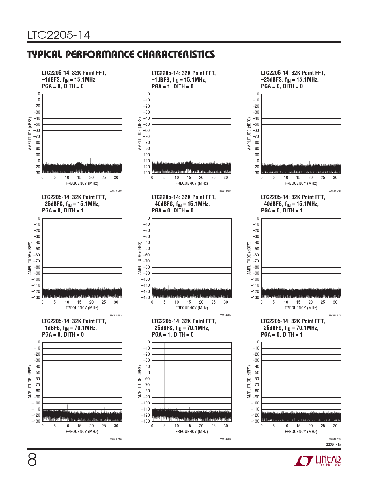

TYPICAL PERFORMANCE CHARACTERISTICS. LTC2205-14: 32K Point FFT,. –1dBFS, fIN = 15.1MHz,. –25dBFS, fIN = 15.1MHz,
LTC2205-14
TYPICAL PERFORMANCE CHARACTERISTICS LTC2205-14: 32K Point FFT, LTC2205-14: 32K Point FFT, LTC2205-14: 32K Point FFT, –1dBFS, fIN = 15.1MHz, –1dBFS, fIN = 15.1MHz, –25dBFS, fIN = 15.1MHz, PGA = 0, DITH = 0 PGA = 1, DITH = 0 PGA = 0, DITH = 0
0 0 0 –10 –10 –10 –20 –20 –20 –30 –30 –30 –40 –40 –40 –50 –50 –50 –60 –60 –60 –70 –70 –70 –80 –80 –80 AMPLITUDE (dBFS) –90 AMPLITUDE (dBFS) –90 AMPLITUDE (dBFS) –90 –100 –100 –100 –110 –110 –110 –120 –120 –120 –130 –130 –130 0 5 10 15 20 25 30 0 5 10 15 20 25 30 0 5 10 15 20 25 30 FREQUENCY (MHz) FREQUENCY (MHz) FREQUENCY (MHz) 220514 G10 220514 G11 220514 G12
LTC2205-14: 32K Point FFT, LTC2205-14: 32K Point FFT, LTC2205-14: 32K Point FFT, –25dBFS, fIN = 15.1MHz, –40dBFS, fIN = 15.1MHz, –40dBFS, fIN = 15.1MHz, PGA = 0, DITH = 1 PGA = 0, DITH = 0 PGA = 0, DITH = 1
0 0 0 –10 –10 –10 –20 –20 –20 –30 –30 –30 –40 –40 –40 –50 –50 –50 –60 –60 –60 –70 –70 –70 –80 –80 –80 AMPLITUDE (dBFS) –90 AMPLITUDE (dBFS) –90 AMPLITUDE (dBFS) –90 –100 –100 –100 –110 –110 –110 –120 –120 –120 –130 –130 –130 0 5 10 15 20 25 30 0 5 10 15 20 25 30 0 5 10 15 20 25 30 FREQUENCY (MHz) FREQUENCY (MHz) FREQUENCY (MHz) 220514 G13 220514 G14 220514 G15
LTC2205-14: 32K Point FFT, LTC2205-14: 32K Point FFT, LTC2205-14: 32K Point FFT, –1dBFS, fIN = 70.1MHz, –25dBFS, fIN = 70.1MHz, –25dBFS, fIN = 70.1MHz, PGA = 0, DITH = 0 PGA = 1, DITH = 0 PGA = 0, DITH = 1
0 0 0 –10 –10 –10 –20 –20 –20 –30 –30 –30 –40 –40 –40 –50 –50 –50 –60 –60 –60 –70 –70 –70 –80 –80 –80 AMPLITUDE (dBFS) –90 AMPLITUDE (dBFS) –90 AMPLITUDE (dBFS) –90 –100 –100 –100 –110 –110 –110 –120 –120 –120 –130 –130 –130 0 5 10 15 20 25 30 0 5 10 15 20 25 30 0 5 10 15 20 25 30 FREQUENCY (MHz) FREQUENCY (MHz) FREQUENCY (MHz) 220514 G16 220514 G17 220514 G19 220514fb 8
