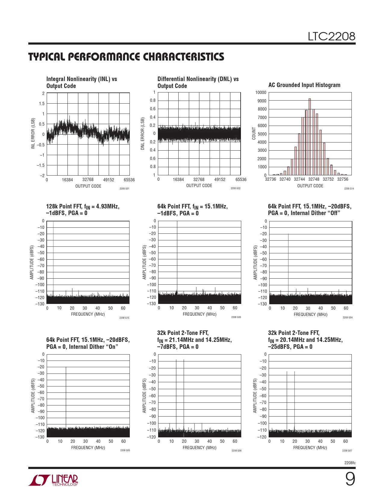

TYPICAL PERFORMANCE CHARACTERISTICS. Integral Nonlinearity (INL) vs. Differential Nonlinearity (DNL) vs. Output Code
LTC2208
TYPICAL PERFORMANCE CHARACTERISTICS Integral Nonlinearity (INL) vs Differential Nonlinearity (DNL) vs Output Code Output Code AC Grounded Input Histogram
2 1 10000 0.8 9000 1.5 0.6 8000 1 0.4 7000 0.5 0.2 6000 0 0 5000 COUNT 0.2 4000 –0.5 INL ERROR (LSB) DNL ERROR (LSB) 0.4 3000 –1 0.6 2000 –1.5 0.8 1000 –2 1 0 0 16384 32768 49152 65536 0 16384 32768 49152 65536 32736 32740 32744 32748 32752 32756 OUTPUT CODE OUTPUT CODE OUTPUT CODE 2208 G01 2208 G02 2208 G14
128k Point FFT, fIN = 4.93MHz, 64k Point FFT, f 64k Point FFT, 15.1MHz, –20dBFS, IN = 15.1MHz, –1dBFS, PGA = 0 –1dBFS, PGA = 0 PGA = 0, Internal Dither “Off”
0 0 0 –10 –10 –10 –20 –20 –20 –30 –30 –30 –40 –40 –40 –50 –50 –50 –60 –60 –60 –70 –70 –70 –80 –80 –80 AMPLITUDE (dBFS) –90 AMPLITUDE (dBFS) –90 AMPLITUDE (dBFS) –90 –100 –100 –100 –110 –110 –110 –120 –120 –120 –130 –130 –130 0 10 20 30 40 50 60 0 10 20 30 40 50 60 0 10 20 30 40 50 60 FREQUENCY (MHz) FREQUENCY (MHz) FREQUENCY (MHz) 2208 G03 2208 G15 2208 G04
32k Point 2-Tone FFT, 32k Point 2-Tone FFT, 64k Point FFT, 15.1MHz, –20dBFS, fIN = 21.14MHz and 14.25MHz, fIN = 20.14MHz and 14.25MHz, PGA = 0, Internal Dither “On” –7dBFS, PGA = 0 –25dBFS, PGA = 0
0 0 0 –10 –10 –10 –20 –20 –20 –30 –30 –30 –40 –40 –40 –50 –50 –50 –60 –60 –60 –70 –70 –70 –80 AMPLITUDE (dBFS) –90 AMPLITUDE (dBFS) –80 AMPLITUDE (dBFS) –80 –90 –90 –100 –100 –100 –110 –120 –110 –110 –130 –120 –120 0 10 20 30 40 50 60 0 10 20 30 40 50 60 0 10 20 30 40 50 60 FREQUENCY (MHz) FREQUENCY (MHz) FREQUENCY (MHz) 2208 G05 2208 G06 2208 G07 2208fc 9
