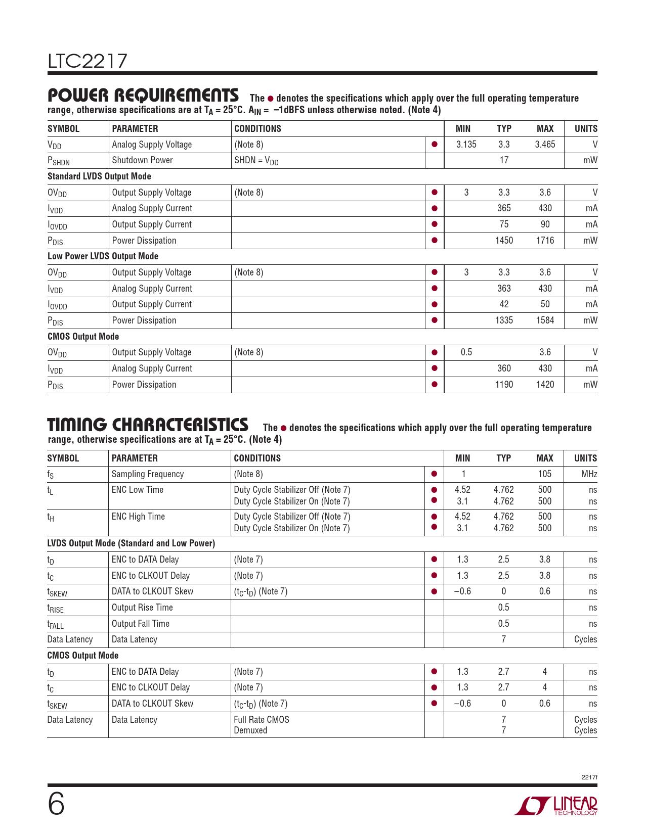

POWER REQUIREMENTS. The. denotes the specifi cations which apply over the full operating temperature
POWER REQUIREMENTS The denotes the specifi cations which apply over the full operating temperature
LTC2217
denotes the specifi cations which apply over the full operating temperature range, otherwise specifi cations are at TA = 25°C. AIN = –1dBFS unless otherwise noted. (Note 4) SYMBOL PARAMETER CONDITIONS MIN TYP MAX UNITS
VDD Analog Supply Voltage (Note 8) ● 3.135 3.3 3.465 V PSHDN Shutdown Power SHDN = VDD 17 mW
Standard LVDS Output Mode
OVDD Output Supply Voltage (Note 8) ● 3 3.3 3.6 V IVDD Analog Supply Current ● 365 430 mA IOVDD Output Supply Current ● 75 90 mA PDIS Power Dissipation ● 1450 1716 mW
Low Power LVDS Output Mode
OVDD Output Supply Voltage (Note 8) ● 3 3.3 3.6 V IVDD Analog Supply Current ● 363 430 mA IOVDD Output Supply Current ● 42 50 mA PDIS Power Dissipation ● 1335 1584 mW
CMOS Output Mode
OVDD Output Supply Voltage (Note 8) ● 0.5 3.6 V IVDD Analog Supply Current ● 360 430 mA PDIS Power Dissipation ● 1190 1420 mW
The TIMING CHARACTERISTICS
denotes the specifi cations which apply over the full operating temperature range, otherwise specifi cations are at TA = 25°C. (Note 4) SYMBOL PARAMETER CONDITIONS MIN TYP MAX UNITS
fS Sampling Frequency (Note 8) ● 1 105 MHz tL ENC Low Time Duty Cycle Stabilizer Off (Note 7) ● 4.52 4.762 500 ns Duty Cycle Stabilizer On (Note 7) ● 3.1 4.762 500 ns tH ENC High Time Duty Cycle Stabilizer Off (Note 7) ● 4.52 4.762 500 ns Duty Cycle Stabilizer On (Note 7) ● 3.1 4.762 500 ns
LVDS Output Mode (Standard and Low Power)
tD ENC to DATA Delay (Note 7) ● 1.3 2.5 3.8 ns tC ENC to CLKOUT Delay (Note 7) ● 1.3 2.5 3.8 ns tSKEW DATA to CLKOUT Skew (tC-tD) (Note 7) ● –0.6 0 0.6 ns tRISE Output Rise Time 0.5 ns tFALL Output Fall Time 0.5 ns Data Latency Data Latency 7 Cycles
CMOS Output Mode
tD ENC to DATA Delay (Note 7) ● 1.3 2.7 4 ns tC ENC to CLKOUT Delay (Note 7) ● 1.3 2.7 4 ns tSKEW DATA to CLKOUT Skew (tC-tD) (Note 7) ● –0.6 0 0.6 ns Data Latency Data Latency Full Rate CMOS 7 Cycles Demuxed 7 Cycles 2217f 6
