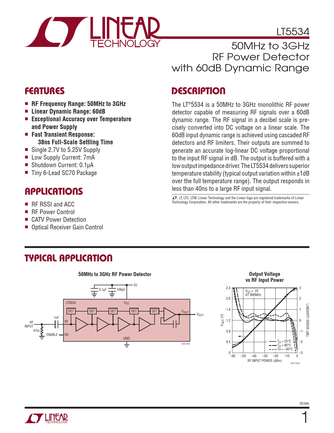

Description50MHz to 3GHz RF Power Detector with 60dB Dynamic Range

RF Frequency Range: 50MHz to 3GHz
The LT®5534 is a 50MHz to 3GHz monolithic RF power n
Linear Dynamic Range: 60dB
detector capable of measuring RF signals over a 60dB n
Exceptional Accuracy over Temperature
dynamic range. The RF signal in a decibel scale is pre-
and Power Supply
cisely converted into DC voltage on a linear scale. The n
Fast Transient Response:
60dB input dynamic range is achieved using cascaded RF
38ns Full-Scale Settling Time
detectors and RF limiters. Their outputs are summed to n Single 2.7V to 5.25V Supply generate an accurate log-linear DC voltage proportional n Low Supply Current: 7mA to the input RF signal in dB. The output is buffered with a n Shutdown Current: 0.1µA low output impedance driver. The LT5534 delivers superior n Tiny 6-Lead SC70 Package temperature stability (typical output variation within ±1dB over the full temperature range). The output responds in less than 40ns to a large RF input signal.

TYPICAL APPLICATION 50MHz to 3GHz RF Power Detector Output Voltage vs RF Input Power
3V 0.1µF 100pF 2.4 3 VCC = 3V AT 900MHz 2.0 2 LT5534 VCC LINEARIT DET DET DET DET DET V 1.6 1 OUT VOUT 1nF Y ERROR (dB) (V) RF RF 1.2 0 INPUT V OUT 47Ω 0.8 –1 ENABLE EN GND 0.4 TA = 25°C –2 5534 TA01 TA = 85°C TA = –40°C 0 –3 –60 –50 –40 –30 –20 –10 0 RF INPUT POWER (dBm) 5534 TA01b 5534fc 1 Document Outline Features Applications Description Typical Application Absolute Maximum Ratings Pin Configuration Order Information Electrical Characteristics Typical Performance Characteristics Pin Functions Block Diagram TEST CIRCUIT Applications Information Revision History Package Description Related Parts
