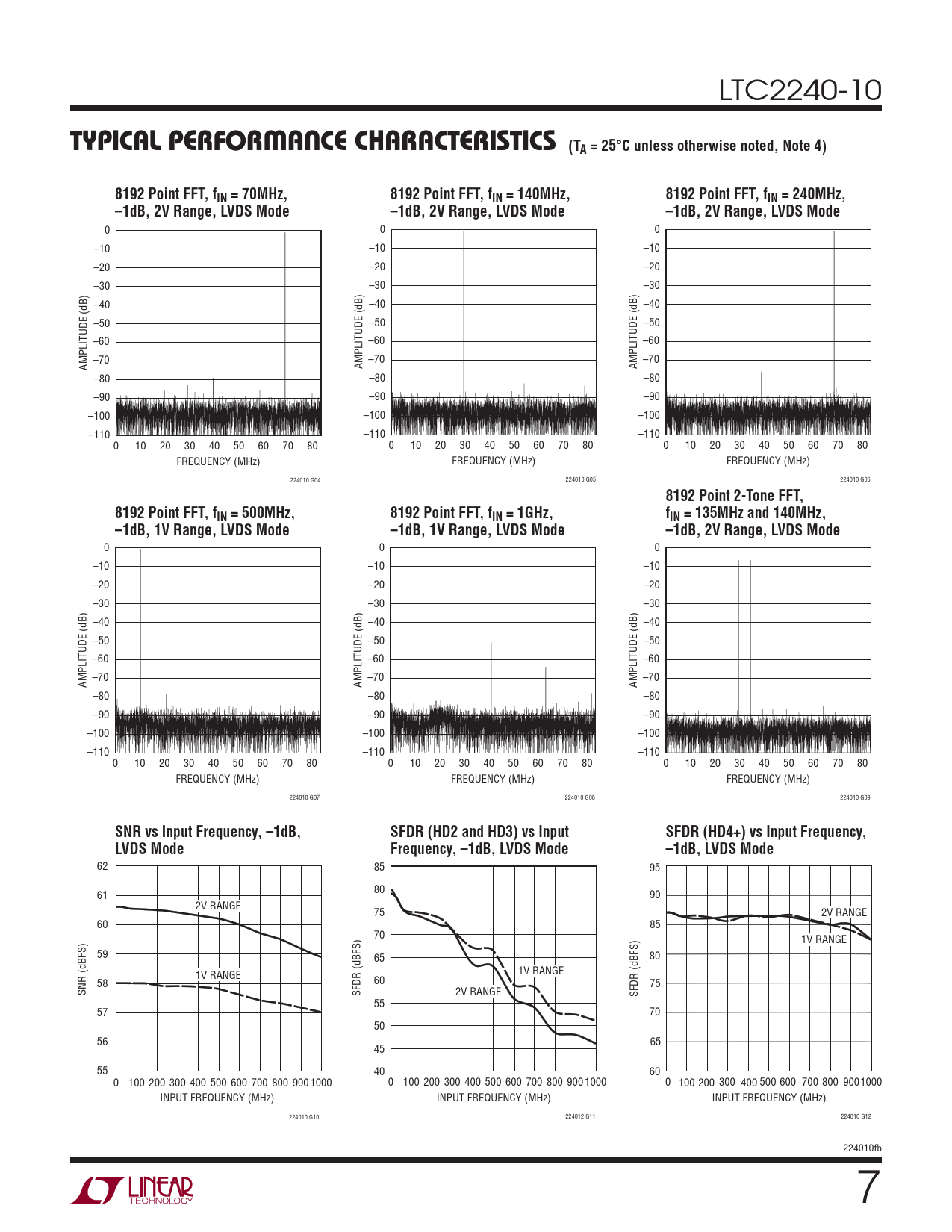

TYPICAL PERFORMANCE CHARACTERISTICS (TA = 25°C unless otherwise noted, Note 4). 8192 Point FFT, fIN = 70MHz,
LTC2240-10
TYPICAL PERFORMANCE CHARACTERISTICS (TA = 25°C unless otherwise noted, Note 4) 8192 Point FFT, fIN = 70MHz, 8192 Point FFT, fIN = 140MHz, 8192 Point FFT, fIN = 240MHz, –1dB, 2V Range, LVDS Mode –1dB, 2V Range, LVDS Mode –1dB, 2V Range, LVDS Mode
0 0 0 –10 –10 –10 –20 –20 –20 –30 –30 –30 –40 –40 –40 –50 –50 –50 –60 –60 –60 –70 –70 –70 AMPLITUDE (dB) AMPLITUDE (dB) AMPLITUDE (dB) –80 –80 –80 –90 –90 –90 –100 –100 –100 –110 –110 –110 0 10 20 30 40 50 60 70 80 0 10 20 30 40 50 60 70 80 0 10 20 30 40 50 60 70 80 FREQUENCY (MHz) FREQUENCY (MHz) FREQUENCY (MHz) 224010 G04 224010 G05 224010 G06
8192 Point 2-Tone FFT, 8192 Point FFT, fIN = 500MHz, 8192 Point FFT, fIN = 1GHz, fIN = 135MHz and 140MHz, –1dB, 1V Range, LVDS Mode –1dB, 1V Range, LVDS Mode –1dB, 2V Range, LVDS Mode
0 0 0 –10 –10 –10 –20 –20 –20 –30 –30 –30 –40 –40 –40 –50 –50 –50 –60 –60 –60 –70 –70 –70 AMPLITUDE (dB) AMPLITUDE (dB) AMPLITUDE (dB) –80 –80 –80 –90 –90 –90 –100 –100 –100 –110 –110 –110 0 10 20 30 40 50 60 70 80 0 10 20 30 40 50 60 70 80 0 10 20 30 40 50 60 70 80 FREQUENCY (MHz) FREQUENCY (MHz) FREQUENCY (MHz) 224010 G07 224010 G08 224010 G09
SNR vs Input Frequency, –1dB, SFDR (HD2 and HD3) vs Input SFDR (HD4+) vs Input Frequency, LVDS Mode Frequency, –1dB, LVDS Mode –1dB, LVDS Mode
62 85 95 80 61 90 2V RANGE 75 2V RANGE 60 85 70 1V RANGE 59 65 80 1V RANGE 1V RANGE 58 60 75 SNR (dBFS) SFDR (dBFS) 2V RANGE SFDR (dBFS) 55 57 70 50 56 65 45 55 40 60 0 100 200 300 400 500 600 700 800 900 1000 0 100 200 300 400 500 600 700 800 900 1000 0 100 200 300 400 500 600 700 800 9001000 INPUT FREQUENCY (MHz) INPUT FREQUENCY (MHz) INPUT FREQUENCY (MHz) 224010 G10 224012 G11 224010 G12 224010fb 7
