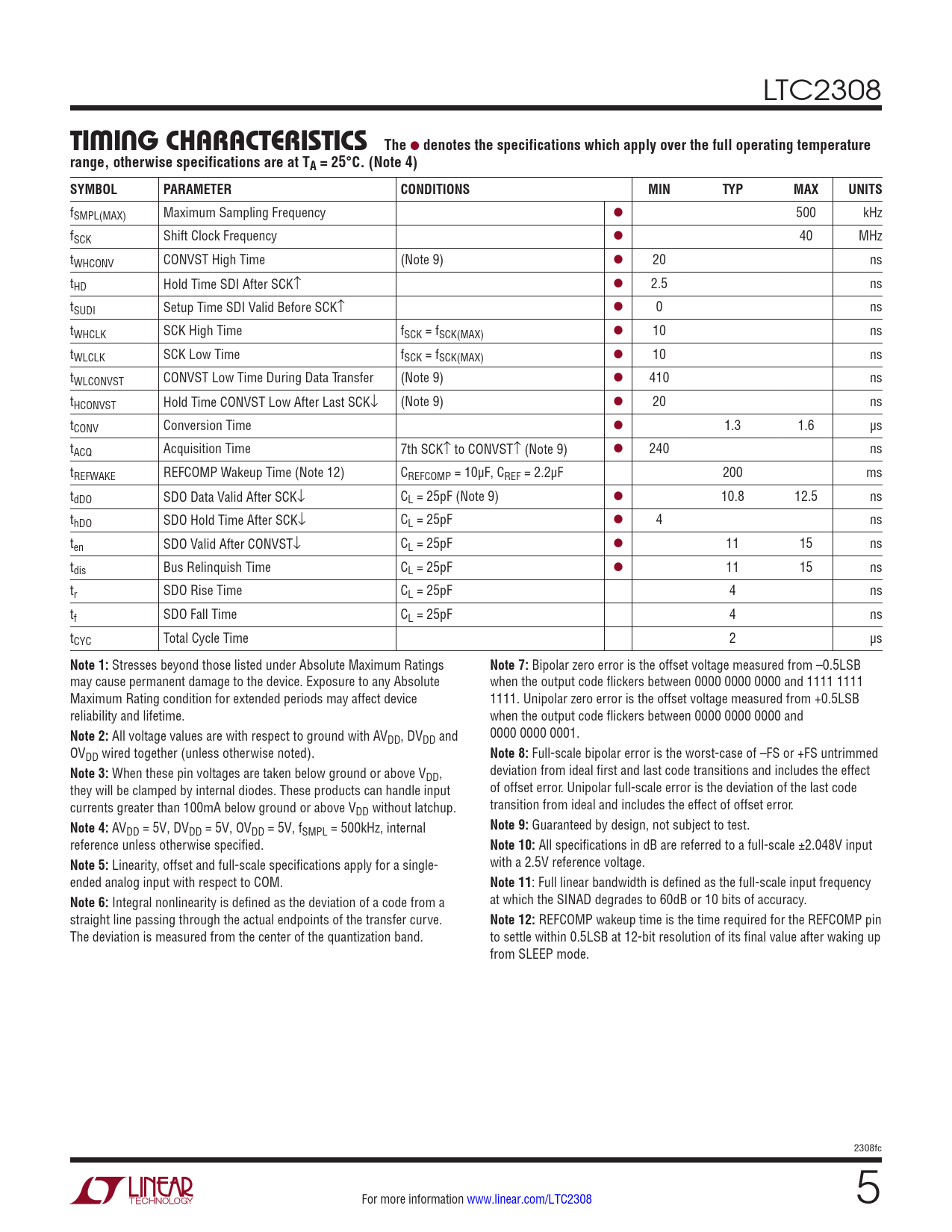

TIMING CHARACTERISTICS. The. denotes the specifications which apply over the full operating temperature
TIMING CHARACTERISTICS The denotes the specifications which apply over the full operating temperature
LTC2308
l
denotes the specifications which apply over the full operating temperature range, otherwise specifications are at TA = 25°C. (Note 4) SYMBOL PARAMETER CONDITIONS MIN TYP MAX UNITS
fSMPL(MAX) Maximum Sampling Frequency l 500 kHz fSCK Shift Clock Frequency l 40 MHz tWHCONV CONVST High Time (Note 9) l 20 ns tHD Hold Time SDI After SCK↑ l 2.5 ns tSUDI Setup Time SDI Valid Before SCK↑ l 0 ns tWHCLK SCK High Time fSCK = fSCK(MAX) l 10 ns tWLCLK SCK Low Time fSCK = fSCK(MAX) l 10 ns tWLCONVST CONVST Low Time During Data Transfer (Note 9) l 410 ns tHCONVST Hold Time CONVST Low After Last SCK↓ (Note 9) l 20 ns tCONV Conversion Time l 1.3 1.6 µs tACQ Acquisition Time 7th SCK↑ to CONVST↑ (Note 9) l 240 ns tREFWAKE REFCOMP Wakeup Time (Note 12) CREFCOMP = 10µF, CREF = 2.2µF 200 ms tdDO SDO Data Valid After SCK↓ CL = 25pF (Note 9) l 10.8 12.5 ns thDO SDO Hold Time After SCK↓ CL = 25pF l 4 ns ten SDO Valid After CONVST↓ CL = 25pF l 11 15 ns tdis Bus Relinquish Time CL = 25pF l 11 15 ns tr SDO Rise Time CL = 25pF 4 ns tf SDO Fall Time CL = 25pF 4 ns tCYC Total Cycle Time 2 µs
Note 1:
Note 7:
Bipolar zero error is the offset voltage measured from –0.5LSB may cause permanent damage to the device. Exposure to any Absolute when the output code flickers between 0000 0000 0000 and 1111 1111 Maximum Rating condition for extended periods may affect device 1111. Unipolar zero error is the offset voltage measured from +0.5LSB reliability and lifetime. when the output code flickers between 0000 0000 0000 and
Note 2:
All voltage values are with respect to ground with AV 0000 0000 0001. DD, DVDD and OVDD wired together (unless otherwise noted).
Note 8:
Full-scale bipolar error is the worst-case of –FS or +FS untrimmed
Note 3:
When these pin voltages are taken below ground or above V deviation from ideal first and last code transitions and includes the effect DD, they will be clamped by internal diodes. These products can handle input of offset error. Unipolar full-scale error is the deviation of the last code currents greater than 100mA below ground or above V transition from ideal and includes the effect of offset error. DD without latchup.
Note 4:
AV
Note 9:
Guaranteed by design, not subject to test. DD = 5V, DVDD = 5V, OVDD = 5V, fSMPL = 500kHz, internal reference unless otherwise specified.
Note 10:
All specifications in dB are referred to a full-scale ±2.048V input
Note 5:
Linearity, offset and full-scale specifications apply for a single- with a 2.5V reference voltage. ended analog input with respect to COM.
Note 11
: Full linear bandwidth is defined as the full-scale input frequency
Note 6:
Integral nonlinearity is defined as the deviation of a code from a at which the SINAD degrades to 60dB or 10 bits of accuracy. straight line passing through the actual endpoints of the transfer curve.
Note 12:
REFCOMP wakeup time is the time required for the REFCOMP pin The deviation is measured from the center of the quantization band. to settle within 0.5LSB at 12-bit resolution of its final value after waking up from SLEEP mode. 2308fc For more information www.linear.com/LTC2308 5
