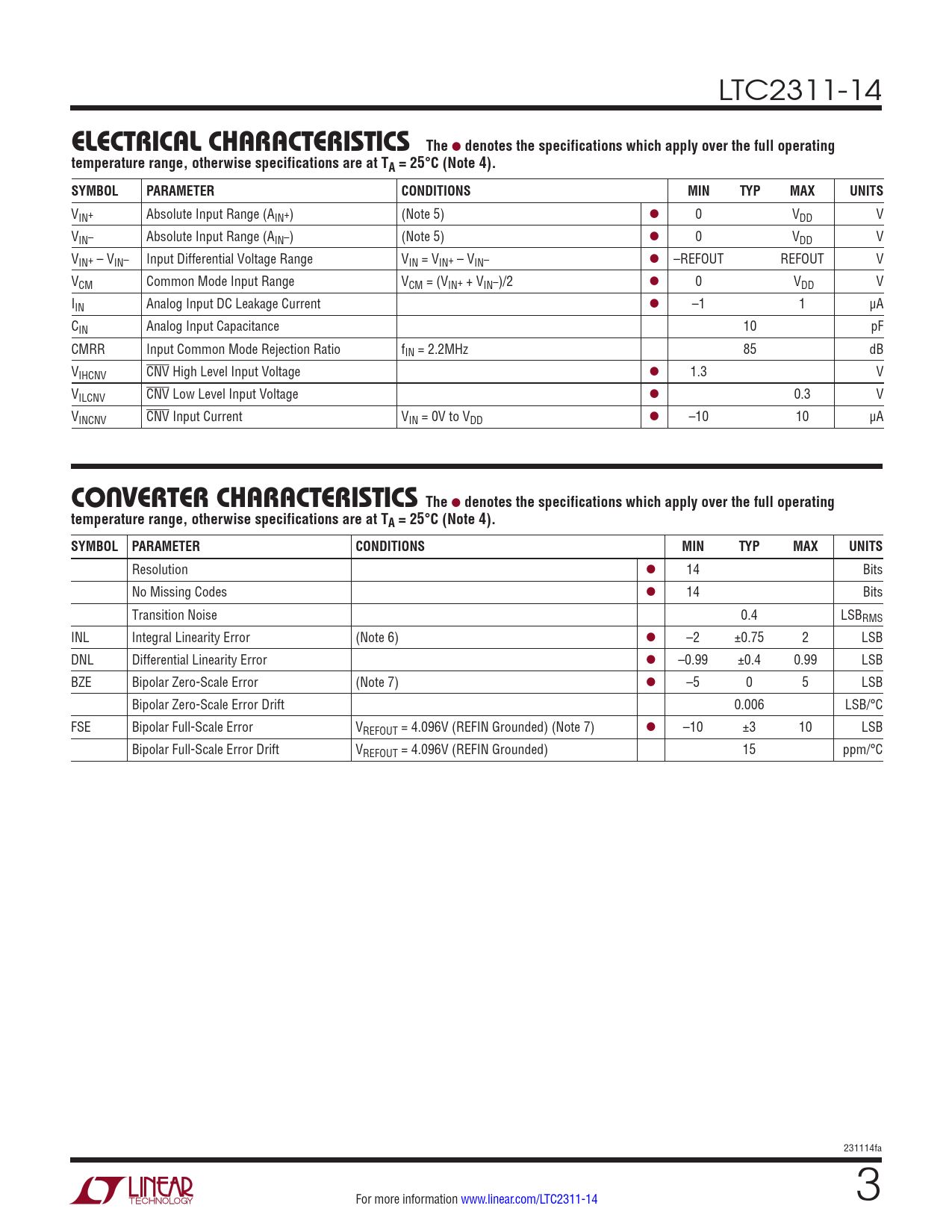

LTC2311-14
l
denotes the specifications which apply over the full operating temperature range, otherwise specifications are at TA = 25°C (Note 4). SYMBOL PARAMETER CONDITIONS MIN TYP MAX UNITS
VIN+ Absolute Input Range (AIN+) (Note 5) l 0 VDD V VIN– Absolute Input Range (AIN–) (Note 5) l 0 VDD V VIN+ – VIN– Input Differential Voltage Range VIN = VIN+ – VIN– l –REFOUT REFOUT V VCM Common Mode Input Range VCM = (VIN+ + VIN–)/2 l 0 VDD V IIN Analog Input DC Leakage Current l –1 1 µA CIN Analog Input Capacitance 10 pF CMRR Input Common Mode Rejection Ratio fIN = 2.2MHz 85 dB VIHCNV CNV High Level Input Voltage l 1.3 V VILCNV CNV Low Level Input Voltage l 0.3 V VINCNV CNV Input Current VIN = 0V to VDD l –10 10 µA
CONVERTER CHARACTERISTICS The
l
Resolution l 14 Bits No Missing Codes l 14 Bits Transition Noise 0.4 LSBRMS INL Integral Linearity Error (Note 6) l –2 ±0.75 2 LSB DNL Differential Linearity Error l –0.99 ±0.4 0.99 LSB BZE Bipolar Zero-Scale Error (Note 7) l –5 0 5 LSB Bipolar Zero-Scale Error Drift 0.006 LSB/°C FSE Bipolar Full-Scale Error VREFOUT = 4.096V (REFIN Grounded) (Note 7) l –10 ±3 10 LSB Bipolar Full-Scale Error Drift VREFOUT = 4.096V (REFIN Grounded) 15 ppm/°C 231114fa For more information www.linear.com/LTC2311-14 3 Document Outline Features Applications Description Typical Application Absolute Maximum Ratings Pin Configuration Electrical Characteristics Converter Characteristics Dynamic Accuracy Internal Reference Characteristics Digital Inputs And Digital Outputs Power Requirements ADC Timing Characteristics Typical Performance Characteristics Functional Block Diagram Timing Diagram Applications Information Package Description Related Parts Features Applications Typical Application Description Absolute Maximum Ratings Order Information Pin Configuration Electrical Characteristics Converter Characteristics Dynamic Accuracy Internal Reference Characteristics Digital Inputs And Digital Outputs Power Requirements ADC Timing Characteristics Typical Performance Characteristics Pin Functions Functional Block Diagram Timing Diagram Applications Information OVERVIEW CONVERTER OPERATION TRANSFER FUNCTION INPUT DRIVE CIRCUITS ADC REFERENCE DYNAMIC PERFORMANCE POWER CONSIDERATIONS TIMING AND CONTROL DIGITAL INTERFACE BOARD LAYOUT Package Description Revision History Typical Application Related Parts
