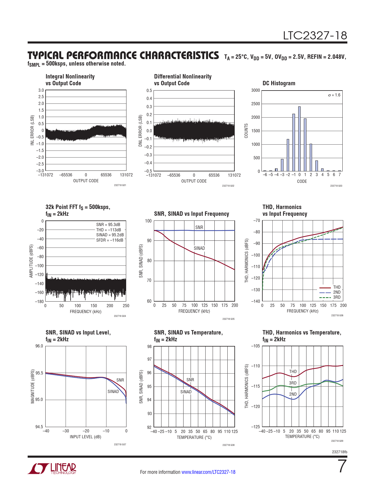

Typical perForMance characTerisTics. TA = 25°C, VDD = 5V, OVDD = 2.5V, REFIN = 2.048V,
LTC2327-18
Typical perForMance characTerisTics TA = 25°C, VDD = 5V, OVDD = 2.5V, REFIN = 2.048V, fSMPL = 500ksps, unless otherwise noted. Integral Nonlinearity Differential Nonlinearity vs Output Code vs Output Code DC Histogram
3.0 0.5 3000 2.5 σ = 1.6 0.4 2.0 2500 0.3 1.5 1.0 0.2 2000 0.5 0.1 0 0.0 1500 –0.5 –0.1 COUNTS INL ERROR (LSB) –1.0 DNL ERROR (LSB) –0.2 1000 –1.5 –2.0 –0.3 500 –2.5 –0.4 –3.0 –0.5 0 –131072 –65536 0 65536 131072 –131072 –65536 0 65536 131072 –6 –5 –4 –3 –2 –1 0 1 2 3 4 5 6 7 OUTPUT CODE OUTPUT CODE CODE 232718 G01 232718 G02 233718 G03
32k Point FFT fS = 500ksps, THD, Harmonics fIN = 2kHz SNR, SINAD vs Input Frequency vs Input Frequency
0 100 –70 SNR = 95.3dB –20 THD = –113dB SNR –80 SINAD = 95.2dB –40 SFDR = –116dB 90 –90 –60 SINAD –80 –100 80 –100 –110 AMPLITUDE (dBFS) –120 SNR, SINAD (dBFS) 70 –120 –140 THD, HARMONICS (dBFS) –130 THD –160 2ND 3RD –180 60 –140 0 50 100 150 200 250 0 25 50 75 100 125 150 175 200 0 25 50 75 100 125 150 175 200 FREQUENCY (kHz) FREQUENCY (kHz) FREQUENCY (kHz) 232718 G04 232718 G06 232718 G05
SNR, SINAD vs Input Level, SNR, SINAD vs Temperature, THD, Harmonics vs Temperature, fIN = 2kHz fIN = 2kHz fIN = 2kHz
96.0 98 –105 97 –110 95.5 96 THD SNR SNR 3RD 95 –115 SINAD SINAD 2ND MAGNITUDE (dBFS) 95.0 SNR, SINAD (dBFS) 94 THD, HARMONICS (dBFS) –120 93 94.5 92 –125 –40 –30 –20 –10 0 –40 –25 –10 5 20 35 50 65 80 95 110 125 –40 –25 –10 5 20 35 50 65 80 95 110 125 INPUT LEVEL (dB) TEMPERATURE (°C) TEMPERATURE (°C) 232718 G09 232718 G07 232718 G08 232718fb For more information www.linear.com/LTC2327-18 7 Document Outline Features Applications Typical Application Description Absolute Maximum Ratings Order Information Pin Configuration Electrical Characteristics Converter Characteristics Dynamic Accuracy Internal Reference Characteristics Reference Buffer Characteristics Digital Inputs and Digital Outputs Power Requirements ADC Timing Characteristics Typical Performance Characteristics Pin Functions Functional Block Diagram Timing Diagram Applications Information Board Layout Package Description Revision History Typical Application Related Parts
