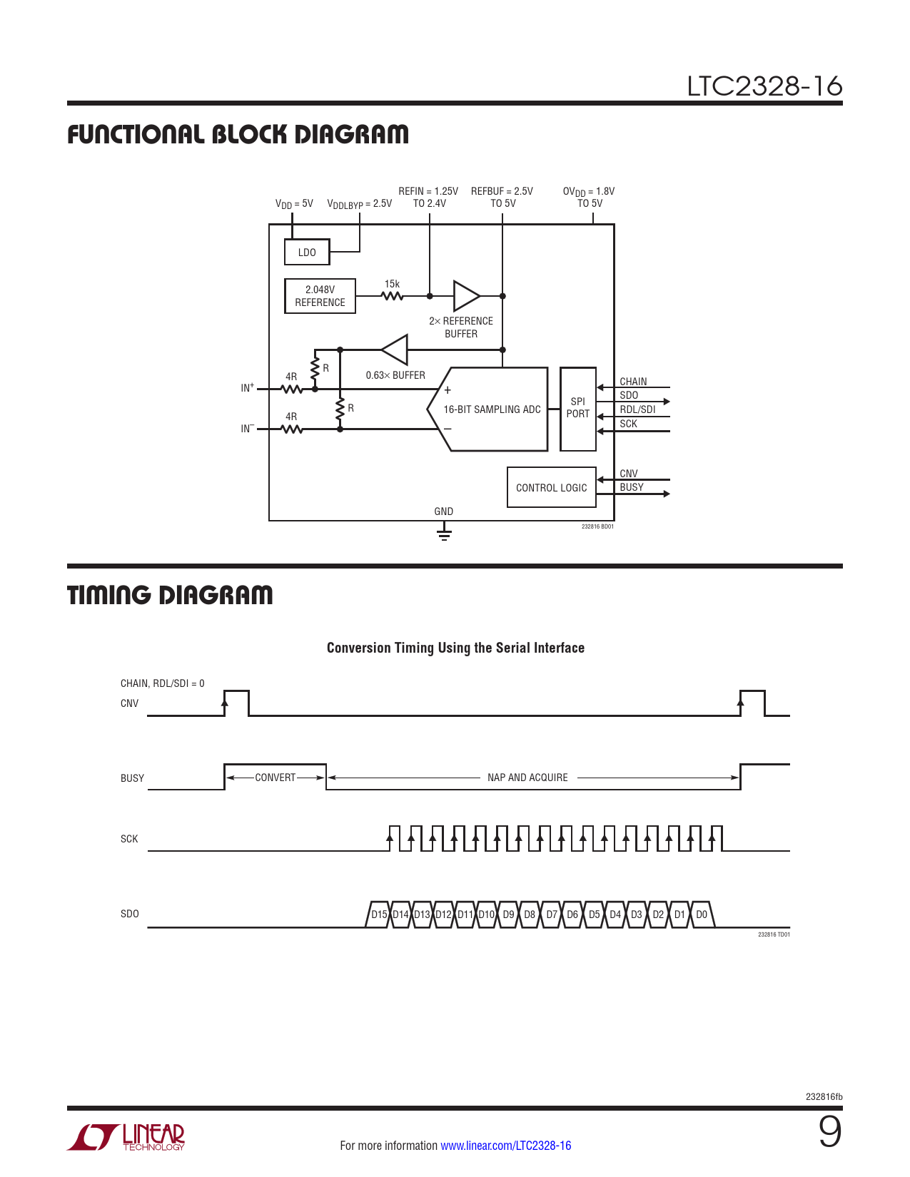

FuncTional block DiagraM
REFIN = 1.25V REFBUF = 2.5V OVDD = 1.8V VDD = 5V VDDLBYP = 2.5V TO 2.4V TO 5V TO 5V LDO 2.048V 15k REFERENCE 2× REFERENCE BUFFER R 4R 0.63× BUFFER CHAIN IN+ + SDO SPI R 16-BIT SAMPLING ADC RDL/SDI PORT 4R IN– SCK – CNV CONTROL LOGIC BUSY GND 232816 BD01
TiMing DiagraM Conversion Timing Using the Serial Interface
CHAIN, RDL/SDI = 0 CNV BUSY CONVERT NAP AND ACQUIRE SCK SDO D15 D14 D13 D12 D11 D10 D9 D8 D7 D6 D5 D4 D3 D2 D1 D0 232816 TD01 232816fb For more information www.linear.com/LTC2328-16 9 Document Outline Features Applications Typical Application Description Absolute Maximum Ratings Order Information Pin Configuration Electrical Characteristics Converter Characteristics Dynamic Accuracy Internal Reference Characteristics Reference Buffer Characteristics Digital Inputs and Digital Outputs Power Requirements ADC Timing Characteristics Typical Performance Characteristics Pin Functions Functional Block Diagram Timing Diagram Applications Information Board Layout Package Description Revision History Typical Application Related Parts
