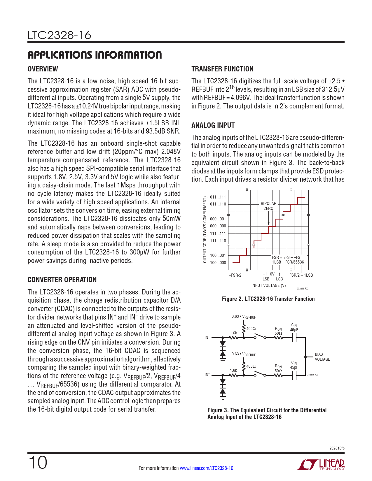

The LTC2328-16 is a low noise, high speed 16-bit suc- The LTC2328-16 digitizes the full-scale voltage of ±2.5 • cessive approximation register (SAR) ADC with pseudo- REFBUF into 216 levels, resulting in an LSB size of 312.5µV differential inputs. Operating from a single 5V supply, the with REFBUF = 4.096V. The ideal transfer function is shown LTC2328-16 has a ±10.24V true bipolar input range, making in Figure 2. The output data is in 2’s complement format. it ideal for high voltage applications which require a wide dynamic range. The LTC2328-16 achieves ±1.5LSB INL
ANALOG INPUT
maximum, no missing codes at 16-bits and 93.5dB SNR. The analog inputs of the LTC2328-16 are pseudo-differen- The LTC2328-16 has an onboard single-shot capable tial in order to reduce any unwanted signal that is common reference buffer and low drift (20ppm/°C max) 2.048V to both inputs. The analog inputs can be modeled by the temperature-compensated reference. The LTC2328-16 equivalent circuit shown in Figure 3. The back-to-back also has a high speed SPI-compatible serial interface that diodes at the inputs form clamps that provide ESD protec- supports 1.8V, 2.5V, 3.3V and 5V logic while also featur- tion. Each input drives a resistor divider network that has ing a daisy-chain mode. The fast 1Msps throughput with no cycle latency makes the LTC2328-16 ideally suited 011...111 for a wide variety of high speed applications. An internal 011...110 BIPOLAR oscillator sets the conversion time, easing external timing ZERO considerations. The LTC2328-16 dissipates only 50mW 000...001 and automatically naps between conversions, leading to 000...000 reduced power dissipation that scales with the sampling 111...111 rate. A sleep mode is also provided to reduce the power 111...110 consumption of the LTC2328-16 to 300μW for further 100...001 power savings during inactive periods. FSR = +FS – –FS OUTPUT CODE (TWO’S COMPLEMENT) 100...000 1LSB = FSR/65536 –FSR/2 –1 0V 1 FSR/2 – 1LSB
CONVERTER OPERATION
LSB LSB INPUT VOLTAGE (V) The LTC2328-16 operates in two phases. During the ac- 232816 F02 quisition phase, the charge redistribution capacitor D/A
Figure 2. LTC2328-16 Transfer Function
converter (CDAC) is connected to the outputs of the resis- tor divider networks that pins IN+ and IN– drive to sample 0.63 • VREFBUF an attenuated and level-shifted version of the pseudo- CIN 400Ω R differential analog input voltage as shown in Figure 3. A ON 45pF 1.6k 50Ω IN+ rising edge on the CNV pin initiates a conversion. During the conversion phase, the 16-bit CDAC is sequenced 0.63 • V through a successive approximation algorithm, effectively REFBUF BIAS VOLTAGE C comparing the sampled input with binary-weighted frac- 400Ω R IN ON 45pF 1.6k 50Ω tions of the reference voltage (e.g. VREFBUF/2, VREFBUF/4 IN– 232816 F03 … VREFBUF/65536) using the differential comparator. At the end of conversion, the CDAC output approximates the sampled analog input. The ADC control logic then prepares the 16-bit digital output code for serial transfer.
Figure 3. The Equivalent Circuit for the Differential Analog Input of the LTC2328-16
