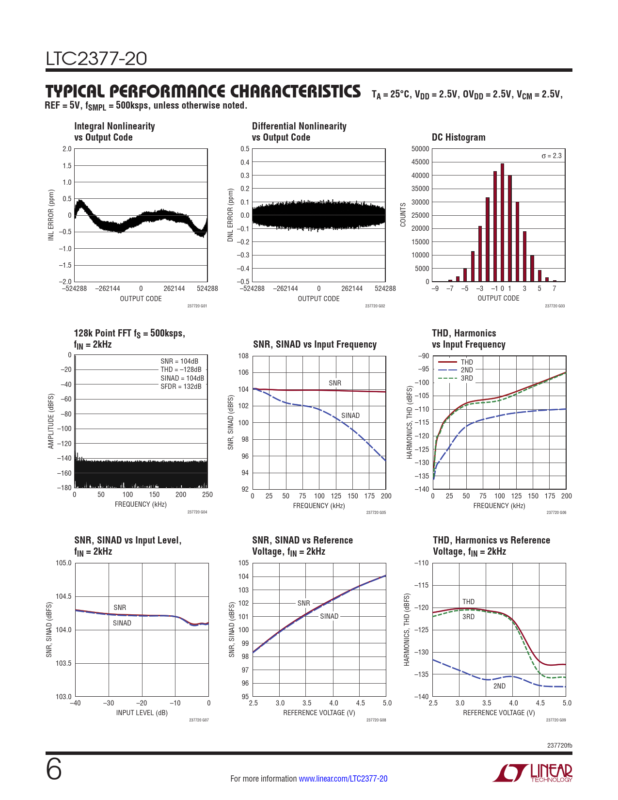

TYPICAL. PERFORMANCE CHARACTERISTICS TA = 25°C, VDD = 2.5V, OVDD = 2.5V, VCM = 2.5V,
LTC2377-20
TYPICAL PERFORMANCE CHARACTERISTICS TA = 25°C, VDD = 2.5V, OVDD = 2.5V, VCM = 2.5V, REF = 5V, fSMPL = 500ksps, unless otherwise noted. Integral Nonlinearity Differential Nonlinearity vs Output Code vs Output Code DC Histogram
2.0 0.5 50000 σ = 2.3 1.5 0.4 45000 0.3 40000 1.0 0.2 35000 0.5 0.1 30000 0 0.0 25000 COUNTS –0.5 –0.1 20000 INL ERROR (ppm) DNL ERROR (ppm) –0.2 15000 –1.0 –0.3 10000 –1.5 –0.4 5000 –2.0 –0.5 0 –524288 –262144 0 262144 524288 –524288 –262144 0 262144 524288 –9 –7 –5 –3 –1 0 1 3 5 7 OUTPUT CODE OUTPUT CODE OUTPUT CODE 237720 G01 237720 G02 237720 G03
128k Point FFT fS = 500ksps, THD, Harmonics fIN = 2kHz SNR, SINAD vs Input Frequency vs Input Frequency
0 108 –90 SNR = 104dB THD –20 THD = –128dB 106 –95 2ND SINAD = 104dB 3RD –40 SNR –100 SFDR = 132dB 104 –105 –60 102 –110 –80 SINAD 100 –115 –100 98 –120 AMPLITUDE (dBFS) –120 SNR, SINAD (dBFS) –125 96 –140 HARMONICS, THD (dBFS) –130 –160 94 –135 –180 92 –140 0 50 100 150 200 250 0 25 50 75 100 125 150 175 200 0 25 50 75 100 125 150 175 200 FREQUENCY (kHz) FREQUENCY (kHz) FREQUENCY (kHz) 237720 G04 237720 G05 237720 G06
SNR, SINAD vs Input Level, SNR, SINAD vs Reference THD, Harmonics vs Reference fIN = 2kHz Voltage, fIN = 2kHz Voltage, fIN = 2kHz
