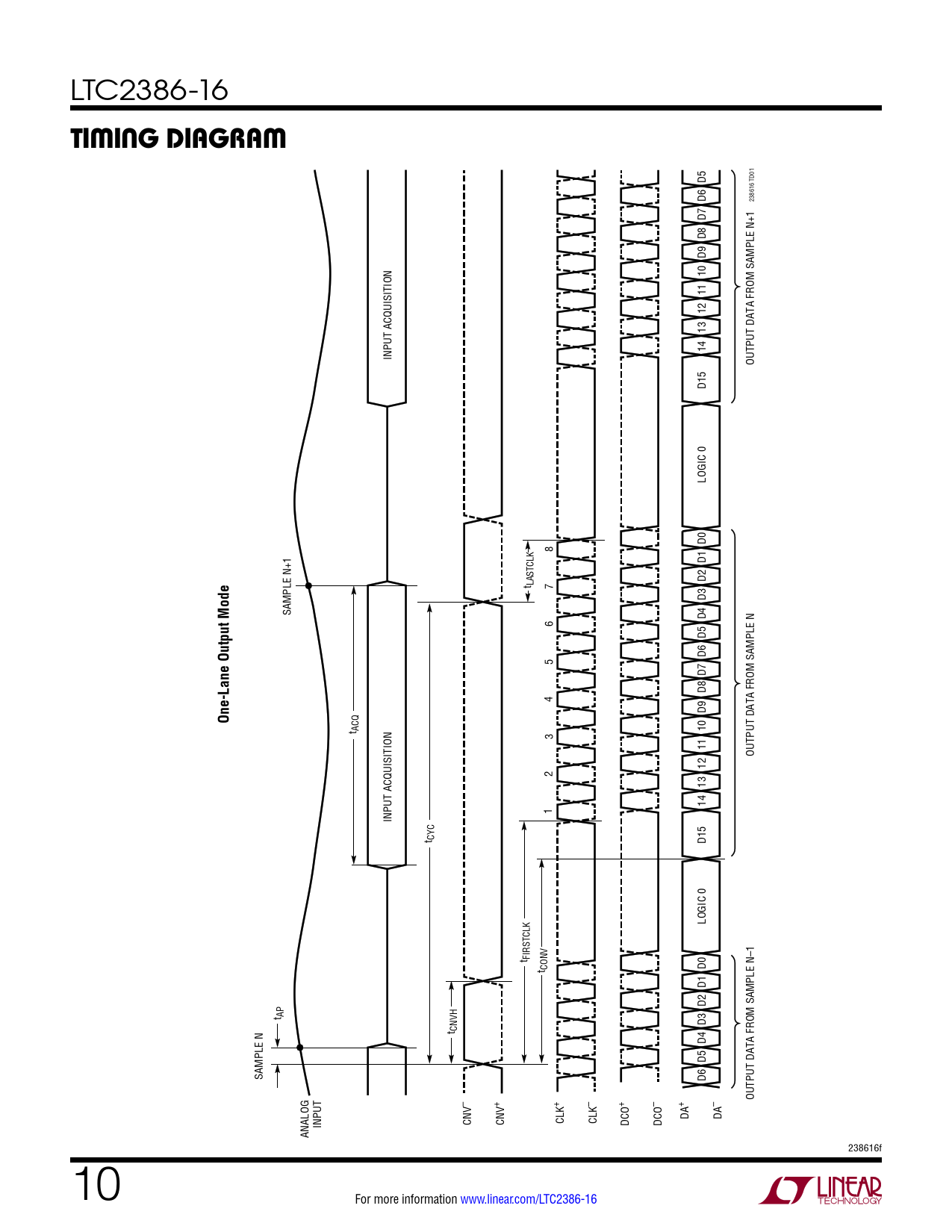

Pages / Page22 / 10 — TiMing DiagraM. One-Lane Output Mode
TiMing DiagraM One-Lane Output Mode
LTC2386-16
TiMing DiagraM
D5 D6 238616 TD01 D7 D8 D9 10 11 12 13 14 INPUT ACQUISITION OUTPUT DATA FROM SAMPLE N+1 D15 LOGIC 0 D0 8 D1 D2 t LASTCLK 7 D3 SAMPLE N+1 D4 6 D5 D6 5 D7 D8 4 D9
10 t ACQ 3 11 OUTPUT DATA FROM SAMPLE N 12 2 13 14 1 INPUT ACQUISITION t CYC D15 LOGIC 0 t FIRSTCLK D0 t CONV D1 D2 t AP D3 t CNVH D4 D5 SAMPLE N D6 OUTPUT DATA FROM SAMPLE N–1 – + + – + – + – DA DA INPUT CNV CNV CLK CLK DCO DCO ANALOG 238616f 10 For more information www.linear.com/LTC2386-16 Document Outline Features Description Applications Typical Application Absolute Maximum Ratings Pin Configuration Order Information Electrical Characteristics Converter Characteristics Dynamic Accuracy Internal Reference Characteristics Reference Buffer Characteristics Digital Inputs and Digital Outputs Power Requirements ADC Timing Characteristics Typical Performance Characteristics Pin Functions Functional Block Diagram Timing Diagram Applications Information Package Description Typical Application Related Parts
