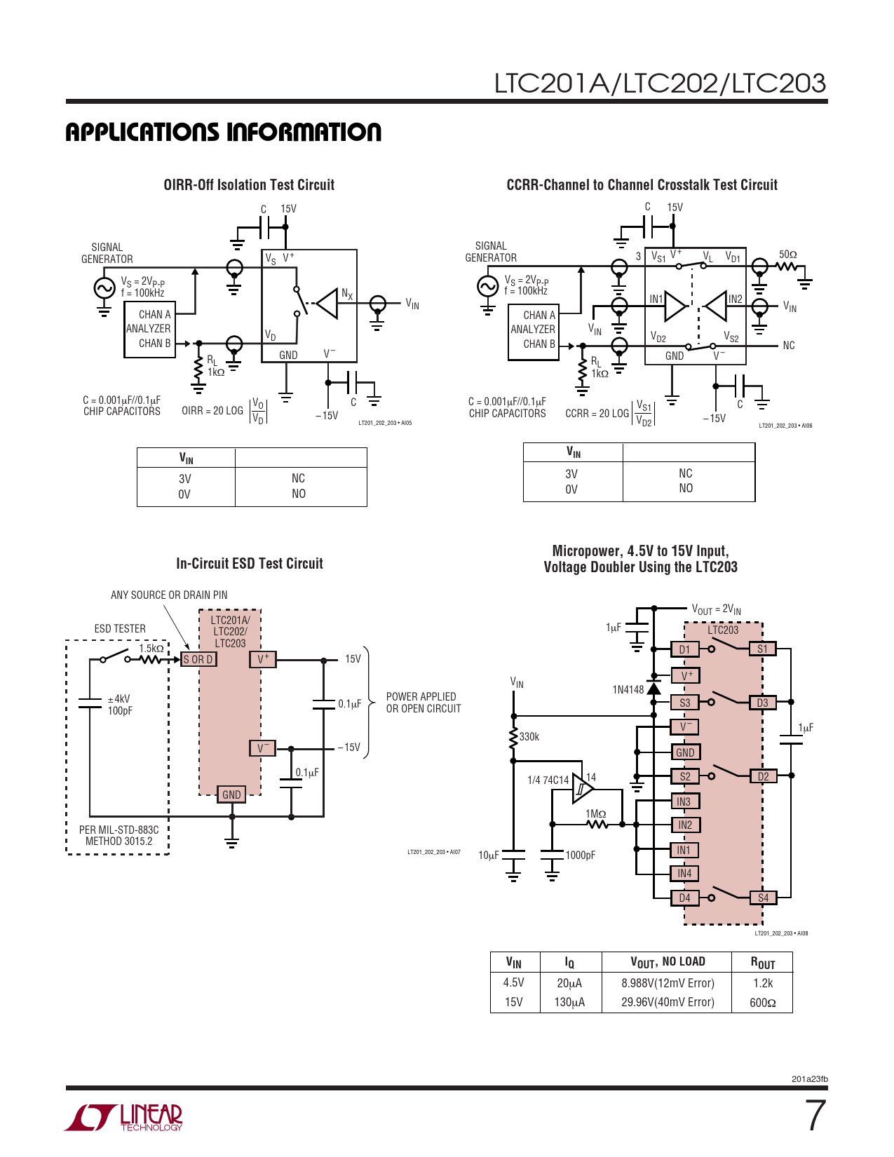

APPLICATIO S I FOR ATIO. OIRR-Off Isolation Test Circuit. CCRR-Channel to Channel Crosstalk Test Circuit. VIN
APPLICATIO S I FOR ATIO OIRR-Off Isolation Test Circuit CCRR-Channel to Channel Crosstalk Test Circuit VIN
LTC201A/LTC202/LTC203
U U W U APPLICATIO S I FOR ATIO OIRR-Off Isolation Test Circuit CCRR-Channel to Channel Crosstalk Test Circuit
C 15V C 15V SIGNAL SIGNAL GENERATOR V V + GENERATOR 3 V V + 50Ω S1 VL VD1 S V V S = 2VP-P S = 2VP-P f = 100kHz f = 100kHz NX IN1 IN2 VIN VIN CHAN A CHAN A ANALYZER ANALYZER VIN VD VD2 VS2 CHAN B CHAN B NC GND V – GND V – RL RL 1kΩ 1kΩ C = 0.001µF//0.1µF V C C = 0.001µF//0.1µF O V C S1 CHIP CAPACITORS OIRR = 20 LOG CHIP CAPACITORS CCRR = 20 LOG V – 15V D LT201_202_203 • AI05 V – 15V D2 LT201_202_203 • AI06
VIN VIN
3V NC 3V NC 0V NO 0V NO
Micropower, 4.5V to 15V Input, In-Circuit ESD Test Circuit Voltage Doubler Using the LTC203
ANY SOURCE OR DRAIN PIN VOUT = 2VIN LTC201A/ ESD TESTER LTC202/ 1µF LTC203 LTC203 1.5kΩ D1 S1 S OR D V + 15V V + VIN 1N4148 ± 4kV POWER APPLIED 0.1µF S3 D3 100pF OR OPEN CIRCUIT V – 1µF 330k V – – 15V GND 0.1µF 14 S2 D2 1/4 74C14 GND IN3 1MΩ PER MIL-STD-883C IN2 METHOD 3015.2 LT201_202_203 • AI07 10µF 1000pF IN1 IN4 D4 S4 LT201_202_203 • AI08
VIN I V R Q OUT, NO LOAD OUT
4.5V 20µA 8.988V(12mV Error) 1.2k 15V 130µA 29.96V(40mV Error) 600Ω 201a23fb 7
