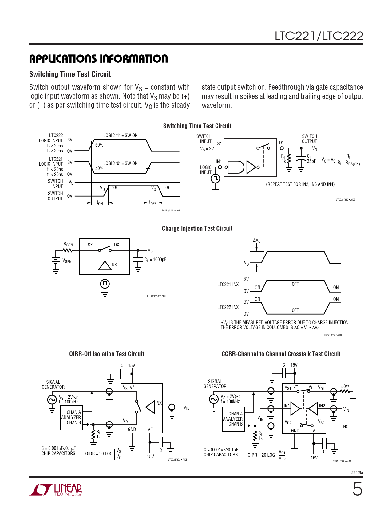

U U W U APPLICATIO S I FOR ATIO Switching Time Test Circuit
Switch output waveform shown for VS = constant with state output switch on. Feedthrough via gate capacitance logic input waveform as shown. Note that VS may be (+) may result in spikes at leading and trailing edge of output or (–) as per switching time test circuit. VO is the steady waveform.
LTC222 LOGIC "1" = SW ON SWITCH SWITCH 3V LOGIC INPUT INPUT OUTPUT t 50% S1 D1 r < 20ns V V t OV S = 2V O r < 20ns R C R LTC221 L L L V 3V 1k 35pF O = VS IN1 LOGIC INPUT LOGIC "0" = SW ON RL+ RDS(ON) t 50% LOGIC r < 20ns t OV INPUT r < 20ns SWITCH VS (REPEAT TEST FOR IN2, IN3 AND IN4) INPUT VO 0.9 V 0.9 O SWITCH OV OUTPUT LTC221/222 • AI02 tON tOFF LTC221/222 • AI01
Charge Injection Test Circuit
∆VO RGEN SX DX VO V C GEN L = 1000pF V INX O 3V LTC221 INX OFF ON ON OV LTC221/222 • AI03 ON ON 3V LTC222 INX OFF OV ∆VO IS THE MEASURED VOLTAGE ERROR DUE TO CHARGE INJECTION. THE ERROR VOLTAGE IN COULOMBS IS ∆Q = VL • ∆VO LTC221/222 • AI04
OIRR-Off Isolation Test Circuit CCRR-Channel to Channel Crosstalk Test Circuit
C 15V C 15V SIGNAL SIGNAL GENERATOR V GENERATOR V 50 S V+ VS1 V+ L V Ω D1 V V S = 2VP-P S = 2Vp-p f = 100kHz INX f = 100kHz V IN1 IN2 IN VIN CHAN A CHAN A ANALYZER V V ANALYZER IN D CHAN B VD2 VS2 CHAN B NC GND V– R GND V– L RL 1k 1k C = 0.001µF//0.1µF V C C = 0.001µF//0.1µF CHIP CAPACITORS S V OIRR = 20 LOG C S1 V –15V CHIP CAPACITORS OIRR = 20 LOG D V –15V LTC221/222 • AI05 D2 LTC221/222 • AI06 2212fa 5
