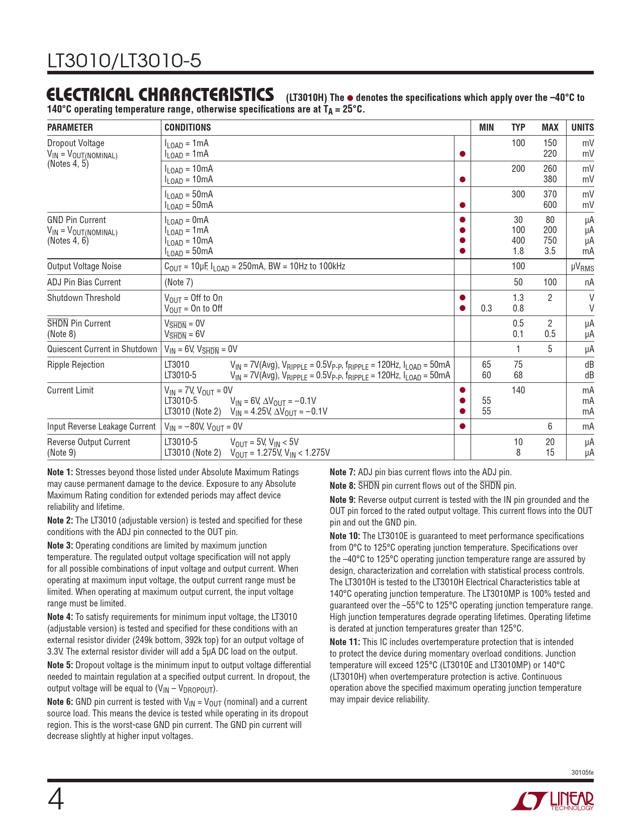

ELECTRICAL CHARACTERISTICS. (LT3010H) The. denotes the specifications which apply over the –40°C to
ELECTRICAL CHARACTERISTICS (LT3010H) The denotes the specifications which apply over the –40°C to
LT3010/LT3010-5
l
denotes the specifications which apply over the –40°C to 140°C operating temperature range, otherwise specifications are at TA = 25°C. PARAMETER CONDITIONS MIN TYP MAX UNITS
Dropout Voltage ILOAD = 1mA 100 150 mV VIN = VOUT(NOMINAL) ILOAD = 1mA l 220 mV (Notes 4, 5) ILOAD = 10mA 200 260 mV ILOAD = 10mA l 380 mV ILOAD = 50mA 300 370 mV ILOAD = 50mA l 600 mV GND Pin Current ILOAD = 0mA l 30 80 µA VIN = VOUT(NOMINAL) ILOAD = 1mA l 100 200 µA (Notes 4, 6) ILOAD = 10mA l 400 750 µA ILOAD = 50mA l 1.8 3.5 mA Output Voltage Noise COUT = 10µF, ILOAD = 250mA, BW = 10Hz to 100kHz 100 µVRMS ADJ Pin Bias Current (Note 7) 50 100 nA Shutdown Threshold VOUT = Off to On l 1.3 2 V VOUT = On to Off l 0.3 0.8 V SHDN Pin Current VSHDN = 0V 0.5 2 µA (Note 8) VSHDN = 6V 0.1 0.5 µA Quiescent Current in Shutdown VIN = 6V, VSHDN = 0V 1 5 µA Ripple Rejection LT3010 VIN = 7V(Avg), VRIPPLE = 0.5VP-P, fRIPPLE = 120Hz, ILOAD = 50mA 65 75 dB LT3010-5 VIN = 7V(Avg), VRIPPLE = 0.5VP-P, fRIPPLE = 120Hz, ILOAD = 50mA 60 68 dB Current Limit VIN = 7V, VOUT = 0V l 140 mA LT3010-5 VIN = 6V, ΔVOUT = –0.1V l 55 mA LT3010 (Note 2) VIN = 4.25V, ΔVOUT = –0.1V l 55 mA Input Reverse Leakage Current VIN = –80V, VOUT = 0V l 6 mA Reverse Output Current LT3010-5 VOUT = 5V, VIN < 5V 10 20 µA (Note 9) LT3010 (Note 2) VOUT = 1.275V, VIN < 1.275V 8 15 µA
Note 1:
Note 7:
ADJ pin bias current flows into the ADJ pin. may cause permanent damage to the device. Exposure to any Absolute
Note 8:
SHDN pin current flows out of the SHDN pin. Maximum Rating condition for extended periods may affect device
Note 9:
Reverse output current is tested with the IN pin grounded and the reliability and lifetime. OUT pin forced to the rated output voltage. This current flows into the OUT
Note 2:
The LT3010 (adjustable version) is tested and specified for these pin and out the GND pin. conditions with the ADJ pin connected to the OUT pin.
Note 10:
The LT3010E is guaranteed to meet performance specifications
Note 3:
Operating conditions are limited by maximum junction from 0°C to 125°C operating junction temperature. Specifications over temperature. The regulated output voltage specification will not apply the –40°C to 125°C operating junction temperature range are assured by for all possible combinations of input voltage and output current. When design, characterization and correlation with statistical process controls. operating at maximum input voltage, the output current range must be The LT3010H is tested to the LT3010H Electrical Characteristics table at limited. When operating at maximum output current, the input voltage 140°C operating junction temperature. The LT3010MP is 100% tested and range must be limited. guaranteed over the –55°C to 125°C operating junction temperature range.
Note 4:
To satisfy requirements for minimum input voltage, the LT3010 High junction temperatures degrade operating lifetimes. Operating lifetime (adjustable version) is tested and specified for these conditions with an is derated at junction temperatures greater than 125°C. external resistor divider (249k bottom, 392k top) for an output voltage of
Note 11:
This IC includes overtemperature protection that is intended 3.3V. The external resistor divider will add a 5µA DC load on the output. to protect the device during momentary overload conditions. Junction
Note 5:
Dropout voltage is the minimum input to output voltage differential temperature will exceed 125°C (LT3010E and LT3010MP) or 140°C needed to maintain regulation at a specified output current. In dropout, the (LT3010H) when overtemperature protection is active. Continuous output voltage will be equal to (VIN – VDROPOUT). operation above the specified maximum operating junction temperature
Note 6:
GND pin current is tested with V may impair device reliability. IN = VOUT (nominal) and a current source load. This means the device is tested while operating in its dropout region. This is the worst-case GND pin current. The GND pin current will decrease slightly at higher input voltages. 30105fe 4 Document Outline Features Applications Description Typical Application Absolute Maximum Ratings Pin Configuration Order Information Electrical Characteristics Typical Performance Characteristics Pin Functions Applications Information Typical Applications Package Description Revision History Typical Application Related Parts
