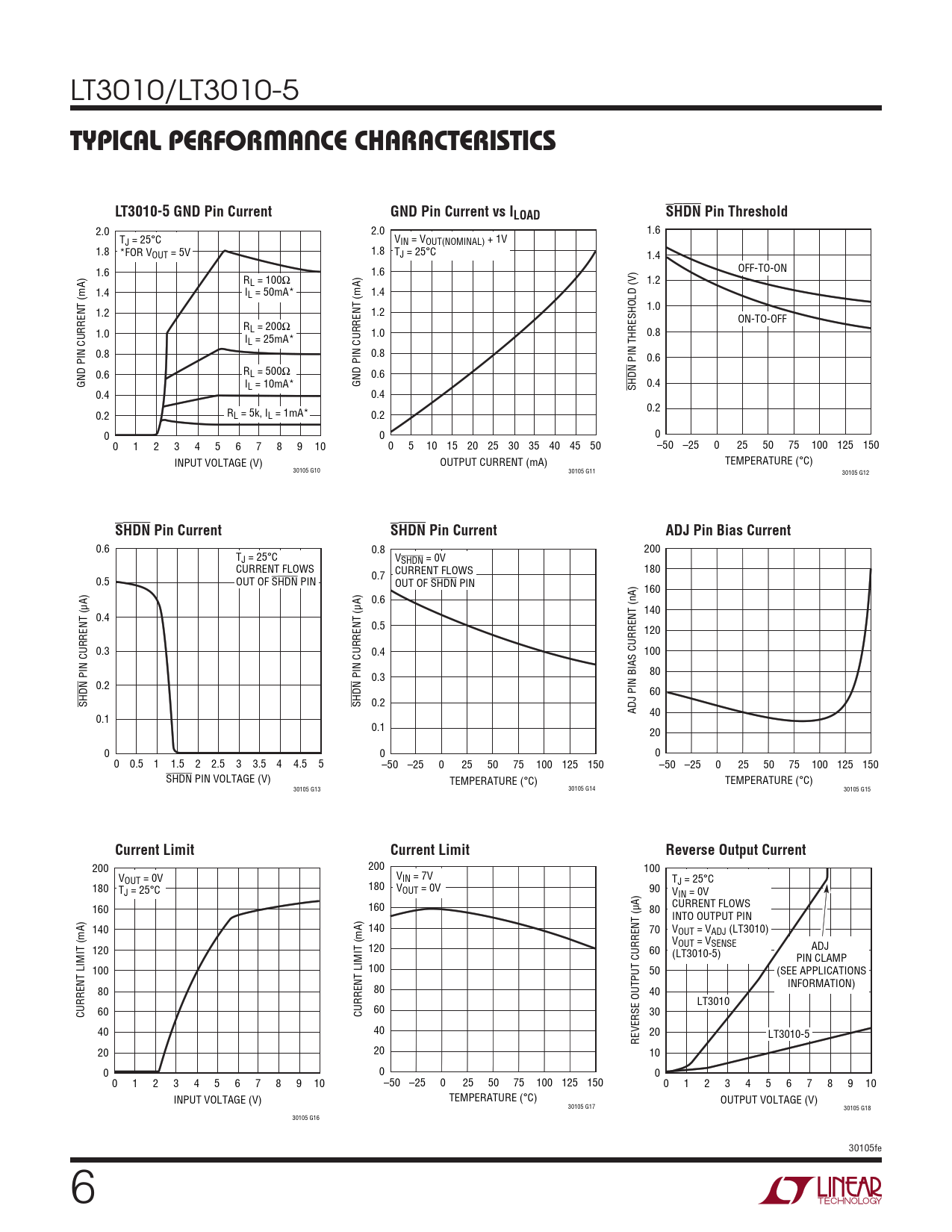

TYPICAL PERFORMANCE CHARACTERISTICS. LT3010-5 GND Pin Current. GND Pin Current vs ILOAD. SHDN Pin Threshold. SHDN Pin Current
LT3010/LT3010-5
TYPICAL PERFORMANCE CHARACTERISTICS LT3010-5 GND Pin Current GND Pin Current vs ILOAD SHDN Pin Threshold
2.0 2.0 1.6 TJ = 25°C VIN = VOUT(NOMINAL) + 1V 1.8 *FOR VOUT = 5V 1.8 TJ = 25°C 1.4 1.6 1.6 OFF-TO-ON RL = 100Ω 1.2 1.4 IL = 50mA* 1.4 1.0 1.2 1.2 ON-TO-OFF R 1.0 L = 200Ω 0.8 I 1.0 L = 25mA* 0.8 0.8 PIN THRESHOLD (V) 0.6 0.6 RL = 500Ω 0.6 GND PIN CURRENT (mA) IL = 10mA* GND PIN CURRENT (mA) SHDN 0.4 0.4 0.4 0.2 0.2 RL = 5k, IL = 1mA* 0.2 0 0 0 0 1 2 3 4 5 6 7 8 9 10 0 5 10 15 20 25 30 35 40 45 50 –50 –25 0 25 50 75 100 125 150 INPUT VOLTAGE (V) OUTPUT CURRENT (mA) TEMPERATURE (°C) 30105 G10 30105 G11 30105 G12
SHDN Pin Current SHDN Pin Current ADJ Pin Bias Current
0.6 0.8 200 TJ = 25°C VSHDN = 0V CURRENT FLOWS CURRENT FLOWS 180 0.5 OUT OF SHDN PIN 0.7 OUT OF SHDN PIN 160 0.6 140 0.4 0.5 120 0.3 0.4 100 PIN CURRENT (µA) PIN CURRENT (µA) 0.3 80 0.2 60 SHDN SHDN 0.2 ADJ PIN BIAS CURRENT (nA) 40 0.1 0.1 20 0 0 0 0 0.5 1 1.5 2 2.5 3 3.5 4 4.5 5 –50 –25 0 25 50 75 100 125 150 –50 –25 0 25 50 75 100 125 150 SHDN PIN VOLTAGE (V) TEMPERATURE (°C) TEMPERATURE (°C) 30105 G13 30105 G14 30105 G15
Current Limit Current Limit Reverse Output Current
200 200 100 VOUT = 0V VIN = 7V TJ = 25°C 180 T 180 J = 25°C VOUT = 0V 90 VIN = 0V 160 160 80 CURRENT FLOWS INTO OUTPUT PIN 140 140 70 VOUT = VADJ (LT3010) V 120 120 60 OUT = VSENSE ADJ (LT3010-5) PIN CLAMP 100 100 50 (SEE APPLICATIONS INFORMATION) 80 80 40 LT3010 CURRENT LIMIT (mA) 60 CURRENT LIMIT (mA) 60 30 40 40 20 REVERSE OUTPUT CURRENT (µA) LT3010-5 20 20 10 0 0 0 0 1 2 3 4 5 6 7 8 9 10 –50 –25 0 25 50 75 100 125 150 0 1 2 3 4 5 6 7 8 9 10 INPUT VOLTAGE (V) TEMPERATURE (°C) OUTPUT VOLTAGE (V) 30105 G17 30105 G18 30105 G16 30105fe 6 Document Outline Features Applications Description Typical Application Absolute Maximum Ratings Pin Configuration Order Information Electrical Characteristics Typical Performance Characteristics Pin Functions Applications Information Typical Applications Package Description Revision History Typical Application Related Parts
