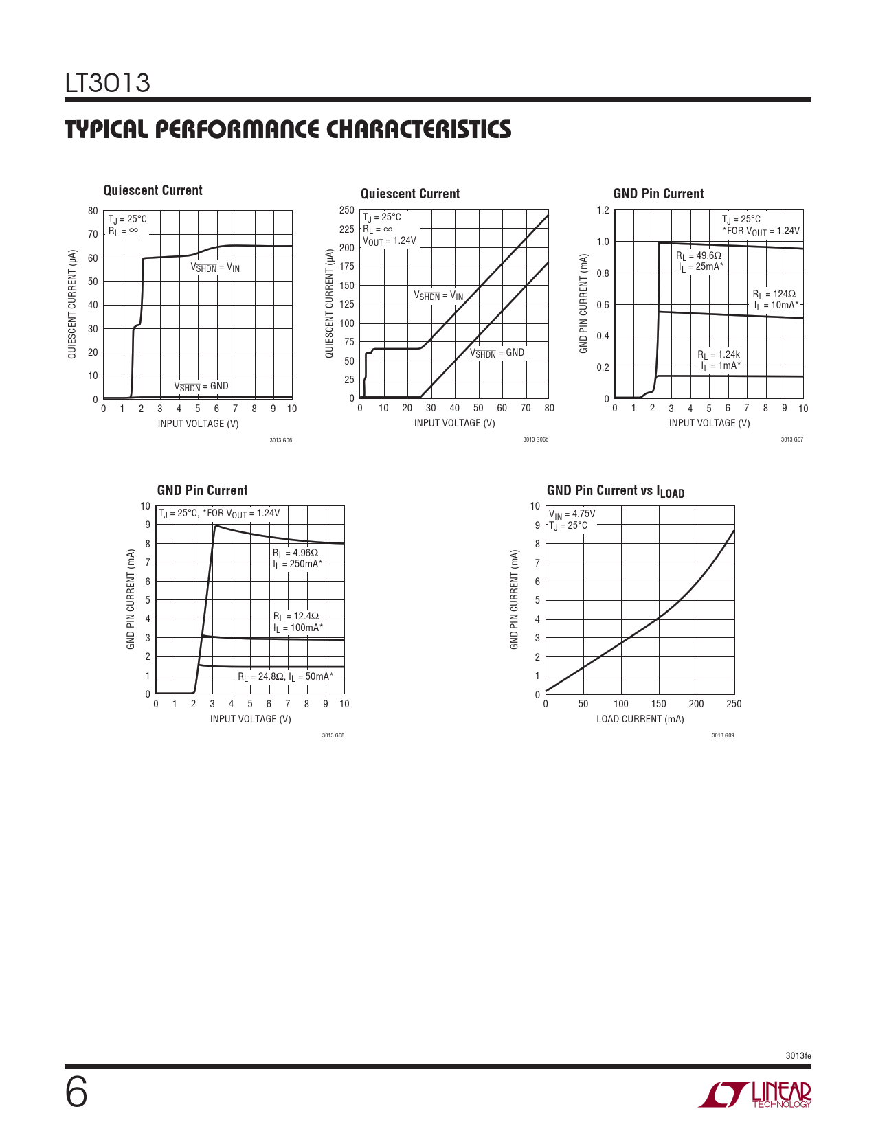

TYPICAL PERFORMANCE CHARACTERISTICS. Quiescent Current. GND Pin Current. GND Pin Current vs ILOAD
TYPICAL PERFORMANCE CHARACTERISTICS Quiescent Current GND Pin Current GND Pin Current vs ILOAD
LT3013
TYPICAL PERFORMANCE CHARACTERISTICS Quiescent Current Quiescent Current GND Pin Current
80 250 1.2 T T J = 25°C J = 25°C TJ = 25°C 225 R 70 RL = ∞ L = ∞ *FOR VOUT = 1.24V VOUT = 1.24V 1.0 200 60 RL = 49.6Ω VSHDN = VIN 175 I 0.8 L = 25mA* 50 150 VSHDN = VIN RL = 124Ω 40 125 0.6 IL = 10mA* 100 30 0.4 75 GND PIN CURRENT (mA) QUIESCENT CURRENT (μA) 20 QUIESCENT CURRENT (μA) VSHDN = GND R 50 L = 1.24k 0.2 IL = 1mA* 10 25 VSHDN = GND 0 0 0 0 1 2 3 4 5 6 7 8 9 10 0 10 20 30 40 50 60 70 80 0 1 2 3 4 5 6 7 8 9 10 INPUT VOLTAGE (V) INPUT VOLTAGE (V) INPUT VOLTAGE (V) 3013 G06 3013 G06b 3013 G07
10 10 TJ = 25°C, *FOR VOUT = 1.24V VIN = 4.75V 9 9 TJ = 25°C 8 8 RL = 4.96Ω 7 I 7 L = 250mA* 6 6 5 5 4 RL = 12.4Ω 4 IL = 100mA* 3 3 GND PIN CURRENT (mA) GND PIN CURRENT (mA) 2 2 1 R 1 L = 24.8Ω, IL = 50mA* 0 0 0 1 2 3 4 5 6 7 8 9 10 0 50 100 150 200 250 INPUT VOLTAGE (V) LOAD CURRENT (mA) 3013 G08 3013 G09 3013fe 6
