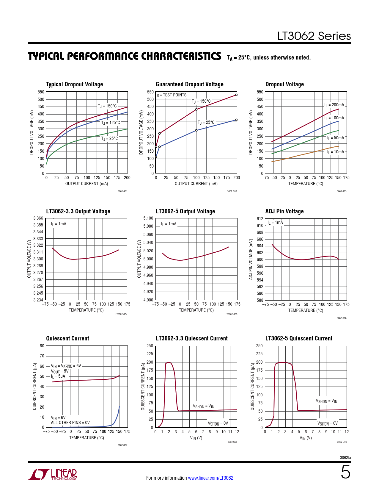

Typical perForMance characTerisTics TA = 25°C, unless otherwise noted. Typical Dropout Voltage. Guaranteed Dropout Voltage
Typical perForMance characTerisTics TA = 25°C, unless otherwise noted Typical Dropout Voltage Guaranteed Dropout Voltage
LT3062 Series
Typical perForMance characTerisTics TA = 25°C, unless otherwise noted. Typical Dropout Voltage Guaranteed Dropout Voltage Dropout Voltage
550 550 550 = TEST POINTS 500 500 T 500 J = 150°C 450 T I J = 150°C 450 450 L = 200mA 400 400 400 I 350 L = 100mA TJ = 125°C 350 TJ = 25°C 350 TAGE (mV) 300 TAGE (mV) 300 TAGE (mV) 300 250 T 250 250 J = 25°C IL = 50mA 200 200 200 DROPOUT VOL 150 DROPOUT VOL 150 DROPOUT VOL 150 IL = 10mA 100 100 100 50 50 50 0 0 0 0 25 50 75 100 125 150 175 200 0 25 50 75 100 125 150 175 200 –75 –50 –25 0 25 50 75 100 125 150 175 OUTPUT CURRENT (mA) OUTPUT CURRENT (mA) TEMPERATURE (°C) 3062 G01 3062 G02 3062 G03
LT3062-3.3 Output Voltage LT3062-5 Output Voltage ADJ Pin Voltage
3.366 5.100 612 I I 3.355 L = 1mA IL = 1mA L = 1mA 5.080 610 3.344 5.060 608 3.333 606 5.040 3.322 604 3.311 5.020 TAGE (V) TAGE (V) 602 3.300 5.000 TAGE (mV) 600 3.289 4.980 598 3.278 596 OUTPUT VOL 4.960 OUTPUT VOL 3.267 ADJ PIN VOL 594 4.940 3.256 592 3.245 4.920 590 3.234 4.900 588 –75 –50 –25 0 25 50 75 100 125 150 175 –75 –50 –25 0 25 50 75 100 125 150 175 –75 –50 –25 0 25 50 75 100 125 150 175 TEMPERATURE (°C) TEMPERATURE (°C) TEMPERATURE (°C) LT3062 G04 LT3062 G05 3062 G06
Quiescent Current LT3062-3.3 Quiescent Current LT3062-5 Quiescent Current
80 250 250 70 225 225 200 200 60 VIN = VSHDN = 6V VOUT = 5V 175 175 50 IL = 5µA 150 150 40 125 125 30 100 100 75 VSHDN = VIN 75 V QUIESCENT CURRENT (µA) 20 SHDN = VIN QUIESCENT CURRENT (µA) 50 QUIESCENT CURRENT (µA) 50 10 VIN = 6V 25 25 ALL OTHER PINS = 0V VSHDN = 0V VSHDN = 0V 0 0 0 –75 –50 –25 0 25 50 75 100 125 150 175 0 1 2 3 4 5 6 7 8 9 10 11 12 0 1 2 3 4 5 6 7 8 9 10 11 12 TEMPERATURE (°C) VIN (V) VIN (V) 3062 G08 3062 G09 3062 G07 3062fa For more information www.linear.com/LT3062 5
