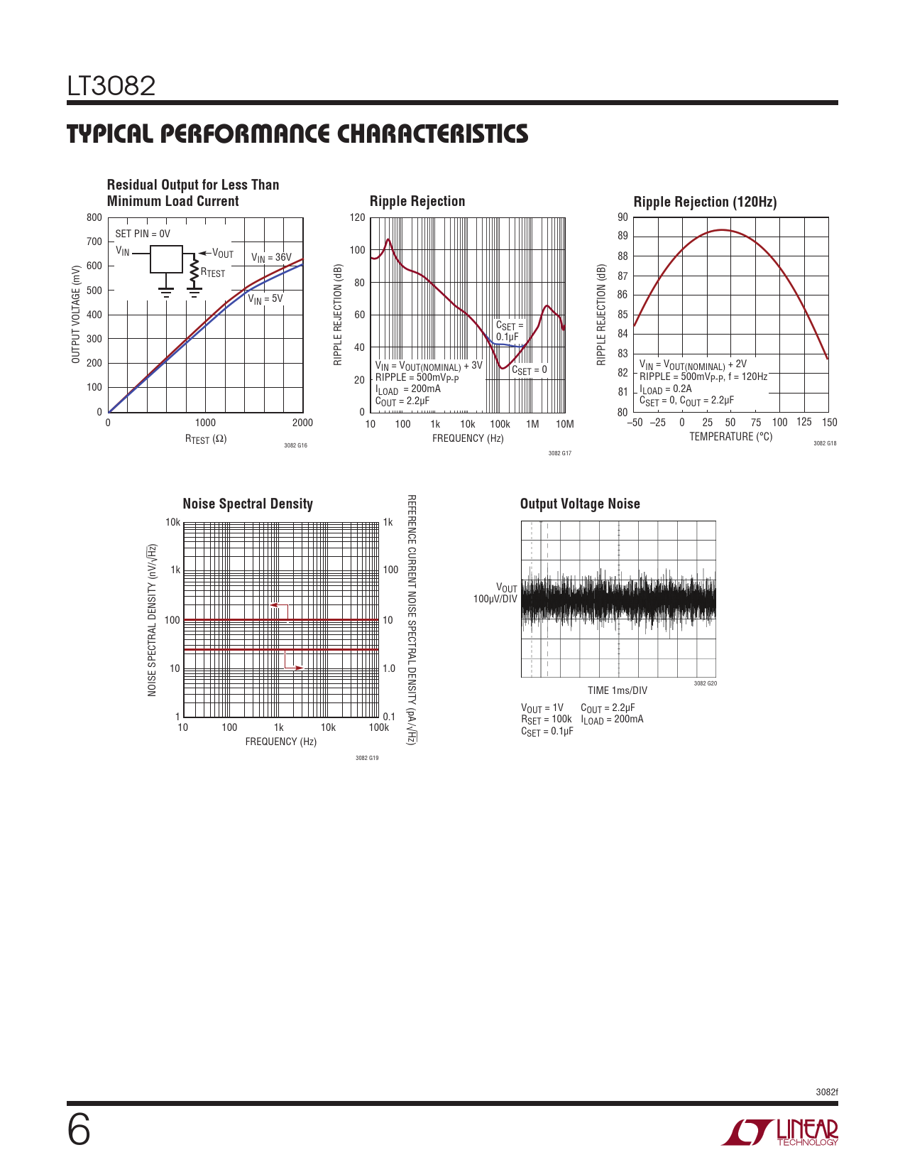

Description200mA Single Resistor Low Dropout Linear Regulator
Pages / Page20 / 6 — TYPICAL PERFORMANCE CHARACTERISTICS. Residual Output for Less Than …
File Format / SizePDF / 301 Kb
TYPICAL PERFORMANCE CHARACTERISTICS. Residual Output for Less Than Minimum Load Current. Ripple Rejection
TYPICAL PERFORMANCE CHARACTERISTICS Residual Output for Less Than Minimum Load Current Ripple Rejection
LT3082
TYPICAL PERFORMANCE CHARACTERISTICS Residual Output for Less Than Minimum Load Current Ripple Rejection Ripple Rejection (120Hz)
800 120 90 SET PIN = 0V 89 700 V 100 IN VOUT V 88 IN = 36V 600 RTEST 87 80 500 86 VIN = 5V TAGE (mV) 400 60 85 CSET = 0.1μF 84 300 40 83 OUTPUT VOL 200 RIPPLE REJECTION (dB) V RIPPLE REJECTION (dB) IN = VOUT(NOMINAL) + 3V V C IN = VOUT(NOMINAL) + 2V SET = 0 82 20 RIPPLE = 500mVP-P RIPPLE = 500mVP-P, f = 120Hz 100 ILOAD = 200mA 81 ILOAD = 0.2A COUT = 2.2μF CSET = 0, COUT = 2.2μF 0 0 80 0 1000 2000 10 100 1k 10k 100k 1M 10M –50 –25 0 25 50 75 100 125 150 R FREQUENCY (Hz) TEMPERATURE (°C) TEST (Ω) 3082 G18 3082 G16 3082 G17 REFERENCE CURRENT NOISE SPECTRAL DENSITY (
Noise Spectral Density Output Voltage Noise
10k 1k VBAT = 3.6V ) ICPO = 200μA Hz CCPO = 2.2ΩF 1k 100 VOUT 100μV/DIV 100 10 10 1.0 3082 G20 NOISE SPECTRAL DENSITY (nV/√ TIME 1ms/DIV p VOUT = 1V COUT = 2.2μF 1 A/ 0.1 √ RSET = 100k ILOAD = 200mA 10 100 1k 10k 100k Hz CSET = 0.1μF FREQUENCY (Hz) 3082 G19 3082f 6
