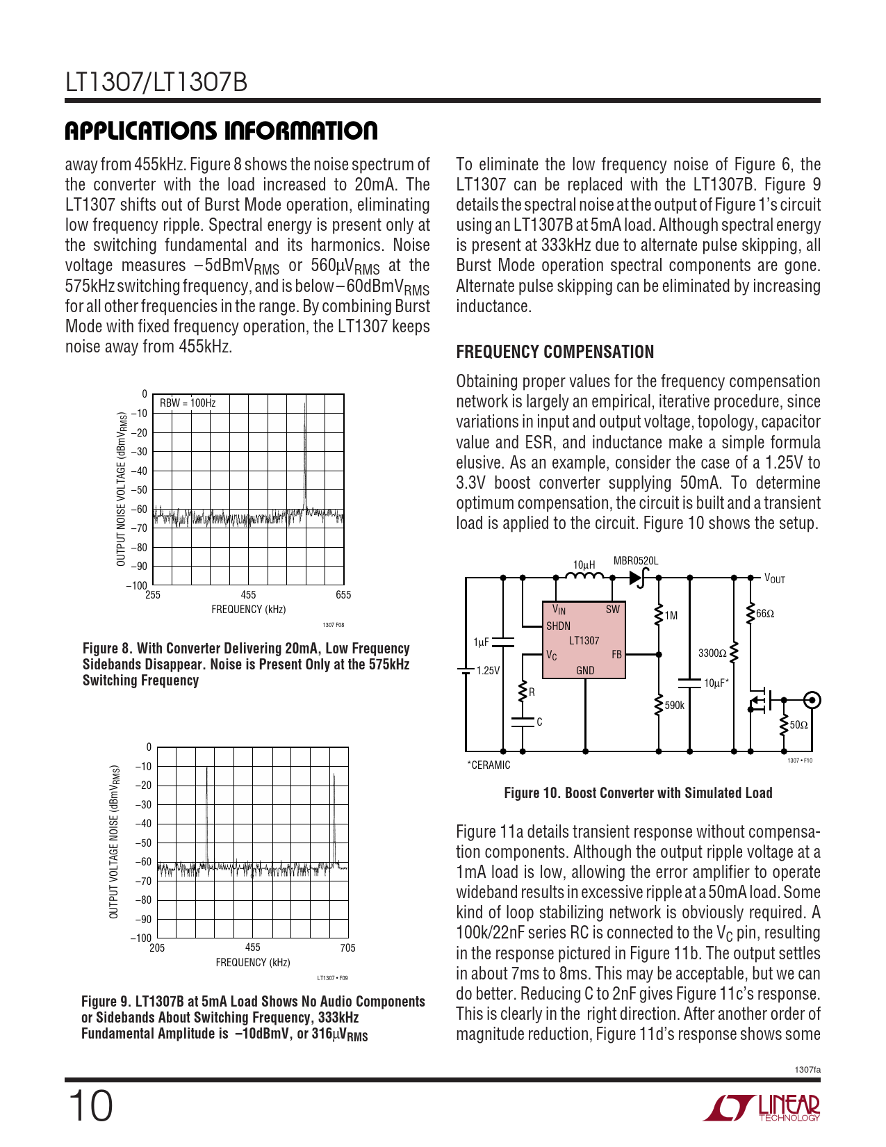

APPLICATIO S I FOR ATIO. FREQUENCY COMPENSATION. Figure 8. With Converter Delivering 20mA, Low Frequency
APPLICATIO S I FOR ATIO FREQUENCY COMPENSATION Figure 8 With Converter Delivering 20mA, Low Frequency
LT1307/LT1307B
U U W U APPLICATIO S I FOR ATIO
away from 455kHz. Figure 8 shows the noise spectrum of To eliminate the low frequency noise of Figure 6, the the converter with the load increased to 20mA. The LT1307 can be replaced with the LT1307B. Figure 9 LT1307 shifts out of Burst Mode operation, eliminating details the spectral noise at the output of Figure 1’s circuit low frequency ripple. Spectral energy is present only at using an LT1307B at 5mA load. Although spectral energy the switching fundamental and its harmonics. Noise is present at 333kHz due to alternate pulse skipping, all voltage measures – 5dBmV Burst Mode operation spectral components are gone. RMS or 560µVRMS at the 575kHz switching frequency, and is below – 60dBmV Alternate pulse skipping can be eliminated by increasing RMS for all other frequencies in the range. By combining Burst inductance. Mode with fixed frequency operation, the LT1307 keeps noise away from 455kHz.

Obtaining proper values for the frequency compensation 0 RBW = 100Hz network is largely an empirical, iterative procedure, since ) –10 variations in input and output voltage, topology, capacitor RMS –20 value and ESR, and inductance make a simple formula –30 elusive. As an example, consider the case of a 1.25V to –40 3.3V boost converter supplying 50mA. To determine –50 optimum compensation, the circuit is built and a transient –60 –70 load is applied to the circuit. Figure 10 shows the setup. –80 OUTPUT NOISE VOLTAGE (dBmV –90 10µH MBR0520L VOUT –100255 455 655 FREQUENCY (kHz) VIN SW 1M 66Ω 1307 F08 SHDN 1µF LT1307

Sidebands Disappear. Noise is Present Only at the 575kHz

Switching Frequency

Figure 9. LT1307B at 5mA Load Shows No Audio Components or Sidebands About Switching Frequency, 333kHz

Fundamental Amplitude is –10dBmV, or 316

VRMS
