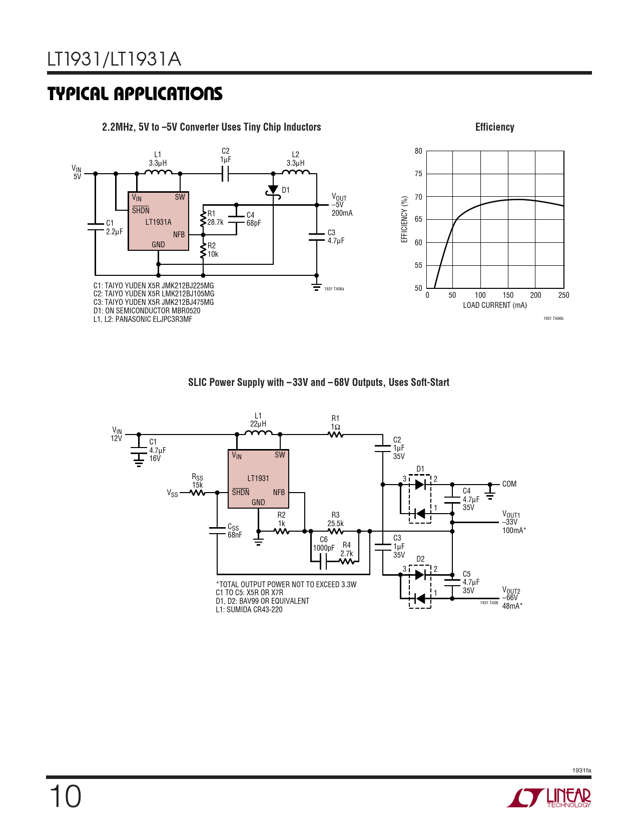

Description1.2MHz/2.2MHz Inverting DC/DC Converters in ThinSOT

TYPICAL APPLICATIO S. 2.2MHz, 5V to –5V Converter Uses Tiny Chip Inductors. Efficiency
TYPICAL APPLICATIO S 2.2MHz, 5V to –5V Converter Uses Tiny Chip Inductors Efficiency
LT1931/LT1931A
U TYPICAL APPLICATIO S 2.2MHz, 5V to –5V Converter Uses Tiny Chip Inductors Efficiency
C2 80 L1 L2 1µF 3.3µH 3.3µH VIN 5V 75 D1 VIN SW VOUT 70 –5V SHDN R1 200mA C4 65 C1 LT1931A 28.7k 68pF 2.2µF C3 NFB 4.7µF EFFICIENCY (%) GND R2 60 10k 55 C1: TAIYO YUDEN X5R JMK212BJ225MG 1931 TA06a 50 C2: TAIYO YUDEN X5R LMK212BJ105MG 0 50 100 150 200 250 C3: TAIYO YUDEN X5R JMK212BJ475MG LOAD CURRENT (mA) D1: ON SEMICONDUCTOR MBR0520 L1, L2: PANASONIC ELJPC3R3MF 1931 TA06b
SLIC Power Supply with – 33V and – 68V Outputs, Uses Soft-Start
