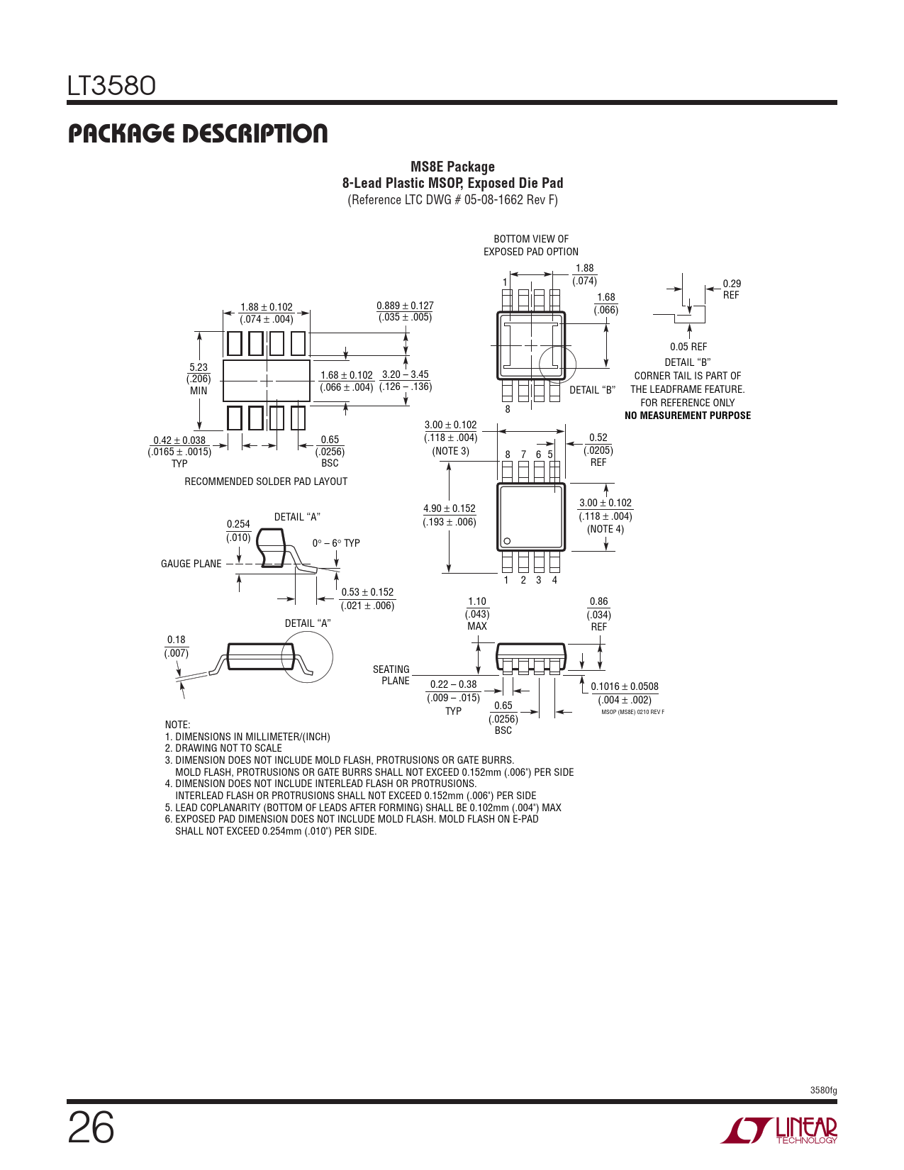

PACKAGE DESCRIPTION. MS8E Package. 8-Lead Plastic MSOP, Exposed Die Pad. NO MEASUREMENT PURPOSE
PACKAGE DESCRIPTION MS8E Package 8-Lead Plastic MSOP, Exposed Die Pad NO MEASUREMENT PURPOSE
LT3580
(Reference LTC DWG # 05-08-1662 Rev F) BOTTOM VIEW OF EXPOSED PAD OPTION 1.88 1 (.074) 0.29 1.68 REF 1.88 p 0.102 0.889 p 0.127 (.066) (.074 p .004) (.035 p .005) 0.05 REF 5.23 DETAIL “B” (.206) 1.68 p 0.102 3.20 – 3.45 CORNER TAIL IS PART OF MIN (.066 p .004) (.126 – .136) DETAIL “B” THE LEADFRAME FEATURE. FOR REFERENCE ONLY 8
3.00 p 0.102 (.118 0.65 p .004) 0.52 0.42 p 0.038 (.0165 p .0015) (.0256) (NOTE 3) 8 7 6 5 (.0205) TYP BSC REF RECOMMENDED SOLDER PAD LAYOUT 3.00 p 0.102 4.90 p 0.152 DETAIL “A” (.118 p .004) 0.254 (.193 p .006) (NOTE 4) (.010) 0o – 6o TYP GAUGE PLANE 1 2 3 4 0.53 p 0.152 (.021 p .006) 1.10 0.86 (.043) (.034) DETAIL “A” MAX REF 0.18 (.007) SEATING PLANE 0.22 – 0.38 0.1016 p 0.0508 (.009 – .015) (.004 p .002) 0.65 TYP MSOP (MS8E) 0210 REV F (.0256) NOTE: BSC 1. DIMENSIONS IN MILLIMETER/(INCH) 2. DRAWING NOT TO SCALE 3. DIMENSION DOES NOT INCLUDE MOLD FLASH, PROTRUSIONS OR GATE BURRS. MOLD FLASH, PROTRUSIONS OR GATE BURRS SHALL NOT EXCEED 0.152mm (.006") PER SIDE 4. DIMENSION DOES NOT INCLUDE INTERLEAD FLASH OR PROTRUSIONS. INTERLEAD FLASH OR PROTRUSIONS SHALL NOT EXCEED 0.152mm (.006") PER SIDE 5. LEAD COPLANARITY (BOTTOM OF LEADS AFTER FORMING) SHALL BE 0.102mm (.004") MAX 6. EXPOSED PAD DIMENSION DOES NOT INCLUDE MOLD FLASH. MOLD FLASH ON E-PAD SHALL NOT EXCEED 0.254mm (.010") PER SIDE. 3580fg 26
