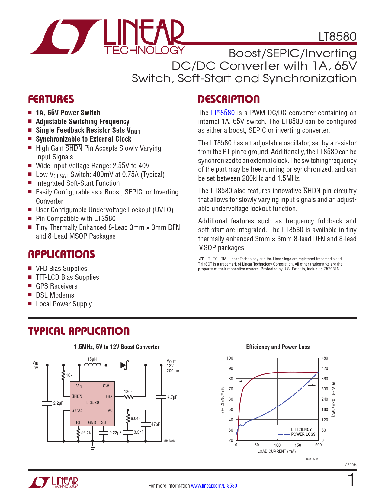

n
1A, 65V Power Switch
The LT®8580 is a PWM DC/DC converter containing an n
Adjustable Switching Frequency
internal 1A, 65V switch. The LT8580 can be configured n
Single Feedback Resistor Sets VOUT
as either a boost, SEPIC or inverting converter. n
Synchronizable to External Clock
The LT8580 has an adjustable oscillator, set by a resistor n High Gain SHDN Pin Accepts Slowly Varying from the RT pin to ground. Additionally, the LT8580 can be Input Signals synchronized to an external clock. The switching frequency n Wide Input Voltage Range: 2.55V to 40V of the part may be free running or synchronized, and can n Low VCESAT Switch: 400mV at 0.75A (Typical) be set between 200kHz and 1.5MHz. n Integrated Soft-Start Function n Easily Configurable as a Boost, SEPIC, or Inverting The LT8580 also features innovative SHDN pin circuitry Converter that allows for slowly varying input signals and an adjust- n User Configurable Undervoltage Lockout (UVLO) able undervoltage lockout function. n Pin Compatible with LT3580 Additional features such as frequency foldback and n Tiny Thermally Enhanced 8-Lead 3mm × 3mm DFN soft-start are integrated. The LT8580 is available in tiny and 8-Lead MSOP Packages thermally enhanced 3mm × 3mm 8-lead DFN and 8-lead
applicaTions
MSOP packages. L, LT, LTC, LTM, Linear Technology and the Linear logo are registered trademarks and ThinSOT is a trademark of Linear Technology Corporation. All other trademarks are the n VFD Bias Supplies property of their respective owners. Protected by U.S. Patents, including 7579816. n TFT-LCD Bias Supplies n GPS Receivers n DSL Modems n Local Power Supply
Typical applicaTion 1.5MHz, 5V to 12V Boost Converter Efficiency and Power Loss
