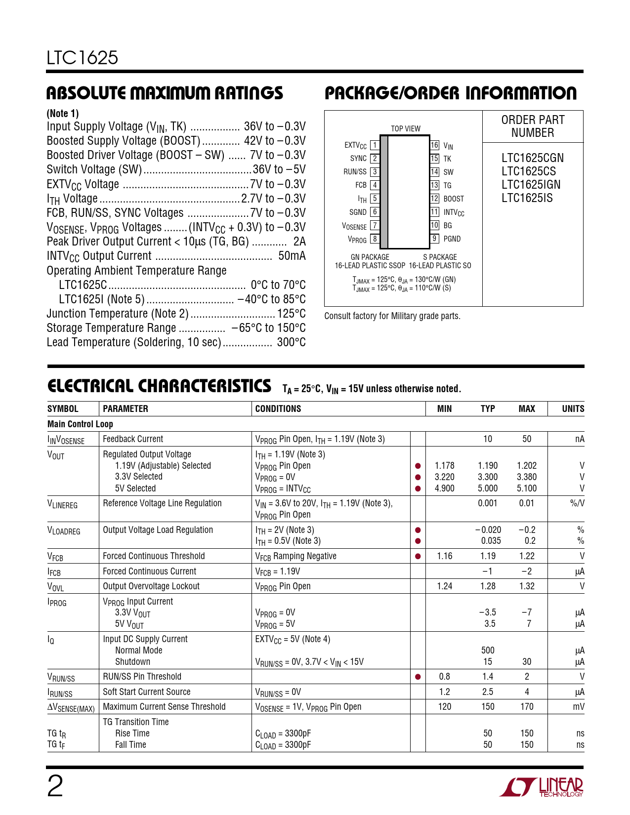

ABSOLUTE MAXIMUM RATINGS. PACKAGE/ORDER I FOR ATIO. (Note 1). ELECTRICAL CHARACTERISTICS TA = 25
ABSOLUTE MAXIMUM RATINGS PACKAGE/ORDER I FOR ATIO (Note 1) ELECTRICAL CHARACTERISTICS TA = 25
LTC1625
W W W U U W U ABSOLUTE MAXIMUM RATINGS PACKAGE/ORDER I FOR ATIO (Note 1)
ORDER PART Input Supply Voltage (VIN, TK) ... 36V to – 0.3V TOP VIEW NUMBER Boosted Supply Voltage (BOOST) ... 42V to – 0.3V EXTV 1 16 CC VIN Boosted Driver Voltage (BOOST – SW) .. 7V to – 0.3V SYNC 2 15 TK LTC1625CGN Switch Voltage (SW)...36V to – 5V RUN/SS 3 14 SW LTC1625CS EXTVCC Voltage ...7V to – 0.3V FCB 4 13 TG LTC1625IGN ITH Voltage ..2.7V to – 0.3V I 5 12 TH BOOST LTC1625IS FCB, RUN/SS, SYNC Voltages ...7V to – 0.3V SGND 6 11 INTVCC V V 7 10 BG OSENSE, VPROG Voltages .. (INTVCC + 0.3V) to – 0.3V OSENSE Peak Driver Output Current < 10µs (TG, BG) .. 2A V 8 9 PROG PGND INTVCC Output Current .. 50mA GN PACKAGE S PACKAGE Operating Ambient Temperature Range 16-LEAD PLASTIC SSOP 16-LEAD PLASTIC SO LTC1625C... 0°C to 70°C TJMAX = 125°C, θJA = 130°C/W (GN) TJMAX = 125°C, θJA = 110°C/W (S) LTC1625I (Note 5) .. – 40°C to 85°C Junction Temperature (Note 2) ... 125°C Consult factory for Military grade parts. Storage Temperature Range .. – 65°C to 150°C Lead Temperature (Soldering, 10 sec)... 300°C
C, VIN = 15V unless otherwise noted. SYMBOL PARAMETER CONDITIONS MIN TYP MAX UNITS Main Control Loop
IINVOSENSE Feedback Current VPROG Pin Open, ITH = 1.19V (Note 3) 10 50 nA VOUT Regulated Output Voltage ITH = 1.19V (Note 3) 1.19V (Adjustable) Selected VPROG Pin Open ● 1.178 1.190 1.202 V 3.3V Selected VPROG = 0V ● 3.220 3.300 3.380 V 5V Selected VPROG = INTVCC ● 4.900 5.000 5.100 V VLINEREG Reference Voltage Line Regulation VIN = 3.6V to 20V, ITH = 1.19V (Note 3), 0.001 0.01 %/V VPROG Pin Open VLOADREG Output Voltage Load Regulation ITH = 2V (Note 3) ● – 0.020 – 0.2 % ITH = 0.5V (Note 3) ● 0.035 0.2 % VFCB Forced Continuous Threshold VFCB Ramping Negative ● 1.16 1.19 1.22 V IFCB Forced Continuous Current VFCB = 1.19V – 1 – 2 µA VOVL Output Overvoltage Lockout VPROG Pin Open 1.24 1.28 1.32 V IPROG VPROG Input Current 3.3V VOUT VPROG = 0V – 3.5 – 7 µA 5V VOUT VPROG = 5V 3.5 7 µA IQ Input DC Supply Current EXTVCC = 5V (Note 4) Normal Mode 500 µA Shutdown VRUN/SS = 0V, 3.7V < VIN < 15V 15 30 µA VRUN/SS RUN/SS Pin Threshold ● 0.8 1.4 2 V IRUN/SS Soft Start Current Source VRUN/SS = 0V 1.2 2.5 4 µA ∆VSENSE(MAX) Maximum Current Sense Threshold VOSENSE = 1V, VPROG Pin Open 120 150 170 mV TG Transition Time TG tR Rise Time CLOAD = 3300pF 50 150 ns TG tF Fall Time CLOAD = 3300pF 50 150 ns 2
