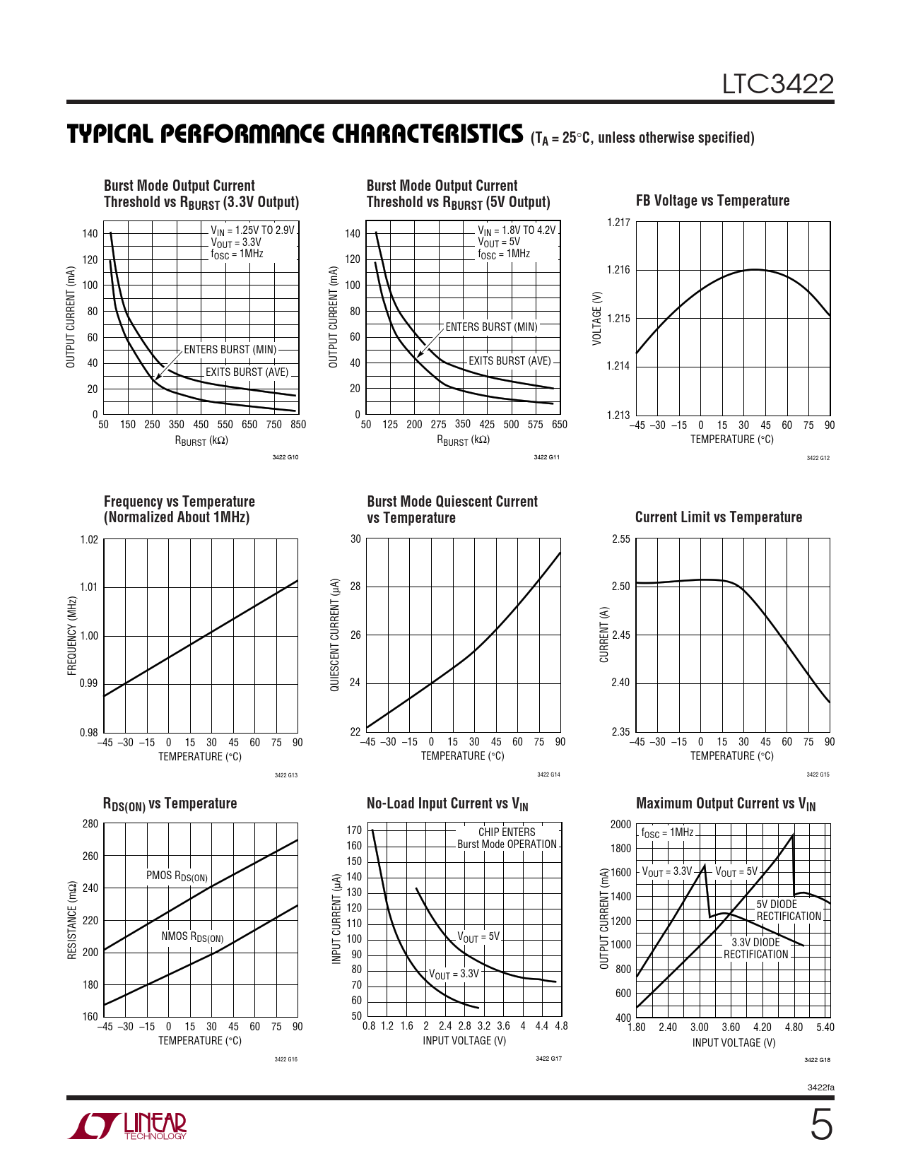

TYPICAL PERFOR A CE CHARACTERISTICS (TA = 25. C, unless otherwise specified). Burst Mode Output Current
TYPICAL PERFOR A CE CHARACTERISTICS (TA = 25 C, unless otherwise specified) Burst Mode Output Current
LTC3422
W U TYPICAL PERFOR A CE CHARACTERISTICS (TA = 25
C, unless otherwise specified) Burst Mode Output Current Burst Mode Output Current Threshold vs RBURST (3.3V Output) Threshold vs R FB Voltage vs Temperature BURST (5V Output)
1.217 140 VIN = 1.25V TO 2.9V 140 VIN = 1.8V TO 4.2V VOUT = 3.3V VOUT = 5V f f 120 OSC = 1MHz 120 OSC = 1MHz 1.216 100 100 80 80 1.215 ENTERS BURST (MIN) 60 60 VOLTAGE (V) ENTERS BURST (MIN) OUTPUT CURRENT (mA) 40 OUTPUT CURRENT (mA) 40 EXITS BURST (AVE) 1.214 EXITS BURST (AVE) 20 20 0 0 1.213 50 150 250 350 450 550 650 750 850 50 125 200 275 350 425 500 575 650 –45 –30 –15 0 15 30 45 60 75 90 RBURST (kΩ) RBURST (kΩ) TEMPERATURE (°C) 3422 G10 3422 G11 3422 G12
Frequency vs Temperature Burst Mode Quiescent Current (Normalized About 1MHz) vs Temperature Current Limit vs Temperature
1.02 30 2.55 1.01 µA) 28 2.50 1.00 26 2.45 CURRENT (A) FREQUENCY (MHz) 0.99 24 2.40 QUIESCENT CURRENT ( 0.98 22 2.35 –45 –30 –15 0 15 30 45 60 75 90 –45 –30 –15 0 15 30 45 60 75 90 –45 –30 –15 0 15 30 45 60 75 90 TEMPERATURE (°C) TEMPERATURE (°C) TEMPERATURE (°C) 3422 G13 3422 G14 3422 G15
RDS(ON) vs Temperature No-Load Input Current vs VIN Maximum Output Current vs VIN
