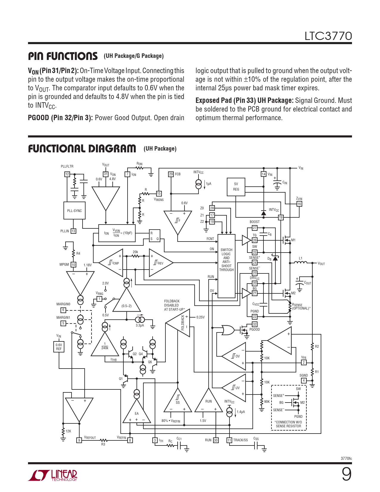

PIN FUNCTIONS (UH Package/G Package). VON (Pin 31/Pin 2):. Exposed Pad (Pin 33) UH Package:. PGOOD (Pin 32/Pin 3):
PIN FUNCTIONS (UH Package/G Package) VON (Pin 31/Pin 2): Exposed Pad (Pin 33) UH Package: PGOOD (Pin 32/Pin 3):
LTC3770
On-Time Voltage Input. Connecting this logic output that is pulled to ground when the output volt- pin to the output voltage makes the on-time proportional age is not within ±10% of the regulation point, after the to VOUT. The comparator input defaults to 0.6V when the internal 25μs power bad mask timer expires. pin is grounded and defaults to 4.8V when the pin is tied
Signal Ground. Must to INTVCC. be soldered to the PCB ground for electrical contact and
Power Good Output. Open drain optimum thermal performance.
FUNCTIONAL DIAGRAM (UH Package)
