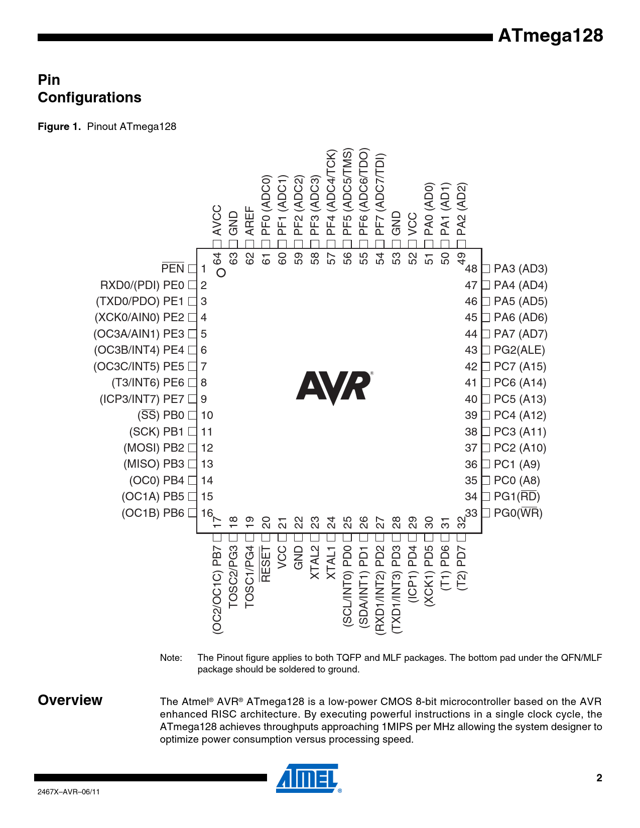

ATmega128. Pin Configurations. Figure 1. Overview
ATmega128 Pin Configurations Figure 1 Overview
ATmega128 Pin Configurations Figure 1.
Pinout ATmega128 CC D D V N N CC A G AREF PF0 (ADC0) PF1 (ADC1) PF2 (ADC2) PF3 (ADC3) PF4 (ADC4/TCK) PF5 (ADC5/TMS) PF6 (ADC6/TDO) PF7 (ADC7/TDI) G V PA0 (AD0) PA1 (AD1) PA2 (AD2) 8 64 63 62 61 60 59 5 57 56 55 54 53 52 51 50 49 PEN 1 48 PA3 (AD3) RXD0/(PDI) PE0 2 47 PA4 (AD4) (TXD0/PDO) PE1 3 46 PA5 (AD5) (XCK0/AIN0) PE2 4 45 PA6 (AD6) (OC3A/AIN1) PE3 5 44 PA7 (AD7) (OC3B/INT4) PE4 6 43 PG2(ALE) (OC3C/INT5) PE5 7 42 PC7 (A15) (T3/INT6) PE6 8 41 PC6 (A14) (ICP3/INT7) PE7 9 40 PC5 (A13) (SS) PB0 10 39 PC4 (A12) (SCK) PB1 11 38 PC3 (A11) (MOSI) PB2 12 37 PC2 (A10) (MISO) PB3 13 36 PC1 (A9) (OC0) PB4 14 35 PC0 (A8) (OC1A) PB5 15 34 PG1(RD) (OC1B) PB6 16 33 PG0(WR) 8 8 17 1 19 20 21 22 23 24 25 26 27 2 29 30 31 32 D CC N V G RESET XTAL2 XTAL1 T0) PD0 T1) PD1 T2) PD2 T3) PD3 N N N N (T1) PD6 (T2) PD7 TOSC2/PG3 TOSC1/PG4 (ICP1) PD4 (XCK1) PD5 (SCL/I (SDA/I (OC2/OC1C) PB7 (RXD1/I (TXD1/I Note: The Pinout figure applies to both TQFP and MLF packages. The bottom pad under the QFN/MLF package should be soldered to ground.
Overview
The Atmel® AVR® ATmega128 is a low-power CMOS 8-bit microcontroller based on the AVR enhanced RISC architecture. By executing powerful instructions in a single clock cycle, the ATmega128 achieves throughputs approaching 1MIPS per MHz allowing the system designer to optimize power consumption versus processing speed.
