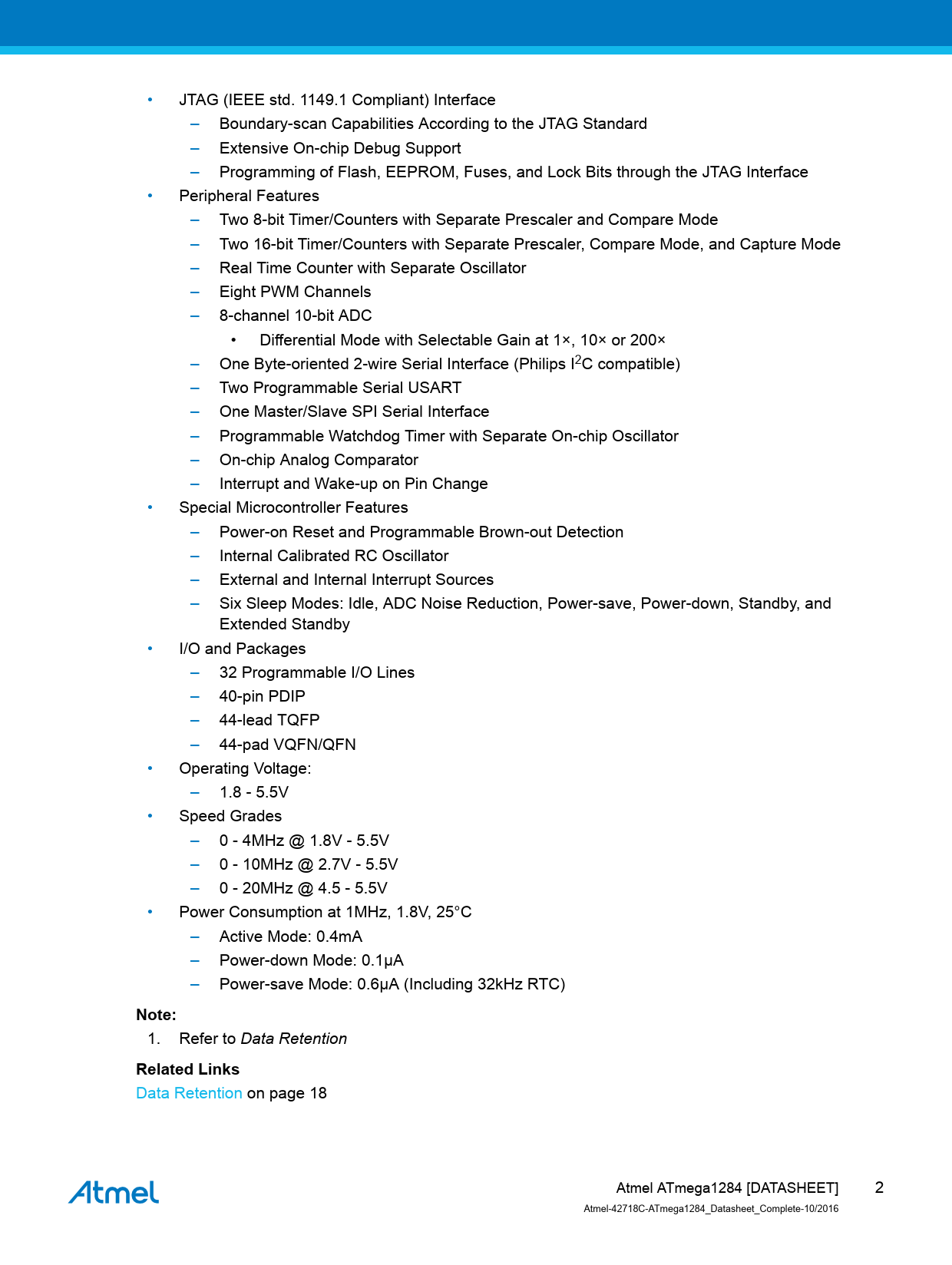

link to page 18 • JTAG (IEEE std. 1149.1 Compliant) Interface – Boundary-scan Capabilities According to the JTAG Standard – Extensive On-chip Debug Support – Programming of Flash, EEPROM, Fuses, and Lock Bits through the JTAG Interface • Peripheral Features – Two 8-bit Timer/Counters with Separate Prescaler and Compare Mode – Two 16-bit Timer/Counters with Separate Prescaler, Compare Mode, and Capture Mode – Real Time Counter with Separate Oscillator – Eight PWM Channels – 8-channel 10-bit ADC • Differential Mode with Selectable Gain at 1×, 10× or 200× – One Byte-oriented 2-wire Serial Interface (Philips I2C compatible) – Two Programmable Serial USART – One Master/Slave SPI Serial Interface – Programmable Watchdog Timer with Separate On-chip Oscillator – On-chip Analog Comparator – Interrupt and Wake-up on Pin Change • Special Microcontroller Features – Power-on Reset and Programmable Brown-out Detection – Internal Calibrated RC Oscillator – External and Internal Interrupt Sources – Six Sleep Modes: Idle, ADC Noise Reduction, Power-save, Power-down, Standby, and Extended Standby • I/O and Packages – 32 Programmable I/O Lines – 40-pin PDIP – 44-lead TQFP – 44-pad VQFN/QFN • Operating Voltage: – 1.8 - 5.5V • Speed Grades – 0 - 4MHz @ 1.8V - 5.5V – 0 - 10MHz @ 2.7V - 5.5V – 0 - 20MHz @ 4.5 - 5.5V • Power Consumption at 1MHz, 1.8V, 25°C – Active Mode: 0.4mA – Power-down Mode: 0.1μA – Power-save Mode: 0.6μA (Including 32kHz RTC)
