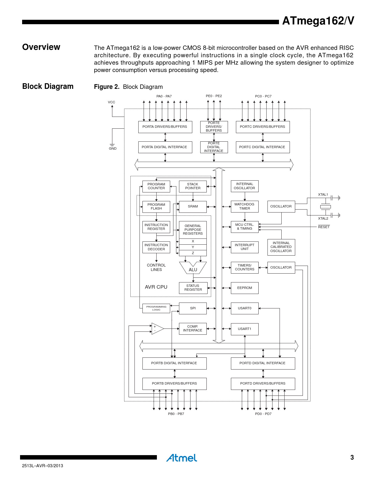

ATmega162/V. Overview. Block Diagram. Figure 2
ATmega162/V Overview Block Diagram Figure 2
The ATmega162 is a low-power CMOS 8-bit microcontroller based on the AVR enhanced RISC architecture. By executing powerful instructions in a single clock cycle, the ATmega162 achieves throughputs approaching 1 MIPS per MHz allowing the system designer to optimize power consumption versus processing speed.
Block Diagram Figure 2.
Block Diagram PA0 - PA7 PE0 - PE2 PC0 - PC7 VCC PORTE PORTA DRIVERS/BUFFERS DRIVERS/ PORTC DRIVERS/BUFFERS BUFFERS PORTE PORTA DIGITAL INTERFACE DIGITAL PORTC DIGITAL INTERFACE GND INTERFACE PROGRAM STACK INTERNAL COUNTER POINTER OSCILLATOR XTAL1 PROGRAM WATCHDOG SRAM OSCILLATOR FLASH TIMER XTAL2 INSTRUCTION MCU CTRL. GENERAL RESET REGISTER & TIMING PURPOSE REGISTERS X INTERNAL INSTRUCTION INTERRUPT Y CALIBRATED DECODER UNIT OSCILLATOR Z CONTROL TIMERS/ OSCILLATOR LINES COUNTERS ALU STATUS AVR CPU EEPROM REGISTER PROGRAMMING SPI USART0 LOGIC + COMP. - INTERFACE USART1 PORTB DIGITAL INTERFACE PORTD DIGITAL INTERFACE PORTB DRIVERS/BUFFERS PORTD DRIVERS/BUFFERS PB0 - PB7 PD0 - PD7
3
