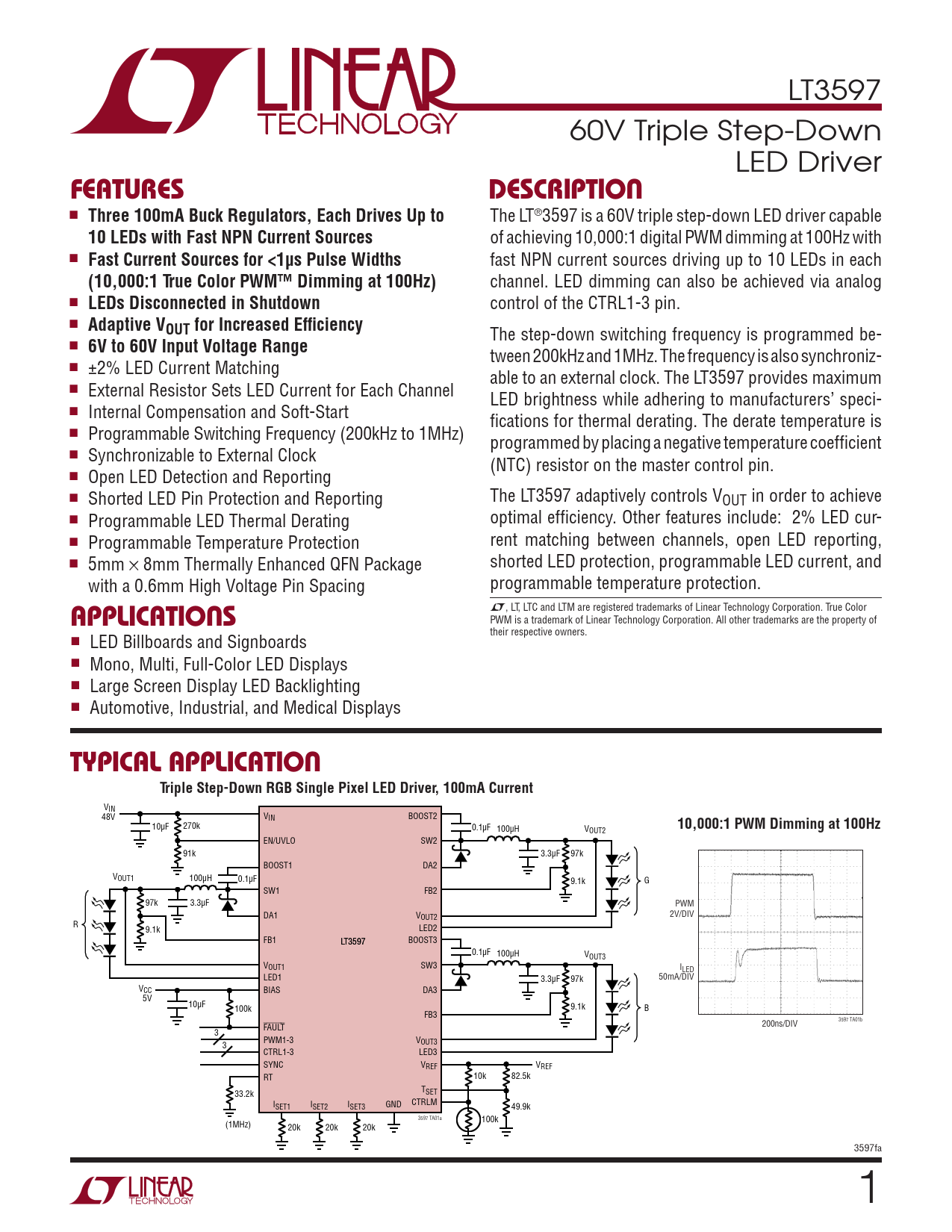

Three 100mA Buck Regulators, Each Drives Up to
The LT®3597 is a 60V triple step-down LED driver capable
10 LEDs with Fast NPN Current Sources
of achieving 10,000:1 digital PWM dimming at 100Hz with n
Fast Current Sources for <1µs Pulse Widths
fast NPN current sources driving up to 10 LEDs in each
(10,000:1 True Color PWM™ Dimming at 100Hz)
channel. LED dimming can also be achieved via analog n
LEDs Disconnected in Shutdown
control of the CTRL1-3 pin. n
Adaptive VOUT for Increased Efficiency
The step-down switching frequency is programmed be- n
6V to 60V Input Voltage Range
tween 200kHz and 1MHz. The frequency is also synchroniz- n ±2% LED Current Matching able to an external clock. The LT3597 provides maximum n External Resistor Sets LED Current for Each Channel LED brightness while adhering to manufacturers’ speci- n Internal Compensation and Soft-Start fications for thermal derating. The derate temperature is n Programmable Switching Frequency (200kHz to 1MHz) programmed by placing a negative temperature coefficient n Synchronizable to External Clock (NTC) resistor on the master control pin. n Open LED Detection and Reporting n Shorted LED Pin Protection and Reporting The LT3597 adaptively controls VOUT in order to achieve n Programmable LED Thermal Derating optimal efficiency. Other features include: 2% LED cur- n Programmable Temperature Protection rent matching between channels, open LED reporting, n 5mm × 8mm Thermally Enhanced QFN Package shorted LED protection, programmable LED current, and with a 0.6mm High Voltage Pin Spacing programmable temperature protection. L, LT, LTC and LTM are registered trademarks of Linear Technology Corporation. True Color

Typical applicaTion Triple Step-Down RGB Single Pixel LED Driver, 100mA Current
VIN 48V VIN BOOST2 10µF 270k 0.1µF 100µH V
10,000:1 PWM Dimming at 100Hz
