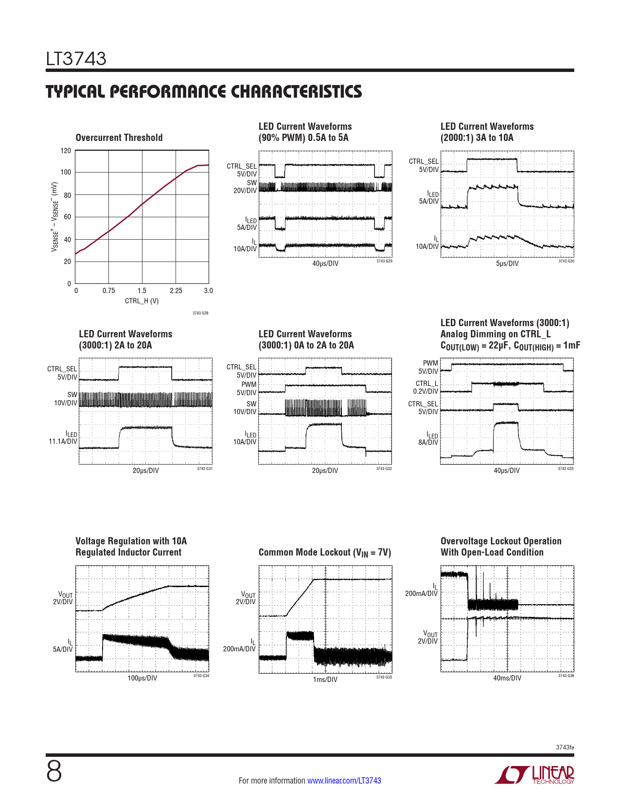

TYPICAL PERFORMANCE CHARACTERISTICS. LED Current Waveforms. Overcurrent Threshold. (90% PWM) 0.5A to 5A. (2000:1) 3A to 10A
LT3743
TYPICAL PERFORMANCE CHARACTERISTICS LED Current Waveforms LED Current Waveforms Overcurrent Threshold (90% PWM) 0.5A to 5A (2000:1) 3A to 10A
120 CTRL_SEL CTRL_SEL 100 5V/DIV 5V/DIV SW 20V/DIV ILED – (mV) 80 5A/DIV SENSE 60 ILED + – V 5A/DIV 40 I I L L V SENSE 10A/DIV 10A/DIV 20 40µs/DIV 3743 G29 5µs/DIV 3743 G30 0 0 0.75 1.5 2.25 3.0 CTRL_H (V) 3743 G28
LED Current Waveforms (3000:1) LED Current Waveforms LED Current Waveforms Analog Dimming on CTRL_L (3000:1) 2A to 20A (3000:1) 0A to 2A to 20A COUT(LOW) = 22µF, COUT(HIGH) = 1mF
CTRL_SEL PWM CTRL_SEL 5V/DIV 5V/DIV 5V/DIV PWM CTRL_L 5V/DIV 0.2V/DIV SW 10V/DIV SW CTRL_SEL 10V/DIV 5V/DIV ILED ILED ILED 11.1A/DIV 10A/DIV 8A/DIV 20µs/DIV 3743 G31 20µs/DIV 3743 G32 40µs/DIV 3743 G33
Voltage Regulation with 10A Overvoltage Lockout Operation Regulated Inductor Current Common Mode Lockout (VIN = 7V) With Open-Load Condition
