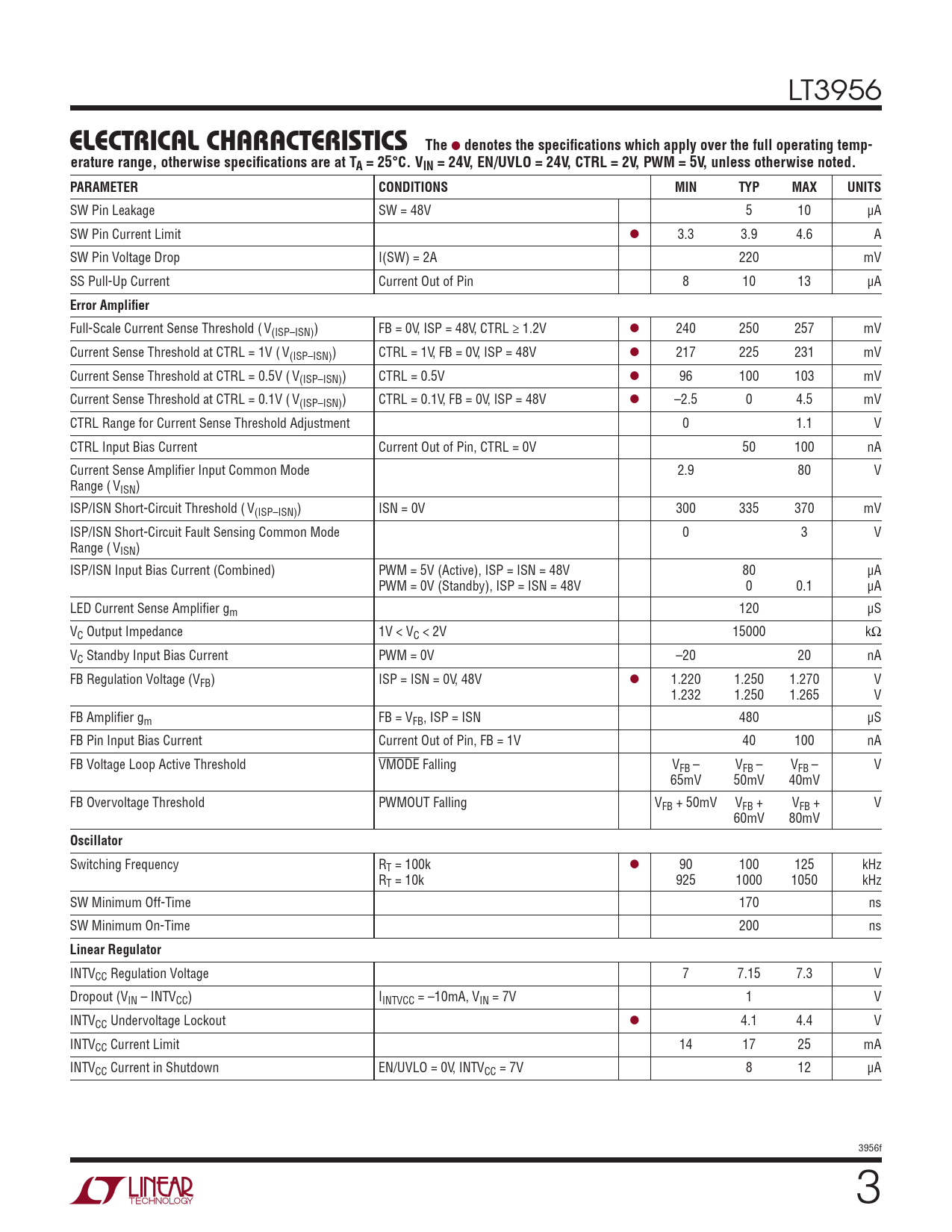

The. denotes the specifications which apply over the full operating temp-
LT3956 e lecTrical characTerisTics
The
l
denotes the specifications which apply over the full operating temp- erature range, otherwise specifications are at TA = 25°C. VIN = 24V, EN/UVLO = 24V, CTRL = 2V, PWM = 5V, unless otherwise noted. PARAMETER CONDITIONS MIN TYP MAX UNITS
SW Pin Leakage SW = 48V 5 10 µA SW Pin Current Limit l 3.3 3.9 4.6 A SW Pin Voltage Drop I(SW) = 2A 220 mV SS Pull-Up Current Current Out of Pin 8 10 13 µA
Error Amplifier
Full-Scale Current Sense Threshold ( V(ISP–ISN)) FB = 0V, ISP = 48V, CTRL ≥ 1.2V l 240 250 257 mV Current Sense Threshold at CTRL = 1V ( V(ISP–ISN)) CTRL = 1V, FB = 0V, ISP = 48V l 217 225 231 mV Current Sense Threshold at CTRL = 0.5V ( V(ISP–ISN)) CTRL = 0.5V l 96 100 103 mV Current Sense Threshold at CTRL = 0.1V ( V(ISP–ISN)) CTRL = 0.1V, FB = 0V, ISP = 48V l –2.5 0 4.5 mV CTRL Range for Current Sense Threshold Adjustment 0 1.1 V CTRL Input Bias Current Current Out of Pin, CTRL = 0V 50 100 nA Current Sense Amplifier Input Common Mode 2.9 80 V Range ( VISN) ISP/ISN Short-Circuit Threshold ( V(ISP–ISN)) ISN = 0V 300 335 370 mV ISP/ISN Short-Circuit Fault Sensing Common Mode 0 3 V Range ( VISN) ISP/ISN Input Bias Current (Combined) PWM = 5V (Active), ISP = ISN = 48V 80 µA PWM = 0V (Standby), ISP = ISN = 48V 0 0.1 µA LED Current Sense Amplifier gm 120 µS VC Output Impedance 1V < VC < 2V 15000 kΩ VC Standby Input Bias Current PWM = 0V –20 20 nA FB Regulation Voltage (VFB) ISP = ISN = 0V, 48V l 1.220 1.250 1.270 V 1.232 1.250 1.265 V FB Amplifier gm FB = VFB, ISP = ISN 480 µS FB Pin Input Bias Current Current Out of Pin, FB = 1V 40 100 nA FB Voltage Loop Active Threshold VMODE Falling VFB – VFB – VFB – V 65mV 50mV 40mV FB Overvoltage Threshold PWMOUT Falling VFB + 50mV VFB + VFB + V 60mV 80mV
Oscillator
Switching Frequency RT = 100k l 90 100 125 kHz RT = 10k 925 1000 1050 kHz SW Minimum Off-Time 170 ns SW Minimum On-Time 200 ns
