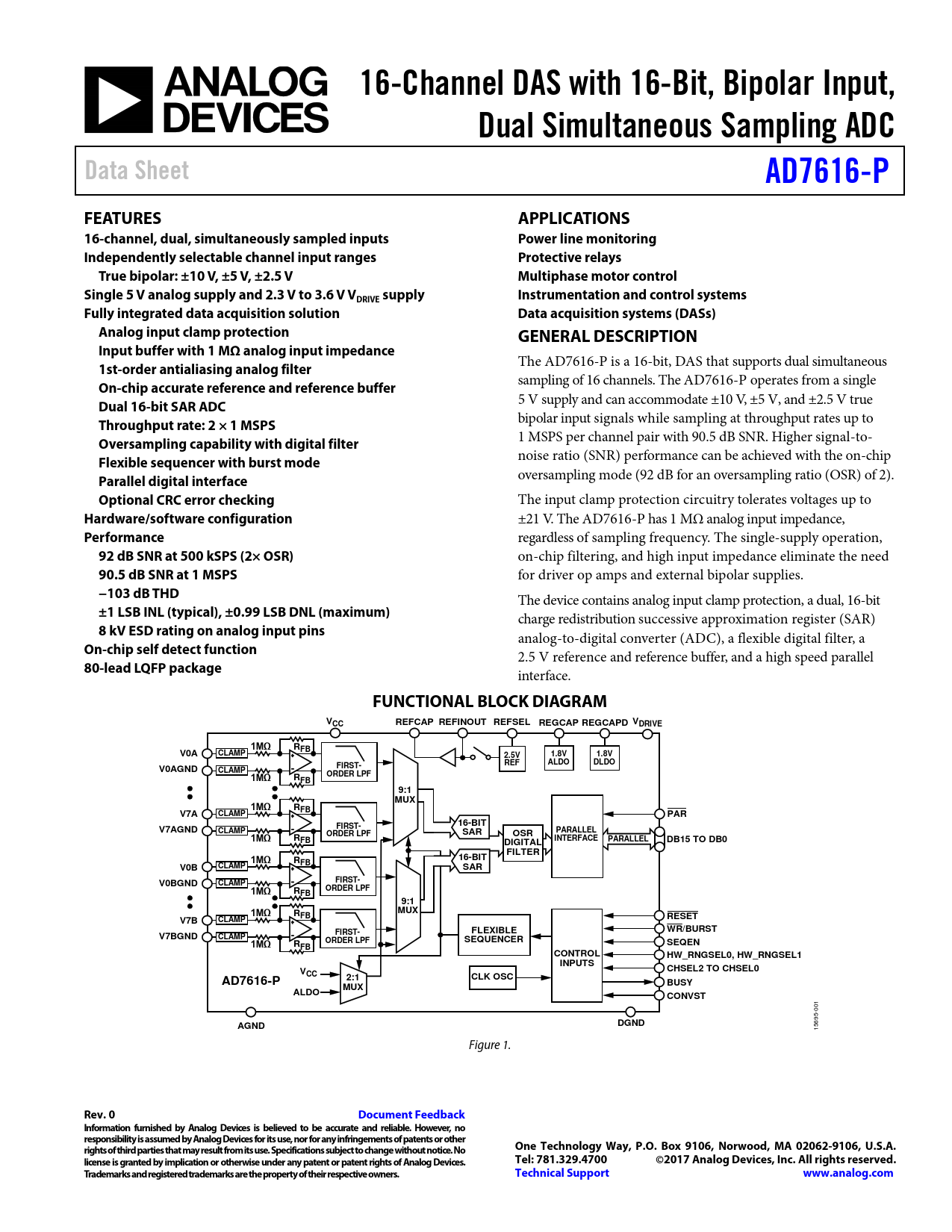

16-Channel DAS with 16-Bit, Bipolar Input,. Dual Simultaneous Sampling ADC. Data Sheet. AD7616-P. FEATURES. APPLICATIONS
16-Channel DAS with 16-Bit, Bipolar Input, Dual Simultaneous Sampling ADC Data Sheet AD7616-P FEATURES APPLICATIONS 16-channel, dual, simultaneously sampled inputs Power line monitoring Independently selectable channel input ranges Protective relays True bipolar: ±10 V, ±5 V, ±2.5 V Multiphase motor control Single 5 V analog supply and 2.3 V to 3.6 V V supply Instrumentation and control systems DRIVE Fully integrated data acquisition solution Data acquisition systems (DASs) Analog input clamp protection GENERAL DESCRIPTION Input buffer with 1 MΩ analog input impedance 1st-order antialiasing analog filter
The AD7616-P is a 16-bit, DAS that supports dual simultaneous
On-chip accurate reference and reference buffer
sampling of 16 channels. The AD7616-P operates from a single
Dual 16-bit SAR ADC
5 V supply and can accommodate ±10 V, ±5 V, and ±2.5 V true
Throughput rate: 2 × 1 MSPS
bipolar input signals while sampling at throughput rates up to
Oversampling capability with digital filter
1 MSPS per channel pair with 90.5 dB SNR. Higher signal-to-
Flexible sequencer with burst mode
noise ratio (SNR) performance can be achieved with the on-chip
Parallel digital interface
oversampling mode (92 dB for an oversampling ratio (OSR) of 2).
Optional CRC error checking
The input clamp protection circuitry tolerates voltages up to
Hardware/software configuration
±21 V. The AD7616-P has 1 MΩ analog input impedance,
Performance
regardless of sampling frequency. The single-supply operation,
92 dB SNR at 500 kSPS (2× OSR)
on-chip filtering, and high input impedance eliminate the need
90.5 dB SNR at 1 MSPS
for driver op amps and external bipolar supplies.
−103 dB THD
The device contains analog input clamp protection, a dual, 16-bit
±1 LSB INL (typical), ±0.99 LSB DNL (maximum)
charge redistribution successive approximation register (SAR)
8 kV ESD rating on analog input pins
analog-to-digital converter (ADC), a flexible digital filter, a
On-chip self detect function
2.5 V reference and reference buffer, and a high speed paral el
80-lead LQFP package
interface.
FUNCTIONAL BLOCK DIAGRAM VCC REFCAP REFINOUT REFSEL REGCAP REGCAPD VDRIVE 1MΩ R V0A CLAMP FB 2.5V 1.8V 1.8V REF ALDO DLDO FIRST- V0AGND CLAMP ORDER LPF 1MΩ RFB 9:1 MUX 1MΩ R V7A CLAMP FB PAR 16-BIT FIRST- V7AGND CLAMP PARALLEL ORDER LPF SAR OSR 1MΩ R INTERFACE FB DIGITAL PARALLEL DB15 TO DB0 FILTER 16-BIT 1MΩ RFB V0B CLAMP SAR FIRST- V0BGND CLAMP ORDER LPF 1MΩ RFB 9:1 MUX 1MΩ RFB RESET V7B CLAMP FIRST- FLEXIBLE WR/BURST V7BGND CLAMP ORDER LPF SEQUENCER SEQEN 1MΩ RFB CONTROL HW_RNGSEL0, HW_RNGSEL1 INPUTS CHSEL2 TO CHSEL0 VCC 2:1 CLK OSC AD7616-P BUSY MUX ALDO CONVST
001
AGND DGND
15695- Figure 1.
