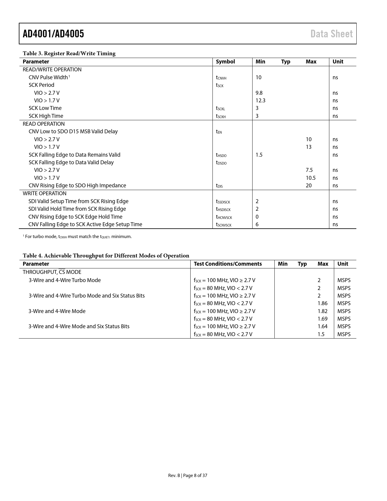

AD4001/AD4005. Data Sheet. Table 3. Register Read/Write Timing Parameter. Symbol. Min. Typ. Max. Unit
AD4001/AD4005 Data Sheet Table 3. Register Read/Write Timing Parameter Symbol Min Typ Max Unit
READ/WRITE OPERATION CNV Pulse Width1 tCNVH 10 ns SCK Period tSCK VIO > 2.7 V 9.8 ns VIO > 1.7 V 12.3 ns SCK Low Time tSCKL 3 ns SCK High Time tSCKH 3 ns READ OPERATION CNV Low to SDO D15 MSB Valid Delay tEN VIO > 2.7 V 10 ns VIO > 1.7 V 13 ns SCK Falling Edge to Data Remains Valid tHSDO 1.5 ns SCK Falling Edge to Data Valid Delay tDSDO VIO > 2.7 V 7.5 ns VIO > 1.7 V 10.5 ns CNV Rising Edge to SDO High Impedance tDIS 20 ns WRITE OPERATION SDI Valid Setup Time from SCK Rising Edge tSSDISCK 2 ns SDI Valid Hold Time from SCK Rising Edge tHSDISCK 2 ns CNV Rising Edge to SCK Edge Hold Time tHCNVSCK 0 ns CNV Falling Edge to SCK Active Edge Setup Time tSCNVSCK 6 ns 1 For turbo mode, tCNVH must match the tQUIET1 minimum.
Table 4. Achievable Throughput for Different Modes of Operation Parameter Test Conditions/Comments Min Typ Max Unit
THROUGHPUT, CS MODE 3-Wire and 4-Wire Turbo Mode fSCK = 100 MHz, VIO ≥ 2.7 V 2 MSPS fSCK = 80 MHz, VIO < 2.7 V 2 MSPS 3-Wire and 4-Wire Turbo Mode and Six Status Bits fSCK = 100 MHz, VIO ≥ 2.7 V 2 MSPS fSCK = 80 MHz, VIO < 2.7 V 1.86 MSPS 3-Wire and 4-Wire Mode fSCK = 100 MHz, VIO ≥ 2.7 V 1.82 MSPS fSCK = 80 MHz, VIO < 2.7 V 1.69 MSPS 3-Wire and 4-Wire Mode and Six Status Bits fSCK = 100 MHz, VIO ≥ 2.7 V 1.64 MSPS fSCK = 80 MHz, VIO < 2.7 V 1.5 MSPS Rev. B | Page 8 of 37 Document Outline Features Applications General Description Functional Block Diagram Table of Contents Revision History Specifications Timing Specifications Absolute Maximum Ratings Thermal Resistance ESD Caution Pin Configurations and Function Descriptions Typical Performance Characteristics Terminology Theory of Operation Circuit Information Converter Operation Transfer Functions Applications Information Typical Application Diagrams Analog Inputs Input Overvoltage Clamp Circuit Differential Input Considerations Switched Capacitor Input RC Filter Values Driver Amplifier Choice Single to Differential Driver High Frequency Input Signals Multiplexed Applications Ease of Drive Features Input Span Compression High-Z Mode Long Acquisition Phase Voltage Reference Input Power Supply Digital Interface Register Read/Write Functionality Status Word /CS Mode, 3-Wire Turbo Mode /CS Mode, 3-Wire Without Busy Indicator /CS Mode, 3-Wire with Busy Indicator /CS Mode, 4-Wire Turbo Mode /CS Mode, 4-Wire Without Busy Indicator /CS Mode, 4-Wire with Busy Indicator Daisy-Chain Mode Layout Guidelines Evaluating the AD4001/AD4005 Performance Outline Dimensions Ordering Guide
