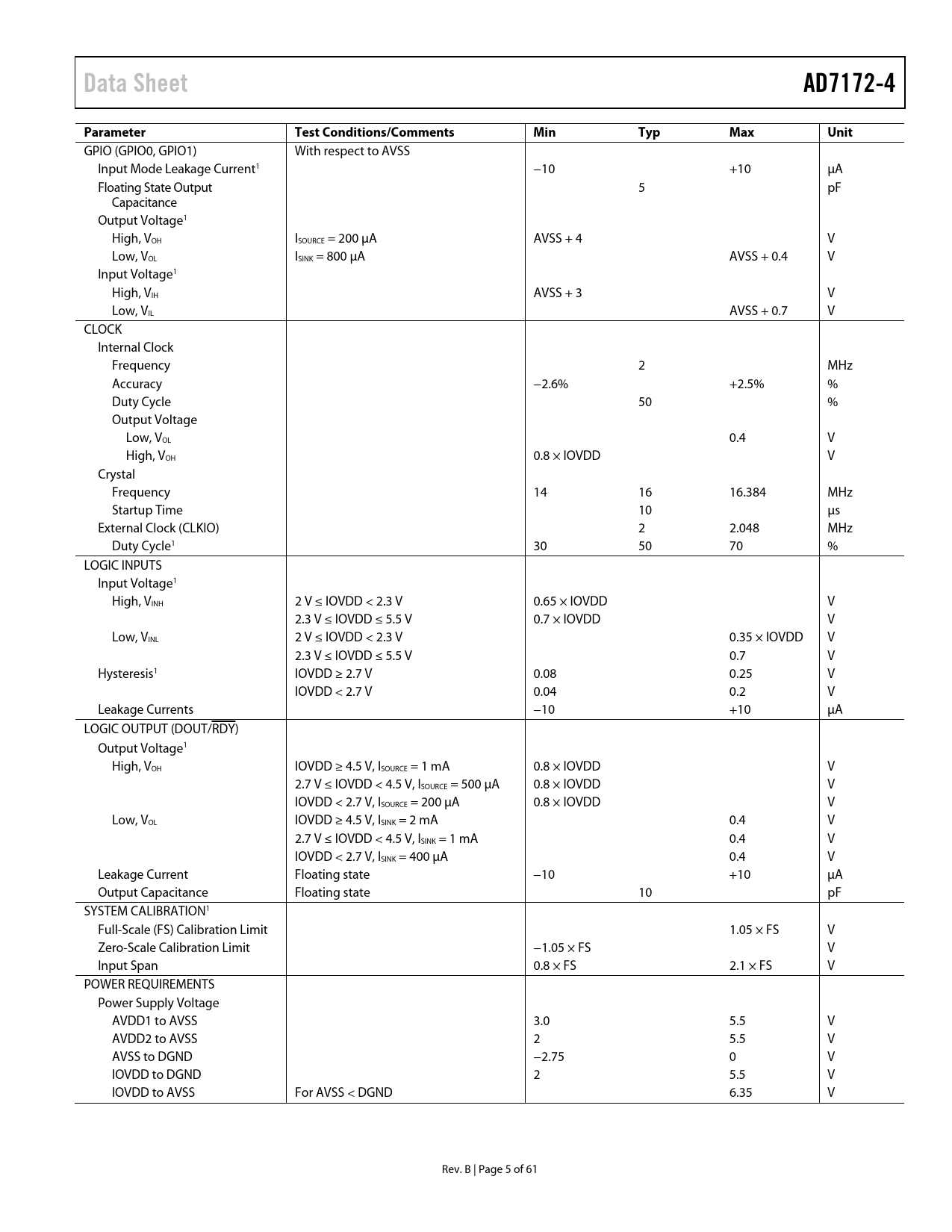

Data Sheet. AD7172-4. Parameter. Test Conditions/Comments. Min. Typ. Max. Unit
link to page 7 link to page 7 link to page 7 link to page 7 link to page 7 link to page 7
Data Sheet AD7172-4 Parameter Test Conditions/Comments Min Typ Max Unit
GPIO (GPIO0, GPIO1) With respect to AVSS Input Mode Leakage Current1 −10 +10 μA Floating State Output 5 pF Capacitance Output Voltage1 High, VOH ISOURCE = 200 μA AVSS + 4 V Low, VOL ISINK = 800 μA AVSS + 0.4 V Input Voltage1 High, VIH AVSS + 3 V Low, VIL AVSS + 0.7 V CLOCK Internal Clock Frequency 2 MHz Accuracy −2.6% +2.5% % Duty Cycle 50 % Output Voltage Low, VOL 0.4 V High, VOH 0.8 × IOVDD V Crystal Frequency 14 16 16.384 MHz Startup Time 10 μs External Clock (CLKIO) 2 2.048 MHz Duty Cycle1 30 50 70 % LOGIC INPUTS Input Voltage1 High, VINH 2 V ≤ IOVDD < 2.3 V 0.65 × IOVDD V 2.3 V ≤ IOVDD ≤ 5.5 V 0.7 × IOVDD V Low, VINL 2 V ≤ IOVDD < 2.3 V 0.35 × IOVDD V 2.3 V ≤ IOVDD ≤ 5.5 V 0.7 V Hysteresis1 IOVDD ≥ 2.7 V 0.08 0.25 V IOVDD < 2.7 V 0.04 0.2 V Leakage Currents −10 +10 μA LOGIC OUTPUT (DOUT/RDY) Output Voltage1 High, VOH IOVDD ≥ 4.5 V, ISOURCE = 1 mA 0.8 × IOVDD V 2.7 V ≤ IOVDD < 4.5 V, ISOURCE = 500 μA 0.8 × IOVDD V IOVDD < 2.7 V, ISOURCE = 200 μA 0.8 × IOVDD V Low, VOL IOVDD ≥ 4.5 V, ISINK = 2 mA 0.4 V 2.7 V ≤ IOVDD < 4.5 V, ISINK = 1 mA 0.4 V IOVDD < 2.7 V, ISINK = 400 μA 0.4 V Leakage Current Floating state −10 +10 μA Output Capacitance Floating state 10 pF SYSTEM CALIBRATION1 Full-Scale (FS) Calibration Limit 1.05 × FS V Zero-Scale Calibration Limit −1.05 × FS V Input Span 0.8 × FS 2.1 × FS V POWER REQUIREMENTS Power Supply Voltage AVDD1 to AVSS 3.0 5.5 V AVDD2 to AVSS 2 5.5 V AVSS to DGND −2.75 0 V IOVDD to DGND 2 5.5 V IOVDD to AVSS For AVSS < DGND 6.35 V Rev. B | Page 5 of 61 Document Outline FEATURES APPLICATIONS GENERAL DESCRIPTION FUNCTIONAL BLOCK DIAGRAM TABLE OF CONTENTS REVISION HISTORY SPECIFICATIONS TIMING CHARACTERISTICS TIMING DIAGRAMS ABSOLUTE MAXIMUM RATINGS THERMAL RESISTANCE ESD CAUTION PIN CONFIGURATION AND FUNCTION DESCRIPTIONS TYPICAL PERFORMANCE CHARACTERISTICS NOISE PERFORMANCE AND RESOLUTION GETTING STARTED POWER SUPPLIES Recommended Linear Regulators DIGITAL COMMUNICATION Accessing the ADC Register Map AD7172-4 RESET CONFIGURATION OVERVIEW Channel Configuration Channel Registers ADC Setups Setup Configuration Registers Filter Configuration Registers Gain Registers Offset Registers ADC Mode and Interface Mode Configuration ADC Mode Register Interface Mode Register Understanding Configuration Flexibility CIRCUIT DESCRIPTION BUFFERED ANALOG INPUT CROSSPOINT MULTIPLEXER Fully Differential Inputs Single-Ended Inputs AD7172-4 REFERENCE BUFFERED REFERENCE INPUT CLOCK SOURCE Internal Oscillator External Crystal External Clock DIGITAL FILTERS SINC5 + SINC1 FILTER SINC3 FILTER SINGLE CYCLE SETTLING ENHANCED 50 Hz AND 60 Hz REJECTION FILTERS OPERATING MODES CONTINUOUS CONVERSION MODE CONTINUOUS READ MODE SINGLE CONVERSION MODE STANDBY AND POWER-DOWN MODES CALIBRATION DIGITAL INTERFACE CHECKSUM PROTECTION CRC CALCULATION Polynomial Example of a Polynomial CRC Calculation—24-Bit Word: 0x654321 (8-Bit Command and 16-Bit Data) XOR Calculation Example of an XOR Calculation—24-Bit Word: 0x654321 (8-Bit Command and 16-Bit Data) INTEGRATED FUNCTIONS GENERAL-PURPOSE INPUT/OUTPUT EXTERNAL MULTIPLEXER CONTROL DELAY 16-BIT/24-BIT CONVERSIONS DOUT_RESET SYNCHRONIZATION Normal Synchronization Alternate Synchronization ERROR FLAGS ADC_ERROR CRC_ERROR REG_ERROR Input/Output DATA_STAT IOSTRENGTH GROUNDING AND LAYOUT REGISTER SUMMARY REGISTER DETAILS COMMUNICATIONS REGISTER STATUS REGISTER ADC MODE REGISTER INTERFACE MODE REGISTER REGISTER CHECK DATA REGISTER GPIO CONFIGURATION REGISTER ID REGISTER CHANNEL REGISTER 0 CHANNEL REGISTER 1 TO CHANNEL REGISTER 7 SETUP CONFIGURATION REGISTER 0 SETUP CONFIGURATION REGISTER 1 TO SETUP CONFIGURATION REGISTER 7 FILTER CONFIGURATION REGISTER 0 FILTER CONFIGURATION REGISTER 1 TO FILTER CONFIGURATION REGISTER 7 OFFSET REGISTER 0 OFFSET REGISTER 1 TO OFFSET REGISTER 7 GAIN REGISTER 0 GAIN REGISTER 1 TO GAIN REGISTER 7 OUTLINE DIMENSIONS ORDERING GUIDE
