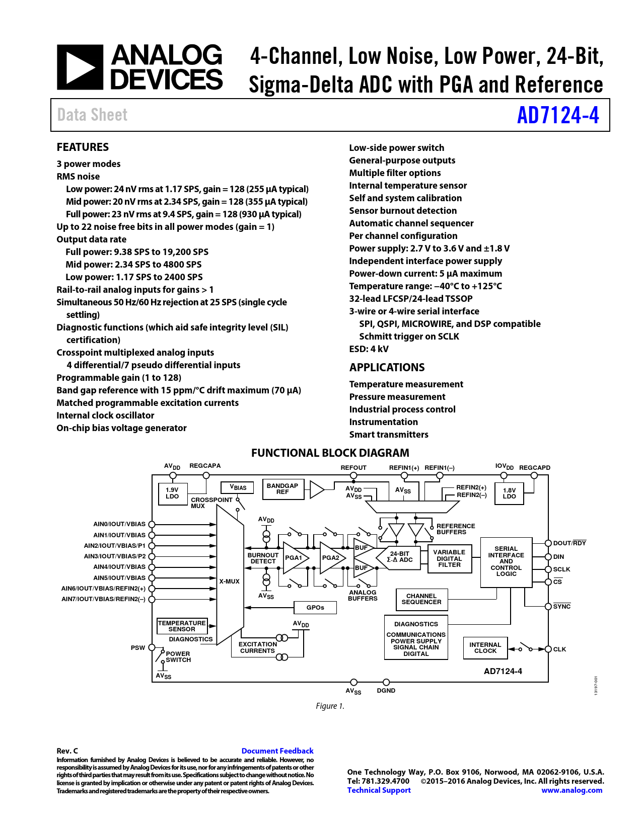

4-Channel, Low Noise, Low Power, 24-Bit,. Sigma-Delta ADC with PGA and Reference. Data Sheet. AD7124-4. FEATURES
4-Channel, Low Noise, Low Power, 24-Bit, Sigma-Delta ADC with PGA and Reference Data Sheet AD7124-4 FEATURES Low-side power switch 3 power modes General-purpose outputs RMS noise Multiple filter options Low power: 24 nV rms at 1.17 SPS, gain = 128 (255 µA typical) Internal temperature sensor Mid power: 20 nV rms at 2.34 SPS, gain = 128 (355 µA typical) Self and system calibration Full power: 23 nV rms at 9.4 SPS, gain = 128 (930 µA typical) Sensor burnout detection Up to 22 noise free bits in all power modes (gain = 1) Automatic channel sequencer Output data rate Per channel configuration Full power: 9.38 SPS to 19,200 SPS Power supply: 2.7 V to 3.6 V and ±1.8 V Mid power: 2.34 SPS to 4800 SPS Independent interface power supply Low power: 1.17 SPS to 2400 SPS Power-down current: 5 µA maximum Rail-to-rail analog inputs for gains > 1 Temperature range: −40°C to +125°C Simultaneous 50 Hz/60 Hz rejection at 25 SPS (single cycle 32-lead LFCSP/24-lead TSSOP settling) 3-wire or 4-wire serial interface Diagnostic functions (which aid safe integrity level (SIL) SPI, QSPI, MICROWIRE, and DSP compatible certification) Schmitt trigger on SCLK Crosspoint multiplexed analog inputs ESD: 4 kV 4 differential/7 pseudo differential inputs APPLICATIONS Programmable gain (1 to 128) Temperature measurement Band gap reference with 15 ppm/°C drift maximum (70 µA) Pressure measurement Matched programmable excitation currents Industrial process control Internal clock oscillator Instrumentation On-chip bias voltage generator Smart transmitters FUNCTIONAL BLOCK DIAGRAM AV REGCAPA IOV DD REFOUT REFIN1(+) REFIN1(–) DD REGCAPD V BANDGAP BIAS REFIN2(+) 1.9V AV REF DD AVSS 1.8V AV REFIN2(–) LDO LDO CROSSPOINT SS MUX AVDD AIN0/IOUT/VBIAS REFERENCE BUFFERS AIN1/IOUT/VBIAS DOUT/RDY AIN2/IOUT/VBIAS/P1 BUF SERIAL 24-BIT VARIABLE BURNOUT INTERFACE AIN3/IOUT/VBIAS/P2 PGA1 PGA2 DIN DETECT Σ-Δ ADC DIGITAL AND FILTER AIN4/IOUT/VBIAS BUF CONTROL SCLK LOGIC AIN5/IOUT/VBIAS X-MUX CS AIN6/IOUT/VBIAS/REFIN2(+) ANALOG AVSS CHANNEL AIN7/IOUT/VBIAS/REFIN2(–) BUFFERS SEQUENCER GPOs SYNC TEMPERATURE AVDD DIAGNOSTICS SENSOR COMMUNICATIONS DIAGNOSTICS POWER SUPPLY EXCITATION INTERNAL PSW SIGNAL CHAIN CURRENTS CLOCK CLK POWER DIGITAL SWITCH AD7124-4 AVSS
