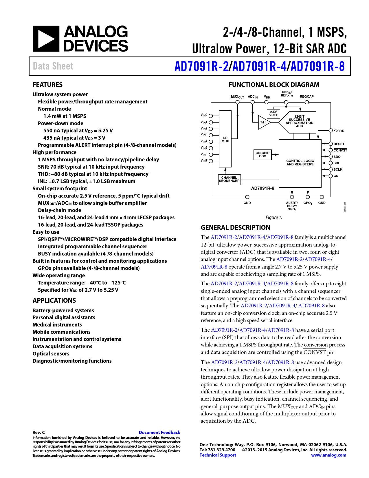

2-/4-/8-Channel, 1 MSPS,. Ultralow Power, 12-Bit SAR ADC. Data Sheet. AD7091R-2. /AD7091R-4. /AD7091R-8. FEATURES
2-/4-/8-Channel, 1 MSPS, Ultralow Power, 12-Bit SAR ADC Data Sheet AD7091R-2 /AD7091R-4 /AD7091R-8 FEATURES FUNCTIONAL BLOCK DIAGRAM Ultralow system power REFIN/ V REFOUT MUX REGCAP OUT ADCIN DD Flexible power/throughput rate management Normal mode 2.5V 1.4 mW at 1 MSPS VIN0 VREF 12-BIT SUCCESSIVE Power-down mode VIN1 T/H APPROXIMATION ADC 550 nA typical at V VIN2 DD = 5.25 V VDRIVE V 435 nA typical at V IN3 DD = 3 V I/P V MUX Programmable ALERT interrupt pin (4-/8-channel models) IN4 RESET VIN5 High performance CONVST ON-CHIP VIN6 OSC 1 MSPS throughput with no latency/pipeline delay SDO VIN7 CONTROL LOGIC SDI SNR: 70 dB typical at 10 kHz input frequency AND REGISTERS SCLK THD: −80 dB typical at 10 kHz input frequency CS CHANNEL INL: ±0.7 LSB typical, ±1.0 LSB maximum SEQUENCER Small system footprint AD7091R-8 On-chip accurate 2.5 V reference, 5 ppm/°C typical drift MUXOUT/ADCIN to allow single buffer amplifier GND ALERT/ GPO GND 1 BUSY/

16-lead, 20-lead, and 24-lead TSSOP packages GENERAL DESCRIPTION Easy to use SPI/QSPI™/MICROWIRE™/DSP compatible digital interface
The AD7091R-2/AD7091R-4/AD7091R-8 family is a multichannel
Integrated programmable channel sequencer
12-bit, ultralow power, successive approximation analog-to-
BUSY indication available (4-/8-channel models)
digital converter (ADC) that is available in two, four, or eight
Built in features for control and monitoring applications
analog input channel options. The AD7091R-2/AD7091R-4/
GPOx pins available (4-/8-channel models)
AD7091R-8 operate from a single 2.7 V to 5.25 V power supply
Wide operating range
and are capable of achieving a sampling rate of 1 MSPS.
Temperature range: −40°C to +125°C
The AD7091R-2/AD7091R-4/AD7091R-8 family offers up to eight
Specified for VDD of 2.7 V to 5.25 V
single-ended analog input channels with a channel sequencer
APPLICATIONS
that al ows a preprogrammed selection of channels to be converted sequentially. The AD7091R-2/AD7091R-4/ AD7091R-8 also
Battery-powered systems
feature an on-chip conversion clock, an on-chip accurate 2.5 V
Personal digital assistants
reference, and a high speed serial interface.
Medical instruments Mobile communications
The AD7091R-2/AD7091R-4/AD7091R-8 have a serial port
Instrumentation and control systems
interface (SPI) that allows data to be read after the conversion
Data acquisition systems
while achieving a 1 MSPS throughput rate. The conversion process
Optical sensors
and data acquisition are controlled using the CONVST pin.
Diagnostic/monitoring functions
The AD7091R-2/AD7091R-4/AD7091R-8 use advanced design techniques to achieve ultralow power dissipation at high throughput rates. They also feature flexible power management options. An on-chip configuration register allows the user to set up different operating conditions. These include power management, alert functionality, busy indication, channel sequencing, and general-purpose output pins. The MUXOUT and ADCIN pins allow signal conditioning of the multiplexer output prior to acquisition by the ADC.
